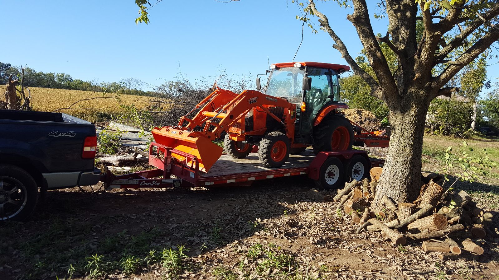

I have an L48 TLB, and it fits on a 20' trailer, ...... with proper weight distribution.
That said: I would have much preferred a 22' trailer, but needed to conserve indoor trailer storage space.
I cannot carry any additional items on the trailer.

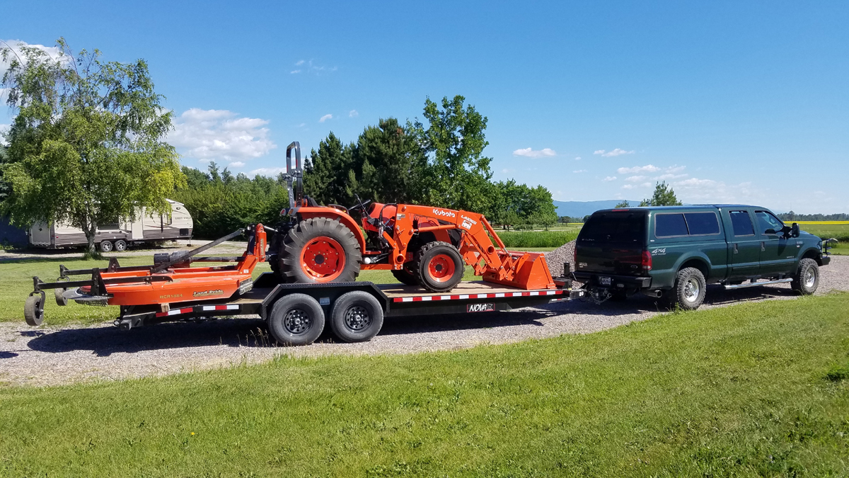

I have a 22' trailer and the MX with a 7ft cutter (RCR1884) doesn't fit great. The L4060 is similar in size and a 6ft cutter would obviously be about 1ft shorter at the back.
It'll be a lot better with the Del Morino Centurion Super 158 that will be here this week. I'll be using the flail mower at my friend's place this year and will take a photo of the MX and flail on the same trailer for reference. I'll be able to keep the ramps on the trailer with that setup.

From the look of that tongue weight, you would likely benefit from "Air Lift" (easy install) suspension.
I added that very simple system to my 454 V8, K2500 4x4 Suburban, and it made for a much better highway towing experience.
I also used an Equal-i-zer 14K hitch.
My towed load (L48 TLB+trailer) was 12K+ on a 14K rated 20' trailer.
I recently sold the Suburban, but kept the TLB, trailer, and Equal-i-zer -$800- hitch.

Any/ALL 'overhang' here in Ontario HAS to be flagged lest yea get a BIG fine.......DTWT
I flagged the rotary cutter with a couple of wheels. 😂 If only the tires were Kubota orange.

Last year I ended up buying a Curt load leveling hitch that I'll be using when I tow the M6060 almost 600 miles in a couple of weeks.

I am aware of the Curt hitches, but did a bit of research ( 7 years ago ), and concluded that the Equal-i-zer was the better one for me (14K).
Proper setting of your electric trailer brakes is important as well, though I see that you have a trailer RV already.
If the CURT you have, is for the RV trailer, it would likely not be properly sized for your tractor/trailer weight.

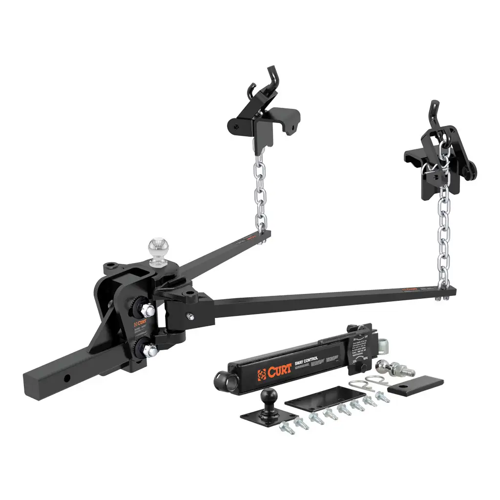

That's not my travel trailer. It belongs to the friend whose fields I cut. I bought one of the 15k weight distribution kits since my trailer is rated around that weight too. This is the one I bought.
The receiver on the trailer is height adjustable and I recently dropped it to the bottom of the coupler to raise the front of the trailer up a bit. I hope I have an uneventful trip in a couple of weeks. There are some big mountains to climb regardless of the route I take from Sheridan, WY.

I think that backing up can be an issue with that hanging chain type hitch.
That is why I opted for the Equal-i-zer hitch (with bars) instead.

I don't need to back up at my place or my friend's, but if I find myself in a situation where I need to back up and the weight distribution is a problem, it'll take 30 seconds to get out of the truck and disconnect the chains, and another 30 seconds to reconnect them once I'm ready to take off.
Not a problem unless someone is shooting at me! :LOL:
