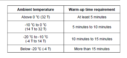

From my BX manual. Seems I am not far off the mark, for winter use....I might be a little bit agressive for the summer. Although I am sure it's correct for some situations and tractors, there's no way in HE-double-hockey-sticks I have the patience to wait >30minutes as someone else posted.
I've owned a couple older VW diesels (apples/oranges) and grew very impatient waiting for the thing to blow heat in the dead of winter. Best idea I ever had was a coolant heater on a timer. I'd come out at 7am, windshield would be thawed out in most cases and I had a small amount of heat once I started driving.
I know it's different, but a block heater is not a bad thing at all.

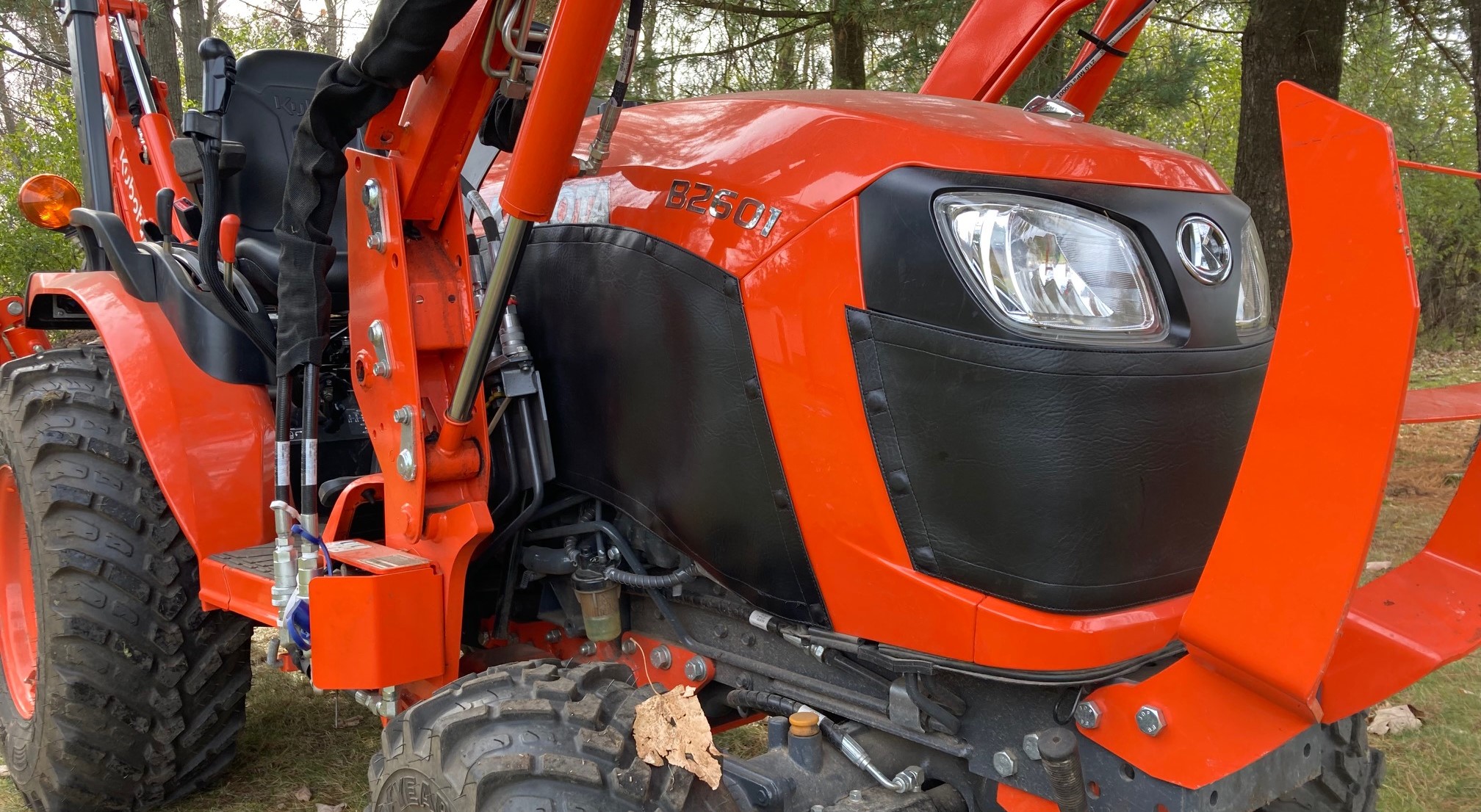

Thanks for the reminder, Kevin. I had sent @top gnome a link to the covers that would fit his tractor in a "conversation" but got no response back. Being a new member, he might not have seen the message. Here's the link to the covers that will fit the B2601 and thus the B2301: B2301 Winter Front Covers
There's more pics on that post. But here's a teaser on the '01 series
@top gnome If interested in a set of covers, I'd be happy to get a set to you. Let me know. You should see a message from me....select the envelope in the top right corner of the page.
