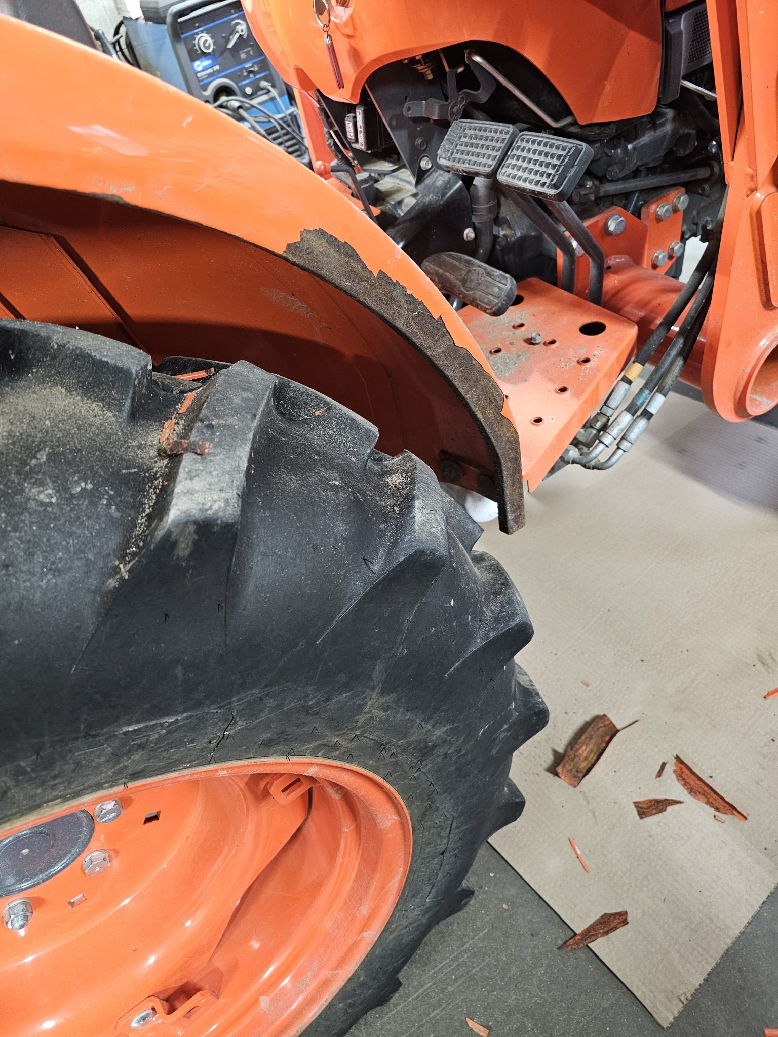

Here's a couple pics of the flakes I popped off with my fingers. Time to get it fixed.
I called a local place today that does sandblasting. He said they'll be starting up sandblasting next week so call him then. He sandblasts outside so he has to wait for spring to arrive here . I guess I'm gonna go with painting on two coats of rustinhiberator, two coats of kubota orange with a paint brush and trim roller, and a couple spray coats of clear coat from a spray can and call it good.

Paint or powdercoat will allow rust creep. If it's likely to happen again, why not use truck bed liner? It would hold up netter than paint due to the thickness and elasticity. You can even get orange.
