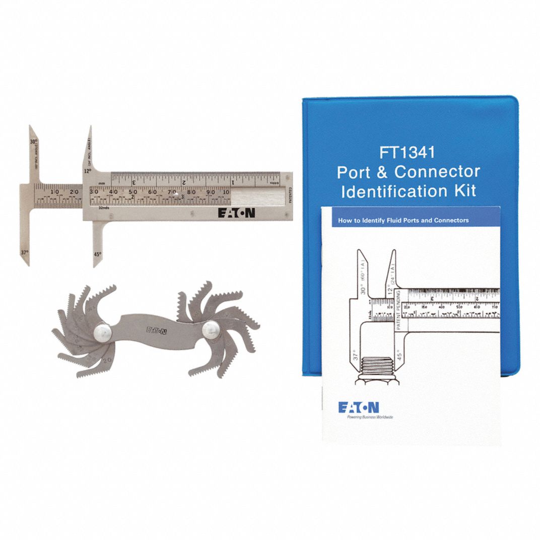

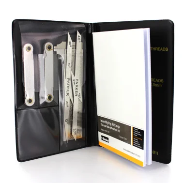

that's a bummer on the setback, but there's no shame in sharing your fitting tree. 😀
btw, the thread size of a -8 orb is 3/4" 🙃
I highly recommend printing a handy little chart like this or whatever fittings you're working on and slip it inside a plastic page protector or laminate for the shop wall. 🍻
I made those for all the guys in shops I supervised to help minimize mistakes and wasted time and materials. also gave one of these to all my mechanics, very handy! ;)
Parker MIK-1 Thread Identification Kit
AEROQUIP Thread Identification Kit
Very nice kits there. My mistake,,, was taking the valve posting size and breaking my promise to myself and waiting until I had the valve in hand, dumb, move but yesterday I got out the calipers and thread gauge and ordered what I needed in SAE 8.
You and the Old Machinist brought out a lot of good info in this thread and I referred to that yesterday in my search to identify.
