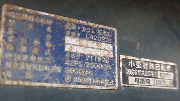

Here is an L4202 data plate:
One can search these model numbers in youtube, and find videos of them in operation, mostly in southeast Asia. I'm not sure if the V1512-DI-TI-N or V1512-DITC engines seen in these videos are factory-installed, or transplants. The V1512 engine was also used as a stationary powerplant (irrigation pumps, generators, etc.).

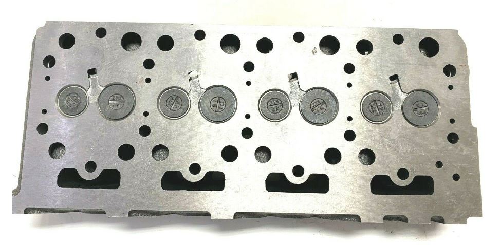

V1502/1702/1902 Cylinder head casting (non-turbo):
VT1512 Cylinder head casting (turbo, 15345-03040):

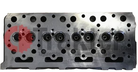

It is easy to see the important difference here. The non-turbo head is an Indirect Injection head, with a spherical pre-chamber ported into the combustion chamber between the valves. The turbo head is a Direct Injection head. The injector nozzle protrudes through that chamfered hole between the valves.

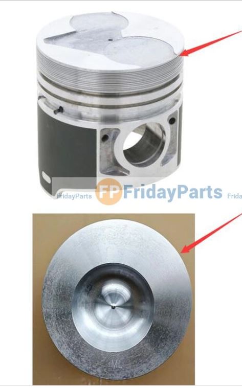

Here are the two pistons:
The top piston is for V1512 (non-turbo) and the bottom piston is for the V1512-T. Notice that valve reliefs are missing from the turbo piston, and that it has a bowl in the top. The injector nozzle is centered in that bowl. Strangely, the injectors for the V1502 and the VT1502 in the parts list are apparently, the same (see below).

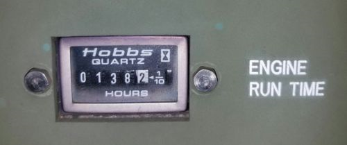

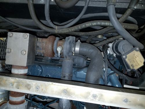

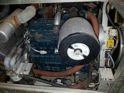

I bought a 44.2hp Kubota V1505 TE turbo charged engine with 138 hours on it. It was connected to a military generator and the generator went south. I was going to put it into my tractor that already has a non turbo V1505 but my health has taken a turn and now I don't have the energy or the will to tackle the project. So I will likely sell it to some one that could use it. I have a video of it running while connected to the generator. Since the military uses 24v you would need to change a few things to 12v.

I bought a 44.2hp Kubota V1505 TE turbo charged engine with 138 hours on it. It was connected to a military generator and the generator went south. I was going to put it into my tractor that already has a non turbo V1505 but my health has taken a turn and now I don't have the energy or the will to tackle the project. So I will likely sell it to some one that could use it. I have a video of it running while connected to the generator. Since the military uses 24v you would need to change a few things to 12v. View attachment 94771
