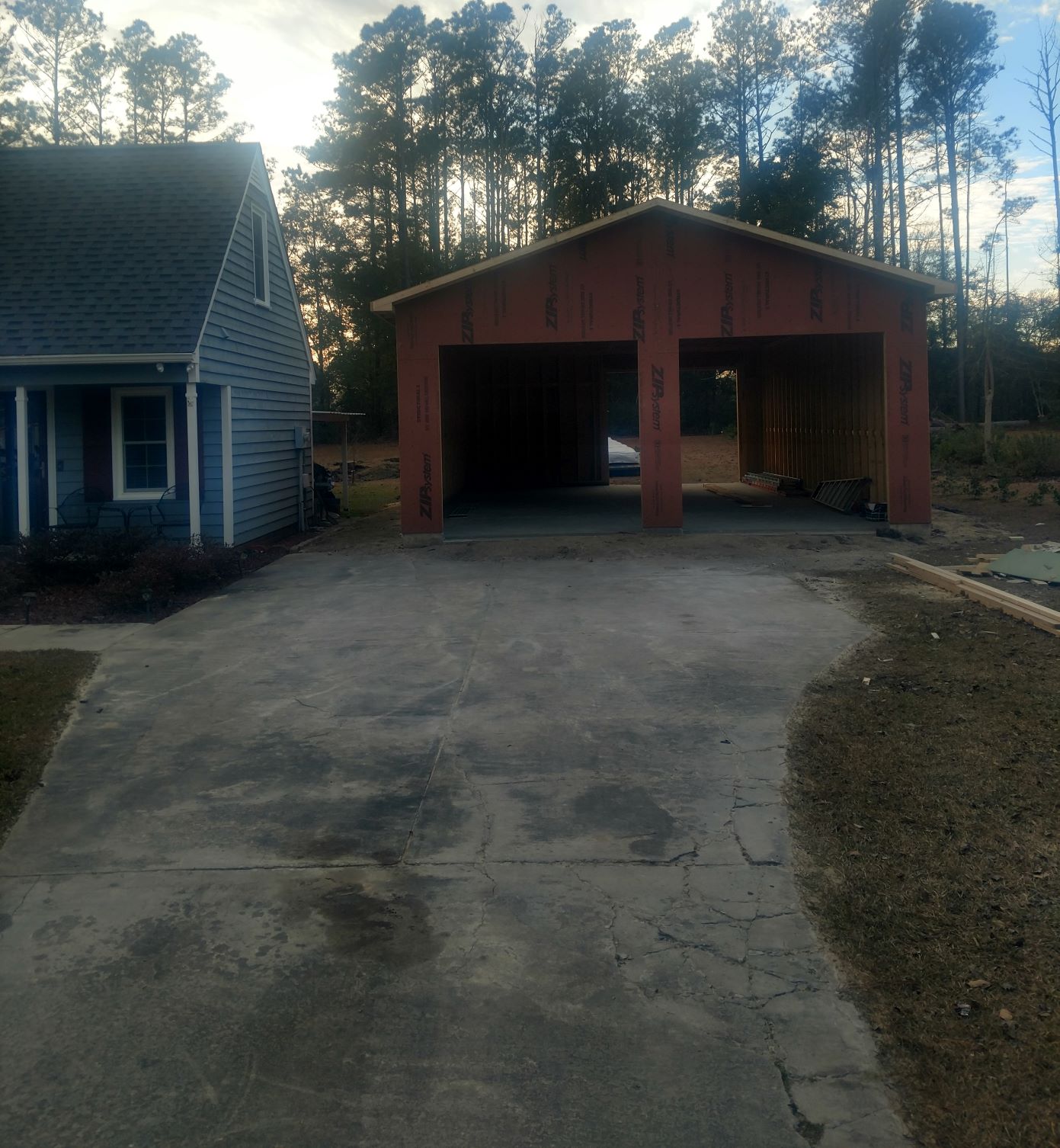

I planned to have my driveway concrete redone and poured to work with my new garage (I will attach a picture for reference) until I received the estimate this morning. It was $17,000.00, so I think I will be environmentally conscious and just grey rock the entire thing. The bags of small rock I will be unloading and moving around weight 1100LBS. I plan to put down a fine rock for a base then a larger grey rock on top which will be delivered by dump truck and spread with my bucket. Is it better on my L2501 to run in or out of 4WD while performing these tasks?

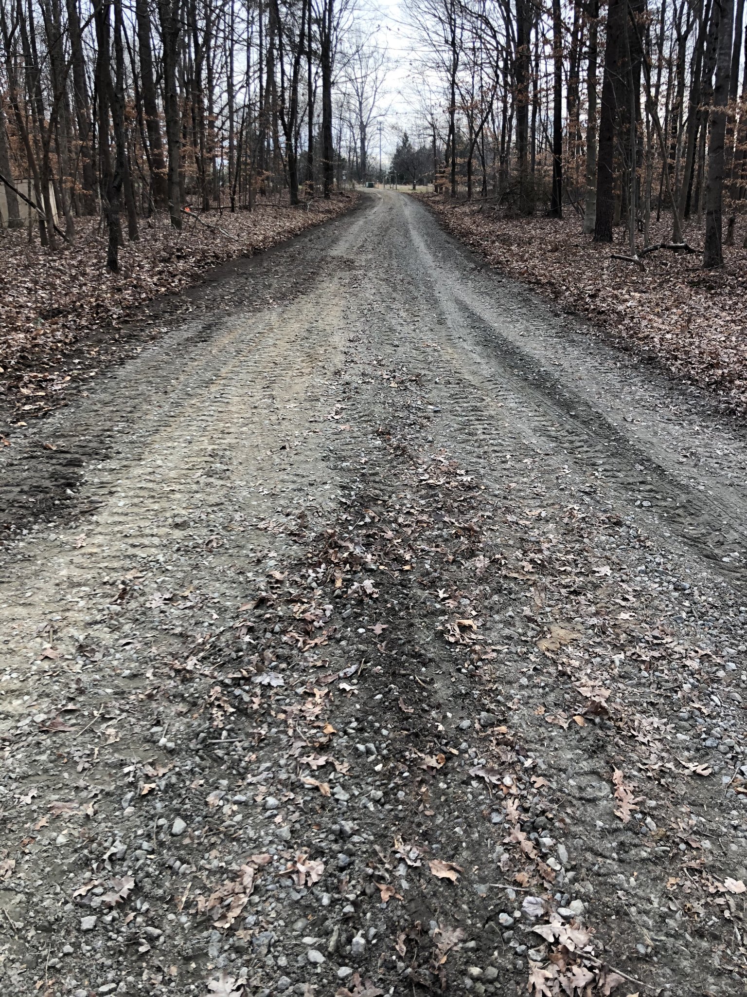

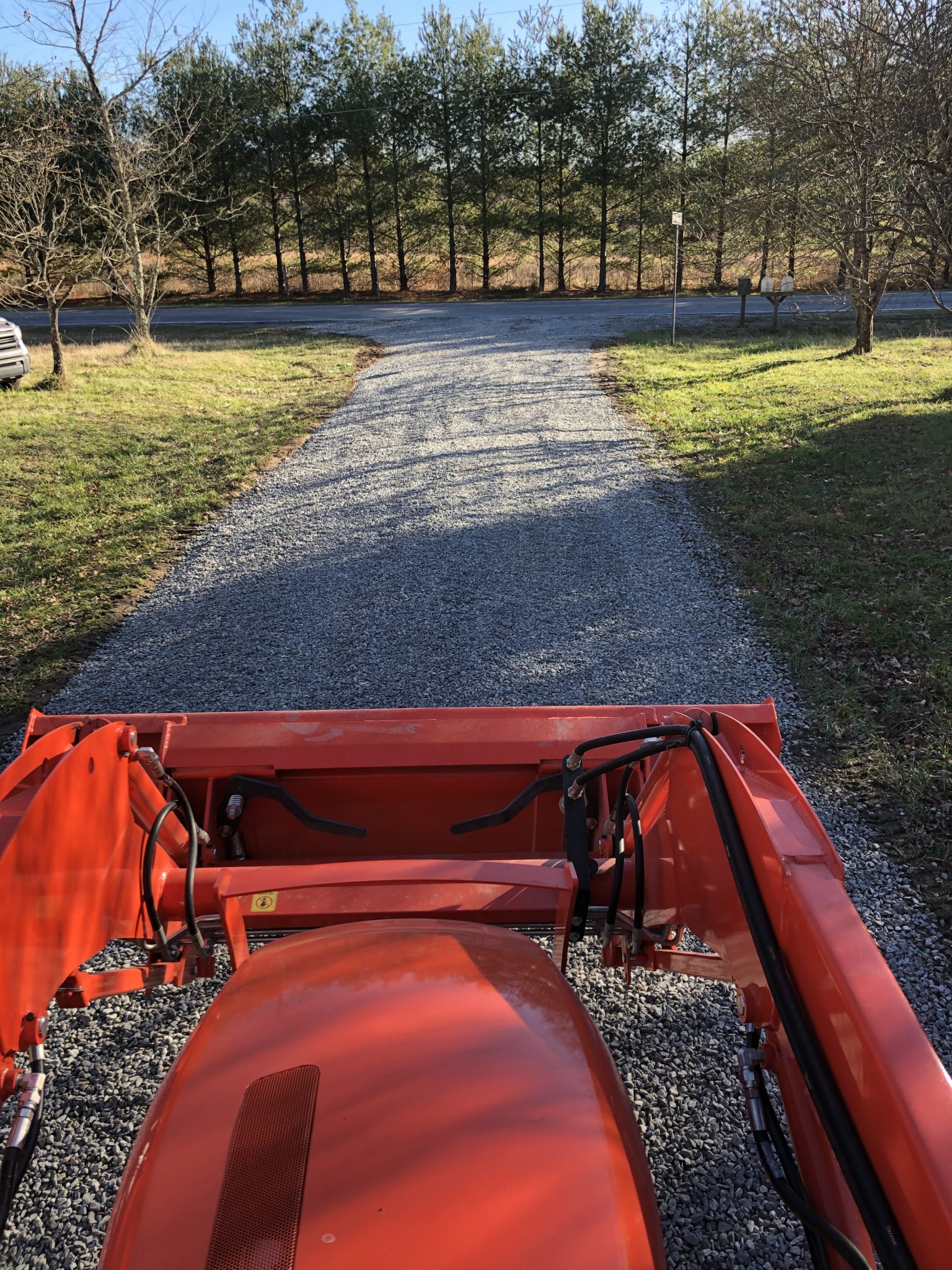

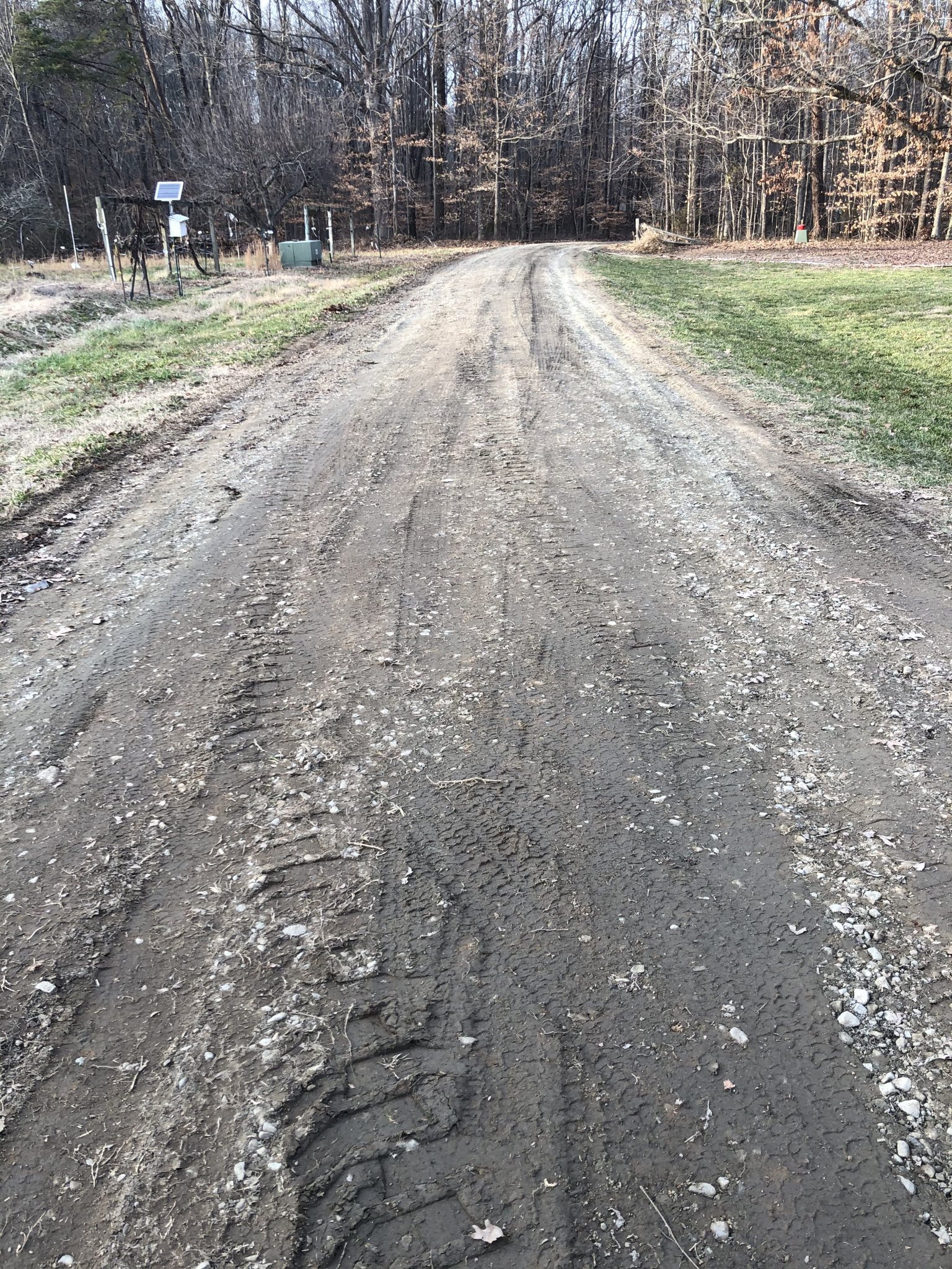

For the base you might consider something more like ABC unwashed crush run. That would give you a mixture of 4” all the way down to fines. Some quarries call it “road base”. The larger rock keeps it from settling into muddy dirt when it gets wet and the fines lock it into a solid surface. Due to the fines, it will get slick when wet so topping off with washed, graded stone in the size of your choice keeps feet and tires clean.
The first two pics are ABC road base. The last is after topping with 3/4” washed.

That last picture is what I am imagining in my head. The crush and run base may better than the fine rock I was going to purchase from Lowes, maybe cheaper. Even though It's in the beach area, yard is not sandy nor is it clay.

Guys / maybe women are giving me great information, which is why I am here asking the knowledgeable. My plan was to not disturb the existing concrete, thinking it is already a great base. I'm I wrong in that assumption?

That’s a great looking drive

Sorry, didn’t realize you were going on top of the concrete. In that case I’d have to agree with TheOldHokie: check into asphalt. Much cheaper and it will tie it all together without messing with the concrete.

I would be reluctant to put aggregate on top of the driveway slab. It'll never compact, IMHO.
If you did, I would be apt to put the finer stuff down first. No pea-stone; you want something crushed/angular. Preferably with some fine material to help it "stick."
With rain, even a crusher-run will lose it's "fines" and make it a bunch of marbles rolling around on top of the slab.
I'm with Dan/The Old Hokie....consider asphalt over an aggregate first. Never heard of laying blacktop over a slab, either. Guessing with a good tack -coat first it might stick...I see your in NC and I'm in frosty upstate NY. Thinking the freeze/thaw cycles aren't too much of a concern?

If prepped correctly asphalt can be installed over concrete. Has to be ground to an appropriate texture for it to stick as it doesn’t really “stick” but is more of a mechanical connection. HVAC Roger being from NC there’s a nominal chance he hasn’t witnessed NCDOT resurfacing concrete roads with asphalt after grinding as they seem to be quite enamored with the process. It probably isn’t a DIY job.
