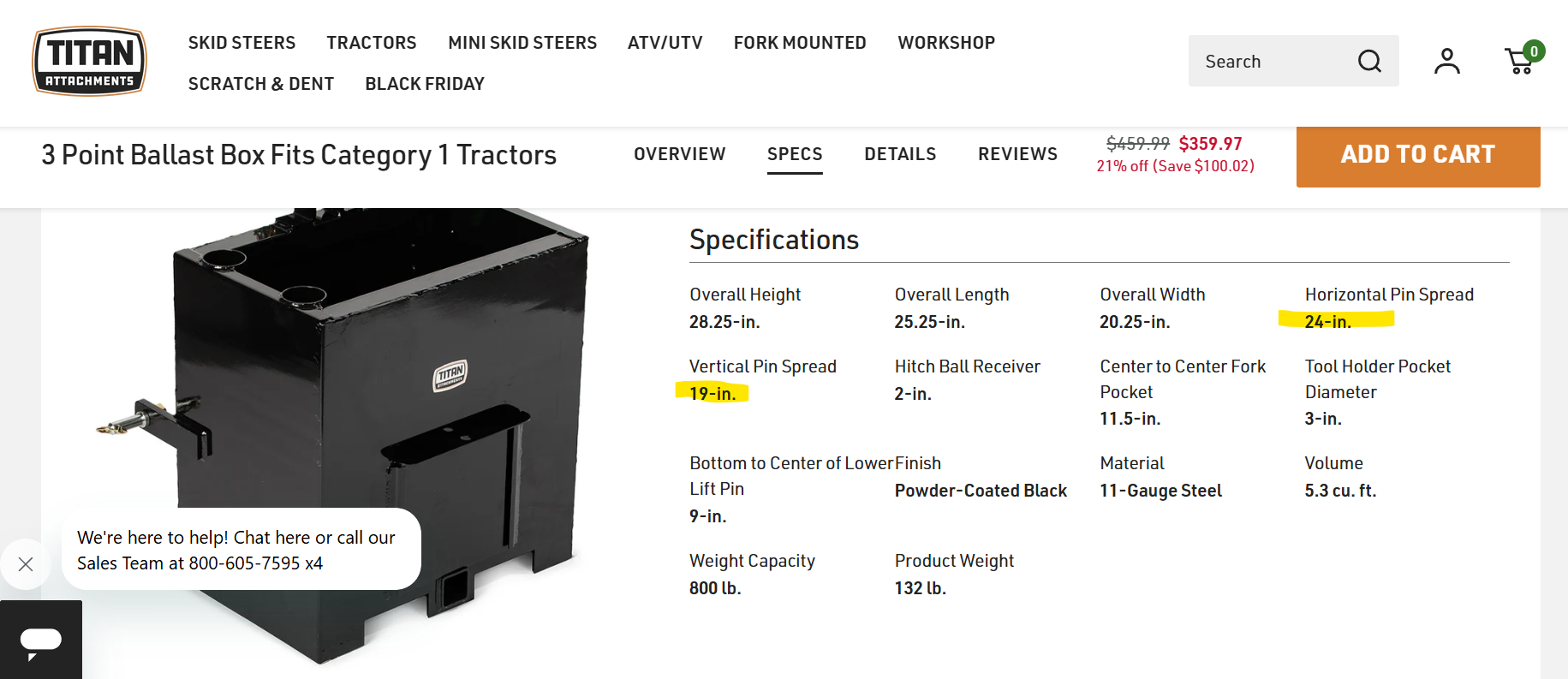

Does anyone know if this Titan Attachments ballast box is compatible with Land Pride QH10 quick hitch?
They're both Cat 1 so it should work, but we all know it isn't really that easy, and I'd hate to spend the money on something I can't really return.
If this one won't work for me, can anyone recommend a decent quality ballast box that will fit my QH10?
kwilson
LX3310
Nov 25, 2024
Oregon
I did see that. Is horizontal pin spread in those specs the distance between the two lower attachment points? In that case, this box will not fit, as the hitch width is 28".
Chad D.
Sep 21, 2019
243
115
Eugene
Seems like the vertical dimension is what typically screws us that have QH-10 with the solid top hook.
