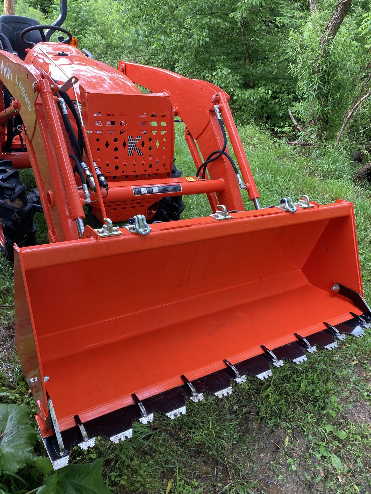

Decided I needed some Ken's Bolt-on hooks for my L3901. Didnt factor in just how tough the steel is on the top of that bucket!
Cheap HSS bits and a drill doctor bit sharpener got me most of the way there, but it took FOREVER to drill each hole (about 20 mins each). After the first 4 holes, I decided it was going to have to wait until the next weekend...
So I got online when I got home and ordered some Bosch cobalt bits. Wow what a difference! Next weekend I got the hooks and shackles all installed, just in time to have my Everything Attachments Wicked Tooth Bar arrive at the house.

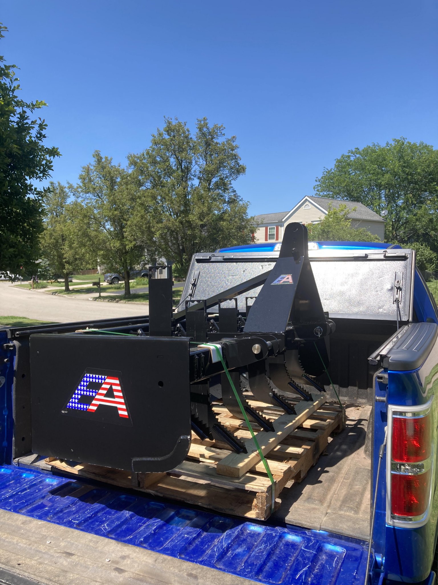

Ugh... That tooth bar took 3/4" bolts on each side... and also came with approx 8 more bolts that were 'optional' and which could be installed along the bottom edge. Had to get another $54 cobalt bit to make those 3/4" holes and decided to wait and see if the bolts along the edge were needed - as it seems like most customer pics were without.
After all that, I installed a new hydraulic top link. What a game changer! Haven't hooked up my EA box blade yet (too muddy last weekend for box blade work) but can already tell that's going to be a match made in heaven... best part - no holes needed.

wow. those are some interesting shanks on the box blade.
If I recall correctly, I didn't have much trouble at all with the holes for the tooth bar. Small pilot bit, then ripped thru it with a $20 step bit. Send the step bit thru both sides to clean up the hole.

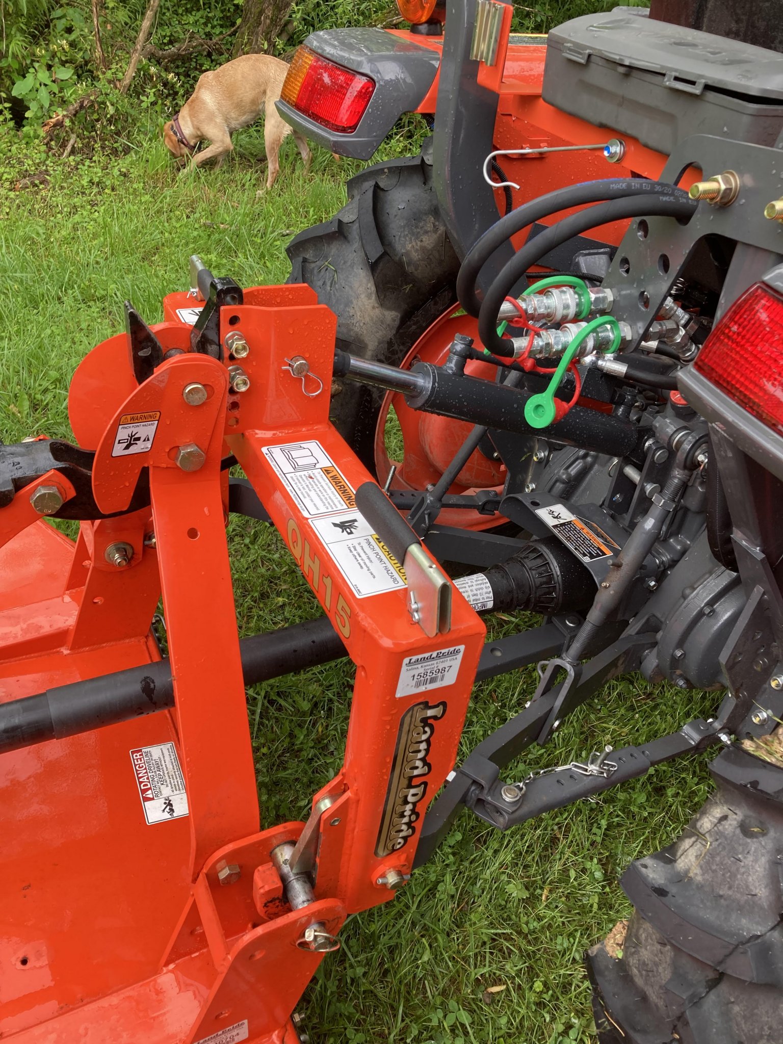

I think you have the QH15 on the wrong top link. I’m new to Quick Hitches but you aren’t supposed to change the holes for the QH15 if all of your implements are QH compatible. That means you should be hooking to the black lower link.
Besides the rotary cutter, I also have a Land Pride Grader Scraper and Rear Blade.
This video shows what the lower link is I’m talking about.
Here’s the still from that video.

Thanks for taking the time to put that reply together. I’m aware that hooking to the black cast iron floating link is possible. There are some problems, however…
1. That black floating link needs to be able to move freely. This is especially true when the terrain is very hilly/uneven, as my land is. The metal finish on that black floating link is also very rough and tended to want to bind in the hook of the quick hitch.
2. According to the manual for the QH15, I am actually supposed to be using a *second* floating top link assembly consisting of two pins and two plates. I found it to offer a lot of range of motion, but it caused the QH15 to need to be angled so far back toward the tractor that raising the 3pt caused the QH15 to hit the tractor tail lights.
3. When I initially tried running as you suggest, it kept shearing the quick attach pins holding clevis pins into the big black hook of the QH15. Then the clevis pins would work out and get lost. Happened repeatedly and I went thru three replacement pins in about 15 hours of use. After eventually losing the both pins and the big black QH hook completely (and finding it after a long search), I decided there was just too much lateral movement due to my terrain and went with hardened bolts and nuts. Problem solved.
4. As a general rule, I don’t take unsolicited advice from people who say “I’m new to this but you aren’t supposed to…” If you are certain, please tell me that and explain why.
5. I don’t take advice from guys on YouTube who also don’t have a lot of experience… note the shipping stickers on that guy’s brand new tractor. Any yahoo can make a YouTube video. Doesn’t mean they know their backside from a beehive.
So in summary, I’m aware lots of folks run their Quick hitch as you suggest. It didn’t work well for me.
Am sure you were attempting to be helpful and appreciated your effort. Thanks.

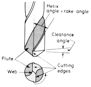

The only thing I think of when you say cutting fluid is the milky stuff I see being squirted inside big CNC mills as a solid stream. Always wondered if that stuff was water based, oil based or something else entirely.
Clarifying question: when you talk about the "web" of the bit - is that the term for the spiral part left over between the grooves in the bit? If so, are you matching the width of the web to your final pilot bit?
For the record, nobody was giving you advice. I was just pointing out what I saw was obvious as someone who has the same Quick Hitch and similar cutter although I think mine is larger as a 72. The link to the video was simply giving the guy credit that I took the screenshot from to point out where I was suggesting to attach. No idea what his qualifications are, and it doesn’t matter.
There are a lot of youtubes from Land Pride and also Kubota dealers who show how to adjust rotary cutters, install Quick Hitchs, and show connecting to similar cutters either rotary or finish cutters.
You solicited comments by making a post.
You say you had too much lateral movement. You should have almost zero if the lower arms are adjusted correctly (tight) to the Quick Hitch, and you have the correct size bushings for the implement. You seem to be working around an issue you have due to other things by using the Quick Hitch as a non quick hitch.
One more thing, with a little looking you can see that not all Quick Hitches have an adjustable toplink. In fact, the dealer that I bought my blade from made a comment that they stopped selling QH15s and switched to selling QH10s because QH10s are cheaper and if the implement is actually following the standard, and adjustable toplink isn’t required.
Ask yourself, if you had a QH10 and connected as designed to the rotary cutter, what would your “solution” be?

Sorry...should have said Cutting Oil vs the last reference to "Fluid". As you describe, Cutting Fluid is usually oil that is water soluble for use in large band saws, mills and lathes.
Here is a diagram for the drill bit web:
I just keep a bottle of Cutting Oil handy near the drill press...kind of messy, but it speeds drilling and helps increase the life of expensive large-diameter bits.
<snipped text>
Most likely it would be to ignore you. Thanks again for your time.

Classic case of a picture being worth a thousand words. Learned a little bit more about proper sizing of pilot holes.
Now that I understand what the "web" of a drill bit is, it makes total sense why the pilot would be sized to it.
