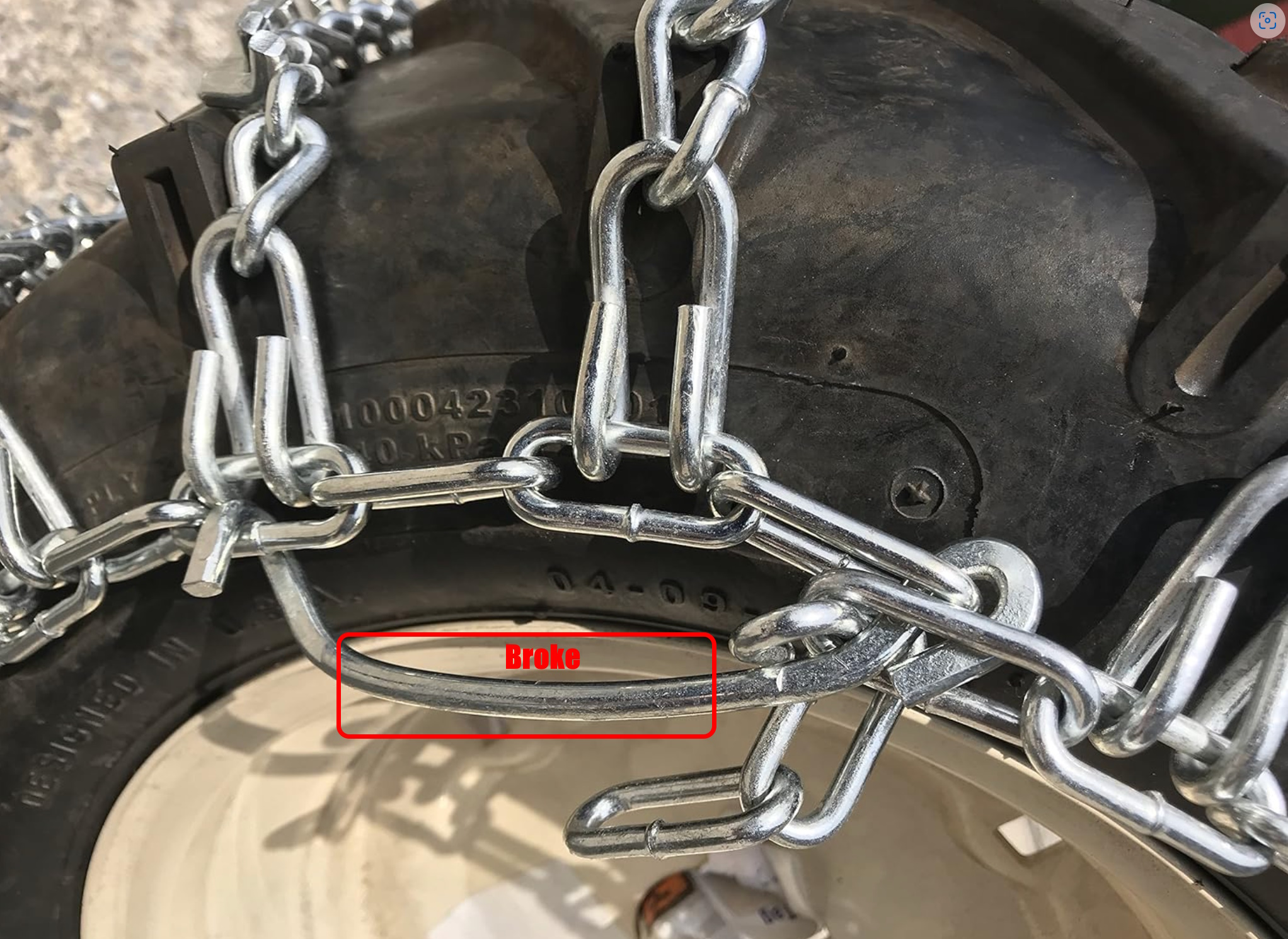

I've a set of new chains for both the front & rear of the BX24. Chains are V-Bar. Last yr. first trip down the driveway one of the clasps broke. For the life of me can't recall what that part may be called, also if they can be purchased alone. Also, can you folks think of another means to repair, use something else in its place? Thank You Again!
13,960
5,831
All you are doing is holding those two links together. That piece just has a hook so it can be removed easily. Anything will work, a carabiner clip if nothing else.
Thank You Luckily, I had eventually found several spares from other chains that had come with the tractor.

This looks like it might be what you need.
Side Chain Fasteners
Thank You for the link. I indeed saved, just for the hell of it after, went scouting the innerweb (gas monkey garage) term. found several sources with the same, lots less expensive to boot. Least now I've a reference to work from should it be needed in the future. Again, Thank You.

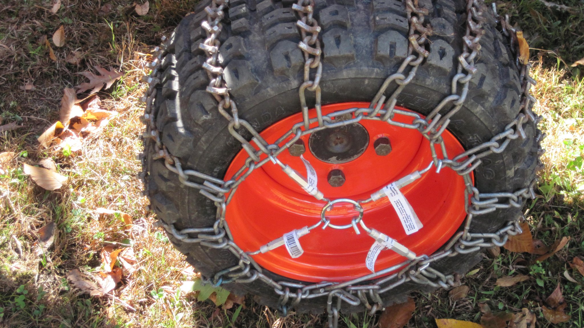

Have a peek at today's setup. Can you see any potential issues? Something could be different? really any ideas certainly welcomed. Using the turnbuckles able to retighten as needed. I may go with another batch of small turnbuckles see if I can produce somewhat of a star pattern, sadly hardware store ran out as I grabbed all that I could locate.

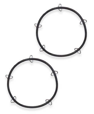

Went and made me a change in my homegrown tensioners, still on the fence with my feelings.

In img 1011, that 'hook' in the upper left should go through a link then loopback back onto itself.
Probably a few 100 pictures online that'll show what I mean.
You are not installing the latch tensioner properly.
It should go through a link then latch back to the proceeding links in line, not across a bunch of links.
I tried like the dickens to loop it back so many times lost count. Just didn't have the strength. When I had them so that I could latch properly chains so very loose, even the tensioners didn't have enough travel to remove slack. Get the chains nice & tight or there abouts, I could no longer loop the latch back over to catch a link. I'll surely be trying several more attempts as still not happy with things the way they are.
30,986
6,980
You do not need the have the latches tight, just snug is fine.
Rubber tensioners work way better than solid tensioners.

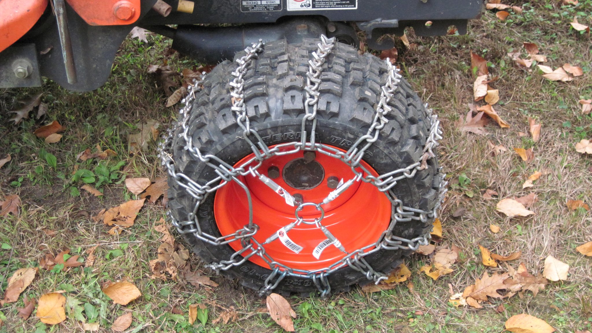

I want back for another round this morn 0700-1200hrs. How many O'l Farts does it take to put on a pair of chains? Anyways, I went back repositioned everything got the locking handle positioned correctly, looped back. I'm still not too sure happy as 1 cross chain is ever so loose, Where yesterday's setup everything nice & tight. I wrestled & wrestled just don't have the strength to catch another side link. To me the rear side links appear even closer to the tie rod ends from yesterday's arrangement. Sure, is a nightmare when everything goes in/out of focus, hands don't work as they used to. Strength lucky if can open a bottle cap. Believe "Diesel" (cat) has more brains at this point. Anyways, todays snapshot.
