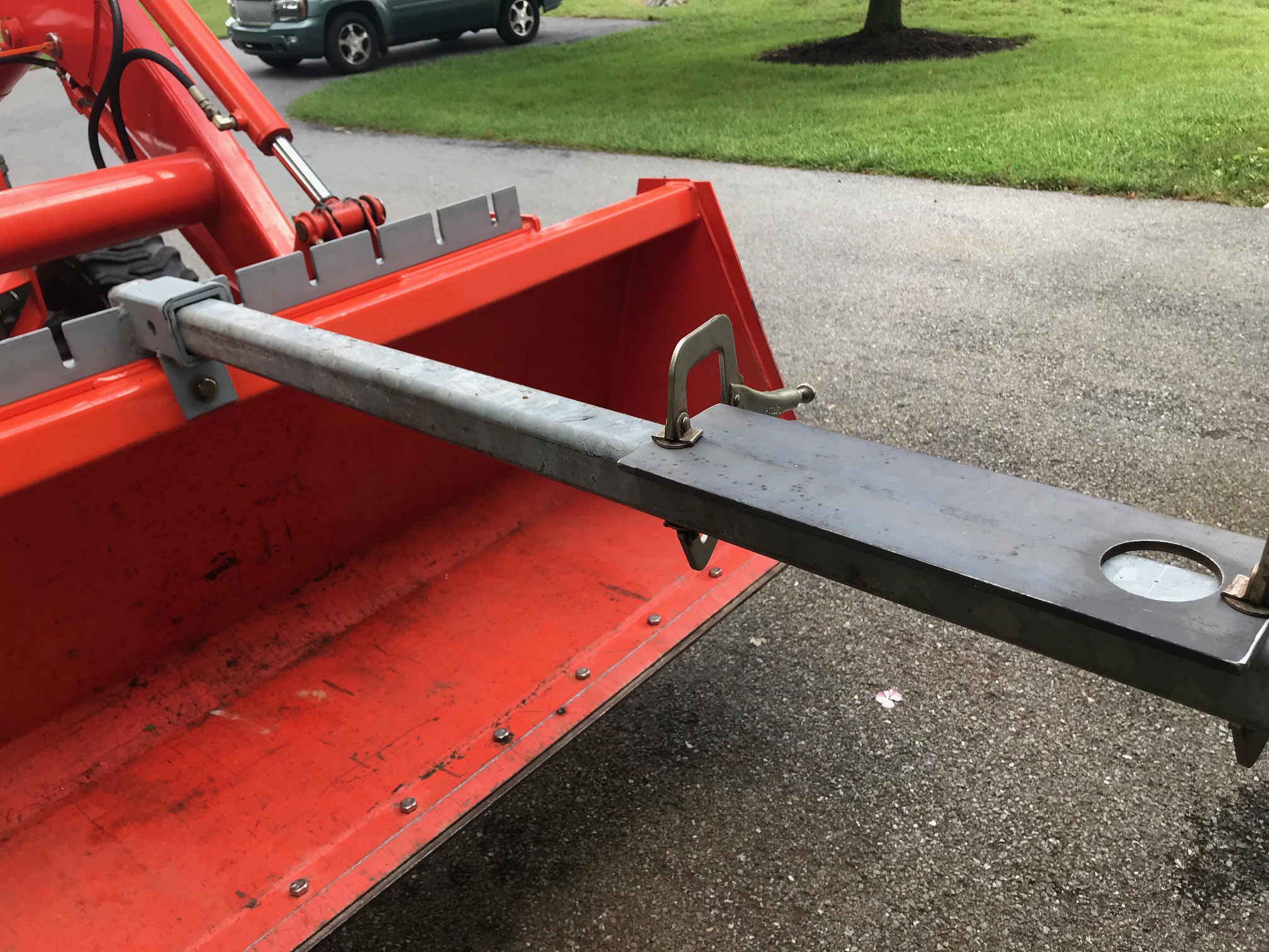

I've been reading up on lubes, and decided to head for the welding supply store and get a stick lube. The metal shop used that lube on the Hougen and Jancy annular cutters for years with great results. I was out in the shop one day when they spent all day drilling I beams and the cutter was like new at the end of the day.
Drilling has generally been a part of fab work that I haven't enjoyed very much over the years. I can definitely say I know the pain. Just recently I bought a Vevor MD40 mag drill, and was gifted a hefty drill press in the course of three days. Pretty well covered now. Only test drove the drill press but used the mag drill with both the annular cutters and the Jacobs chuck on small projects already.
Not making this move years ago was a mistake. For one example, the bucket in the picture has five 1/2" bolts holding the angle on top and the wear edge has 13. That took 36 decent-sized holes (18 plain hole and 18 tapped). All were drilled with a good cordless drill.
I posted about the drills the other day, and the picture below is from today. The 2x2x1/4" galvanized square tube needed a 3/8" hole drilled straight through. I had already made a base plate for the mag drill that can be clamped or tacked onto whatever needs drilled. It has a hole in one end that can be positioned over the target, or it can be flipped around so the drilling is done off the end.
