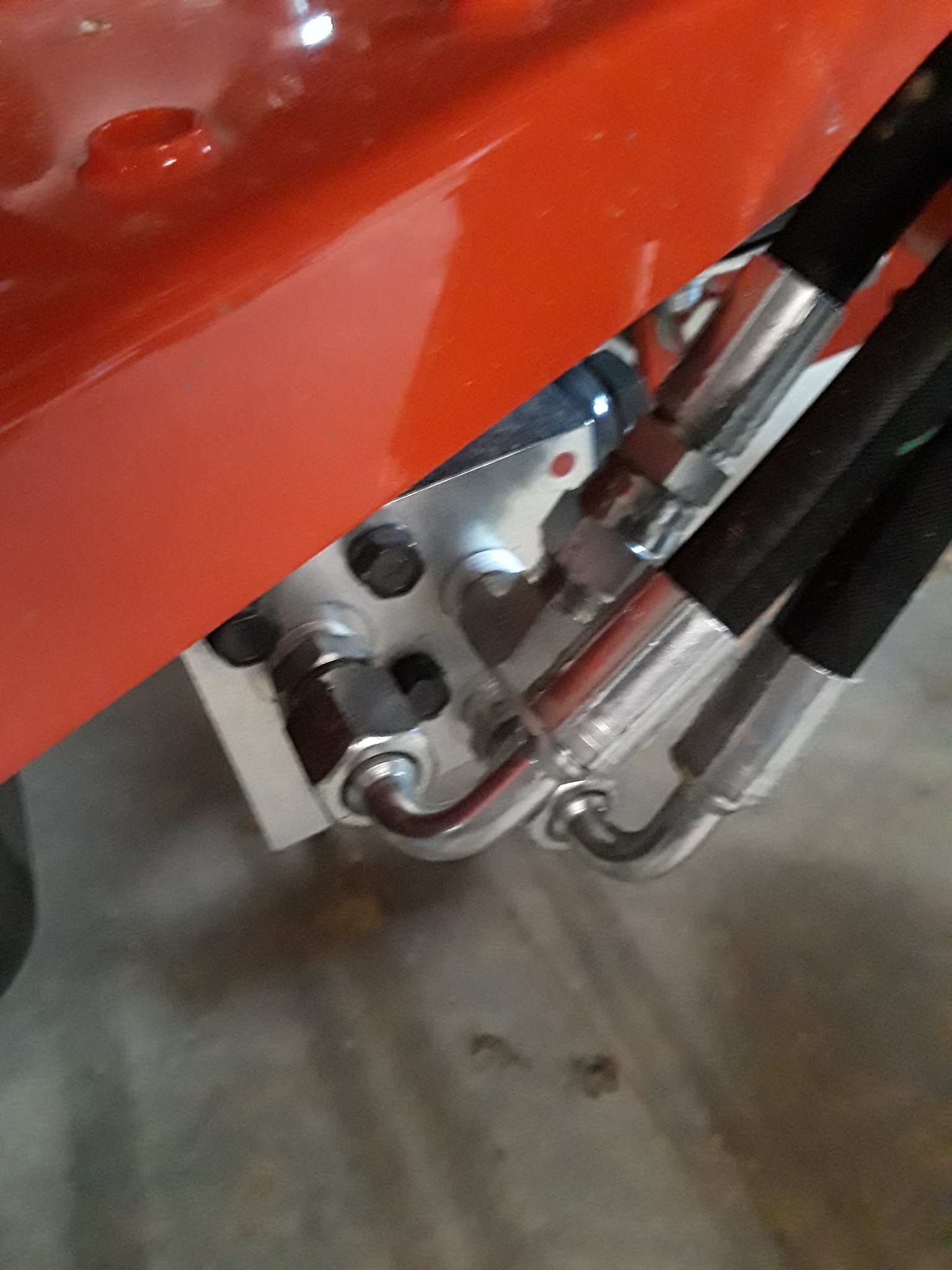

On my new L3901 the PORTS appear to be 3/8 NPT. The loader hoses have JIC-8 female swivels on the ends and NPT to JIC port adapters are used to make the port to hose connections.
Interesting. My buddy thought that his L3301 port was NPT and found out that it's actual JIC. Did you actually open and inspect it?

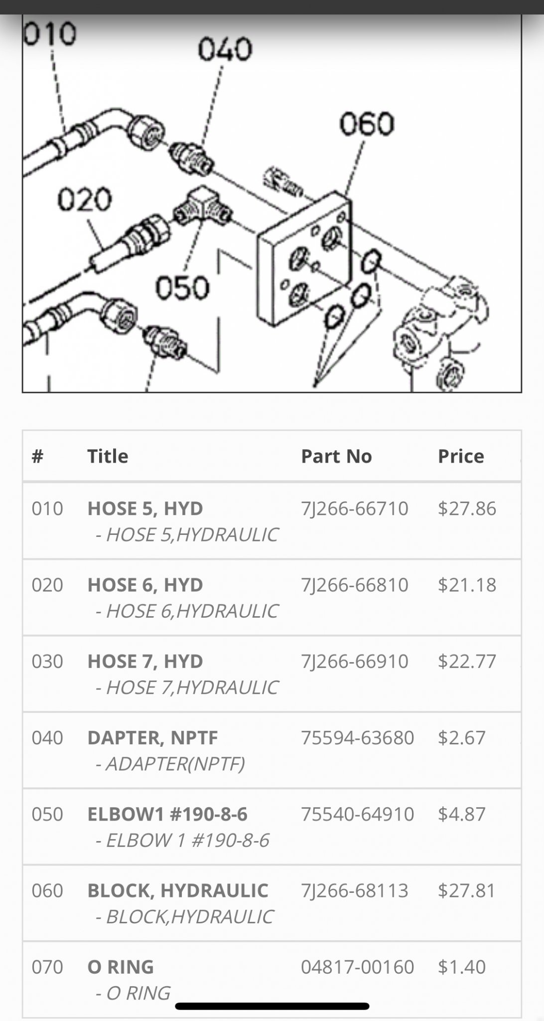

Forty plus years in the engineering world have taught me to be careful with my words. Notice I said "appears to be NPT". I have not taken one apart to check but I have never seen a JIC port and the male threads are wrapped in PTFE thread tape. Unless the dealer mechanic that installed this loader is a total numb nuts that rules out BSPP, and SAE ORB leaving BSP or NPT.[*]Using a caliper I measured the root diameter of the male threads at the top of the block and get .625 which is consistent with NPT. The block is spot faced at all four port locations which started my Spidey Sense tingling when when I first looked at the connections. I can not rule out the possibility the block is (or perhaps I should say was) BSPP (BSPP ports are used extensively in Asia and Europe) and the dealer mechanic installed an NPT fitting rather then the proper BSPP fitting with sealing washer. Seems unlikely since I expect the fittings come with the loader package. So since you ask I did the obvious and looked at the online parts listing for the LA520 loader package. I found:
040 75594-63680 - Adapter (NPTF)
050 75540-64190 - Elbow #190-08-06
So based on that it seems very likely the ports are 3/8 NPTF (06) and the hose ends are JIC female swivels (08)

Thank you for the clear diagram. The ports on the block are NTPF but the hoses are JIC and they just use adapters between them.

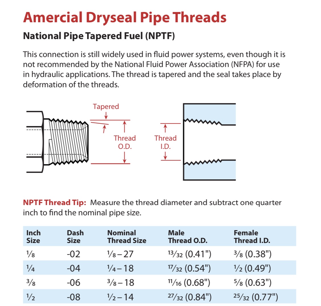

when I see the seal takes place by ‘deformation of the threads’, that kinda speaks to an old service guy (35 years) such as myself that worked on instrumentation that went as high in (liquid) pressure as 28,000 psi and as low in vacuum as 2x10-7 torr.

Precisely. Pardon me for preaching to the choir but i will add this.
Not only does the seal deteriorate every time you remake the connection it gets tougher, even impossible, to properly clock that elbow. The make-up distance on NPT(F) joints is a carefully engineered distance that cannot be maintained across repeated assemblies.
The NPTF thread form also has both root and flank interferences and is designed to seal without the use of sealant. Those sealing surfaces will not survive repeated makeups and will get sloppier every time the joint is reassembled.
