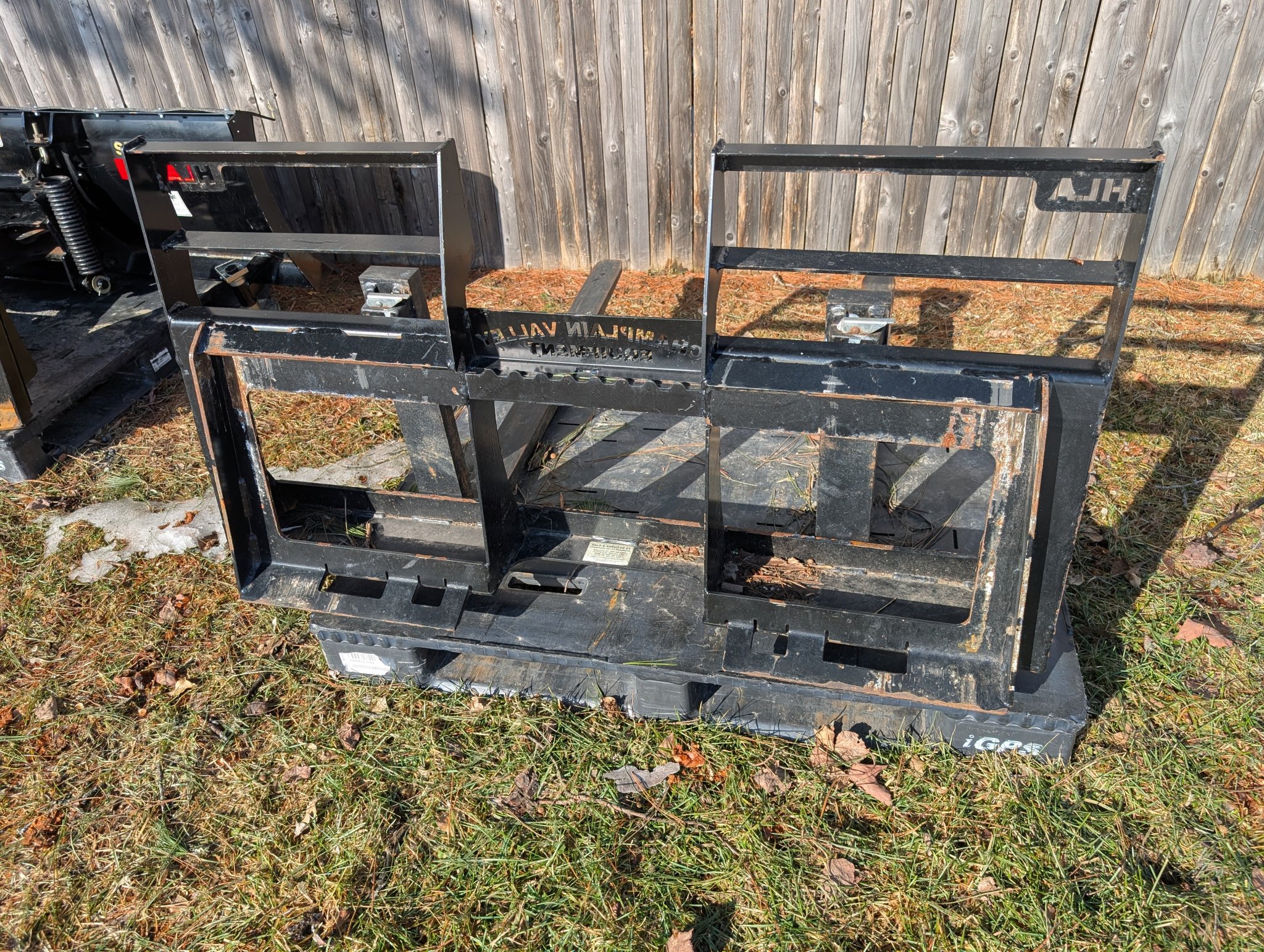

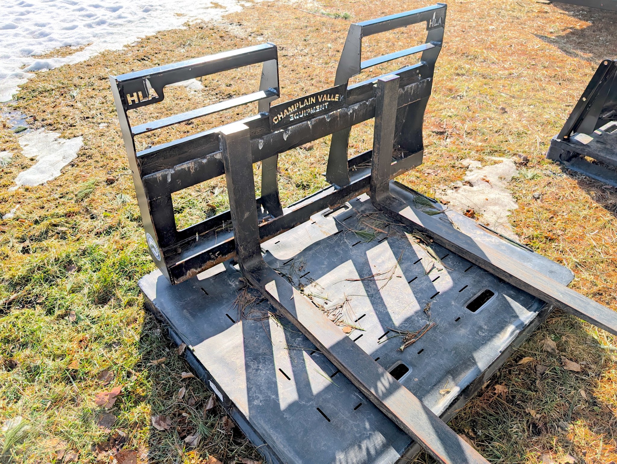

This is the pallet forks that came with the tractor. But It's looking a bit rough and I'm thinking it could be a fun project to scrape off the peeling paint and clean up the rust and give it a fresh coat of black enamel paint. I do have issues with the locking pin things on the tines and they are really difficult to slide back and forth so I'm thinking a fresh rebuild and fully grease everything it should be a really nice set of pallet forks.
I wanted to make this post so I can share some pictures of the progress I make on it and welcome any advice.

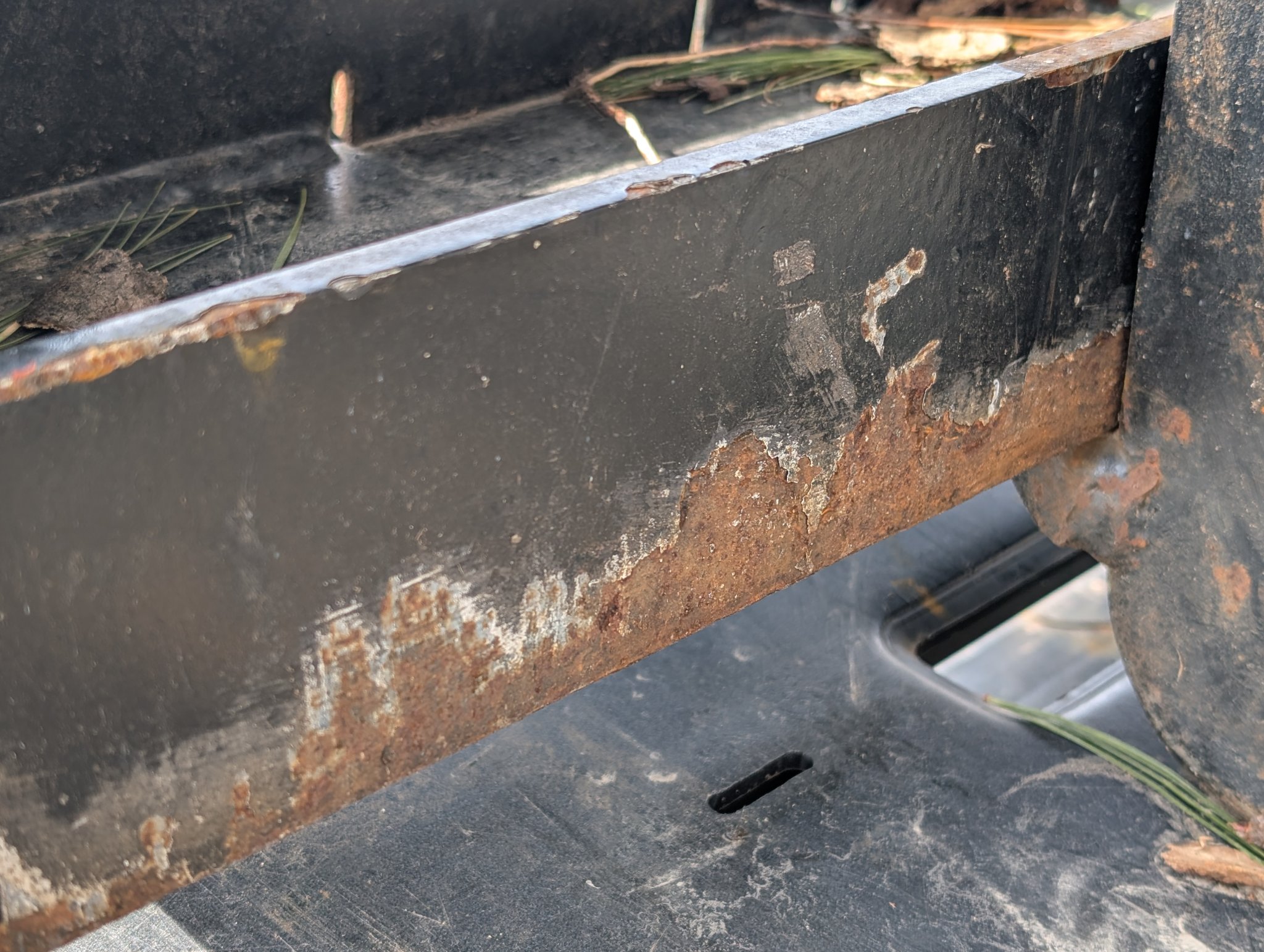

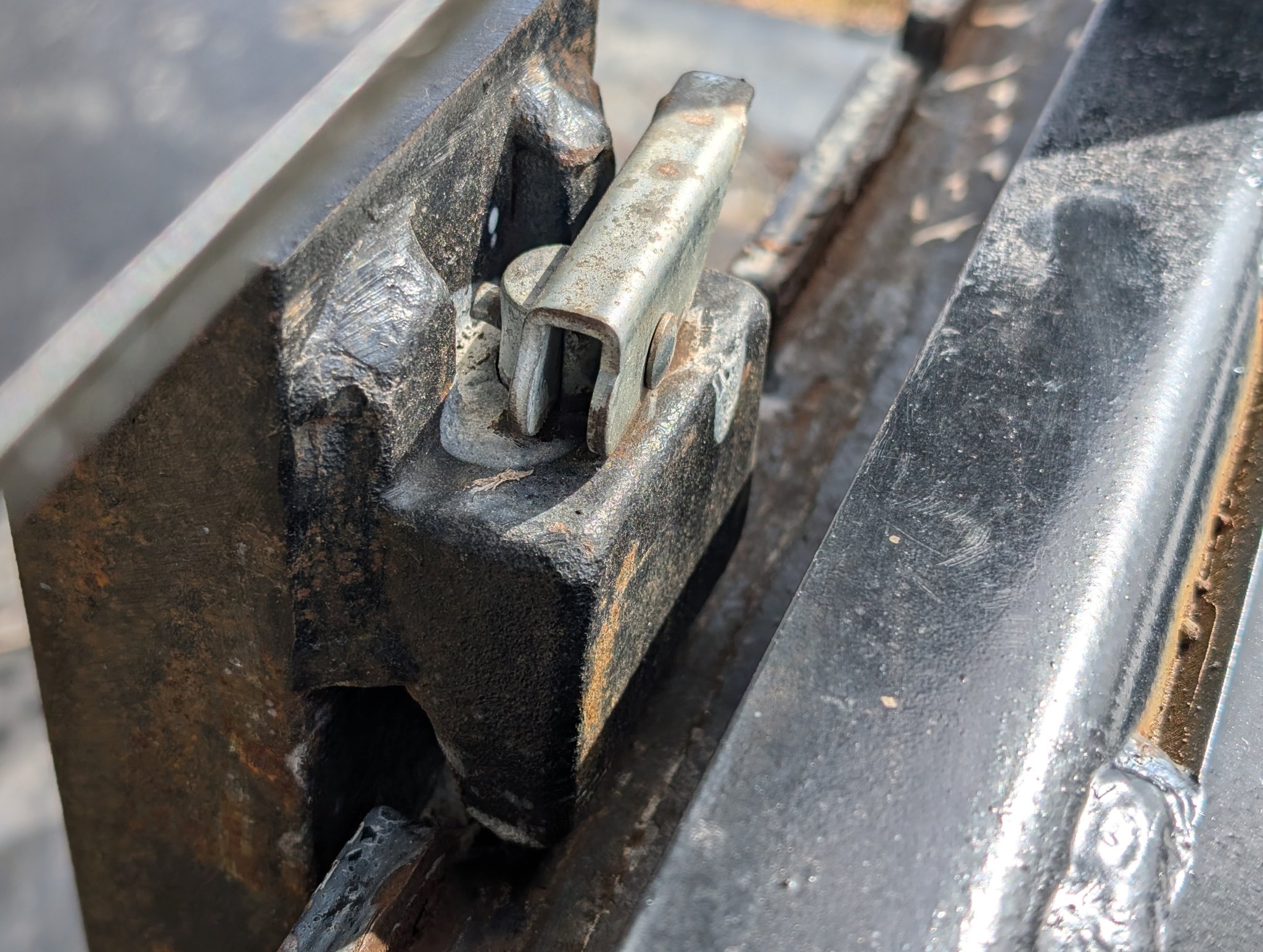

Took some close up pictures of the pallet forks in sorta rough condition. It might be powder coat but its not very thick, breaks off easy.
BX23-S,57 A-C D-14,
13,694
6,195
yup powder coat...seen that too many times....
'breaks off easy' is the tell tale.
hit it with compressed air and SHEETS of it will peel away.... (actually better/easier than grinding...... )
rust on latches says never oiled or at least not very often in it's life.

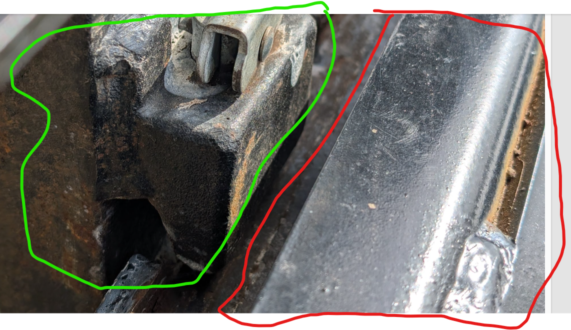

35,246
10,468
Frame is Powder coat (red)
Forks appear to be paint(green)
Strip the Powder coat and paint it all!
Quick sand blast on the forks to remove rust.
Pull the latch pins, springs, and levers before painting.
If you want to do anything to those, either paint the latch levers or electroplate them.

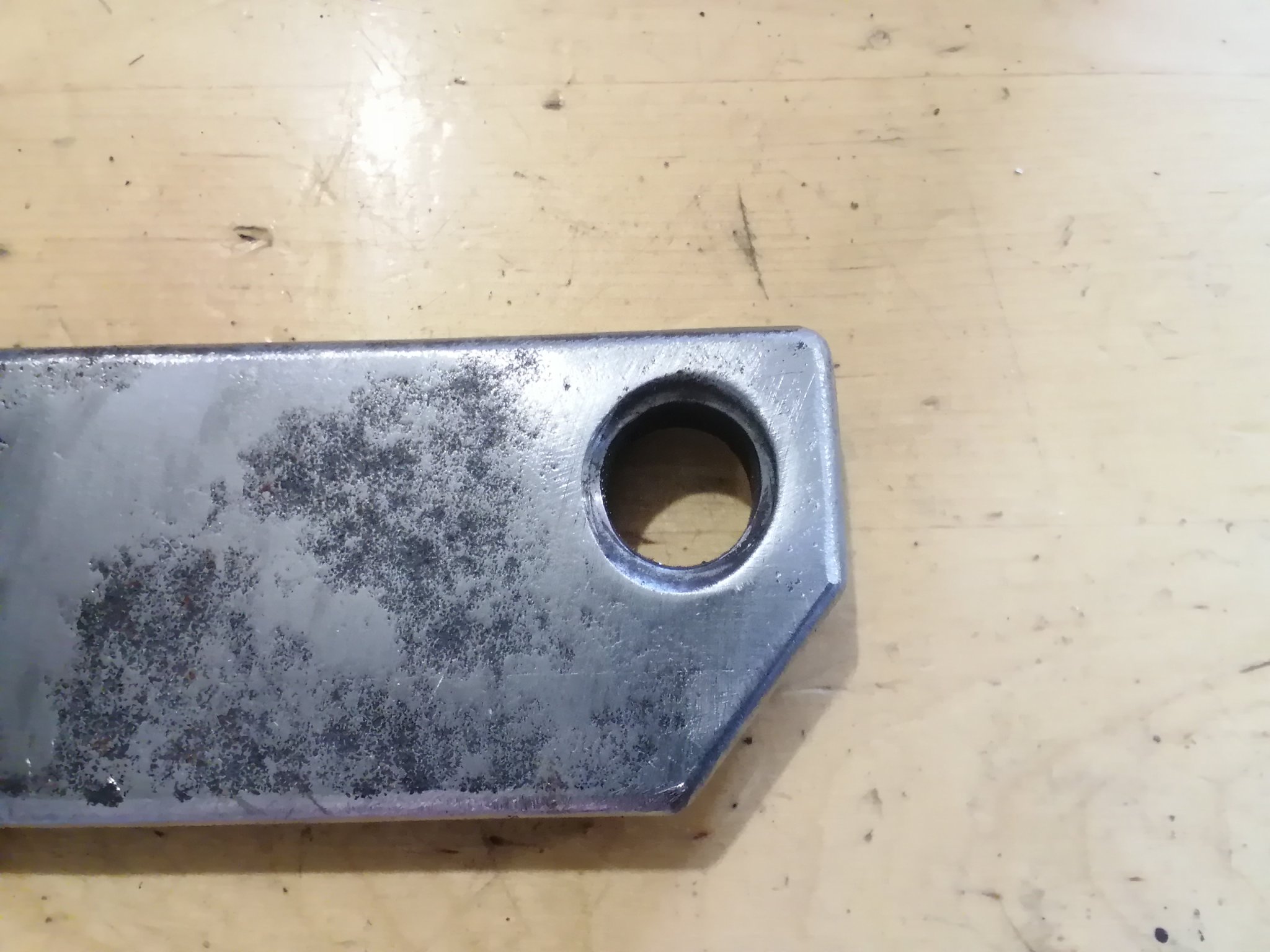

one more thing: round off the sharp edges a bit if they are not required for function. This way you get better paint coverage there. On sharp edges paint is very thin and this is often where the rust starts.
Second picture after CSD disk and before sand blasting. Last picture is after chemical rust treatment and before painting with epoxy primer.
