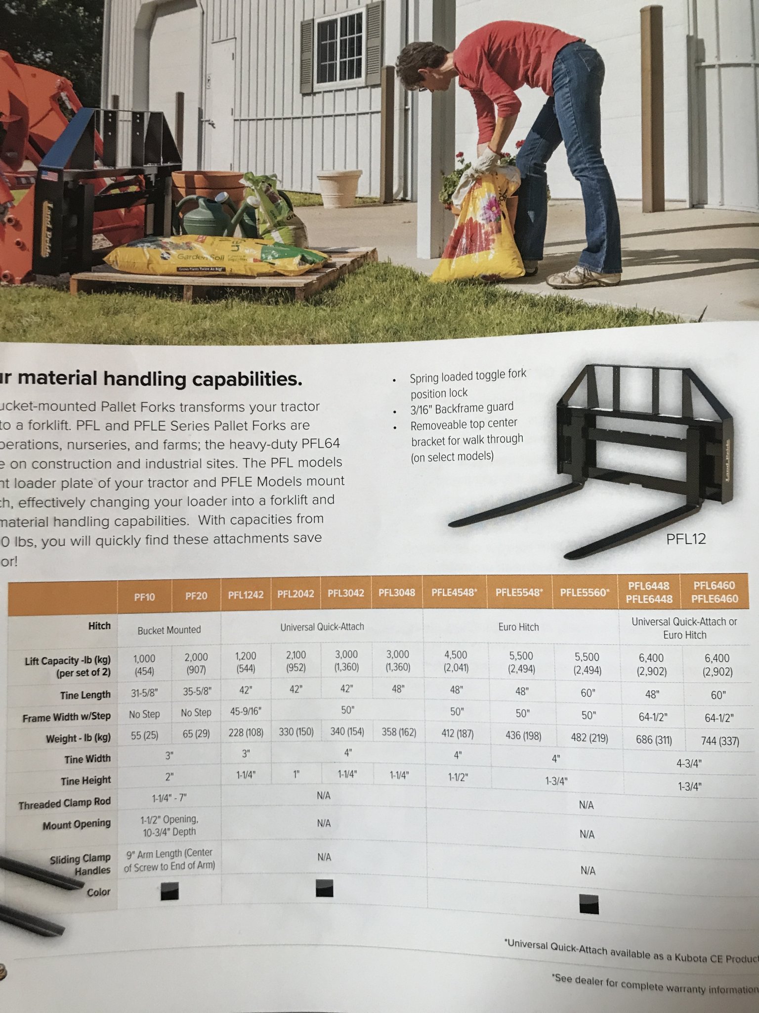

For your tractor Land Pride recommends the PFL2042. They should be a good match but like everything else right now finding a set of them might be a challenge.

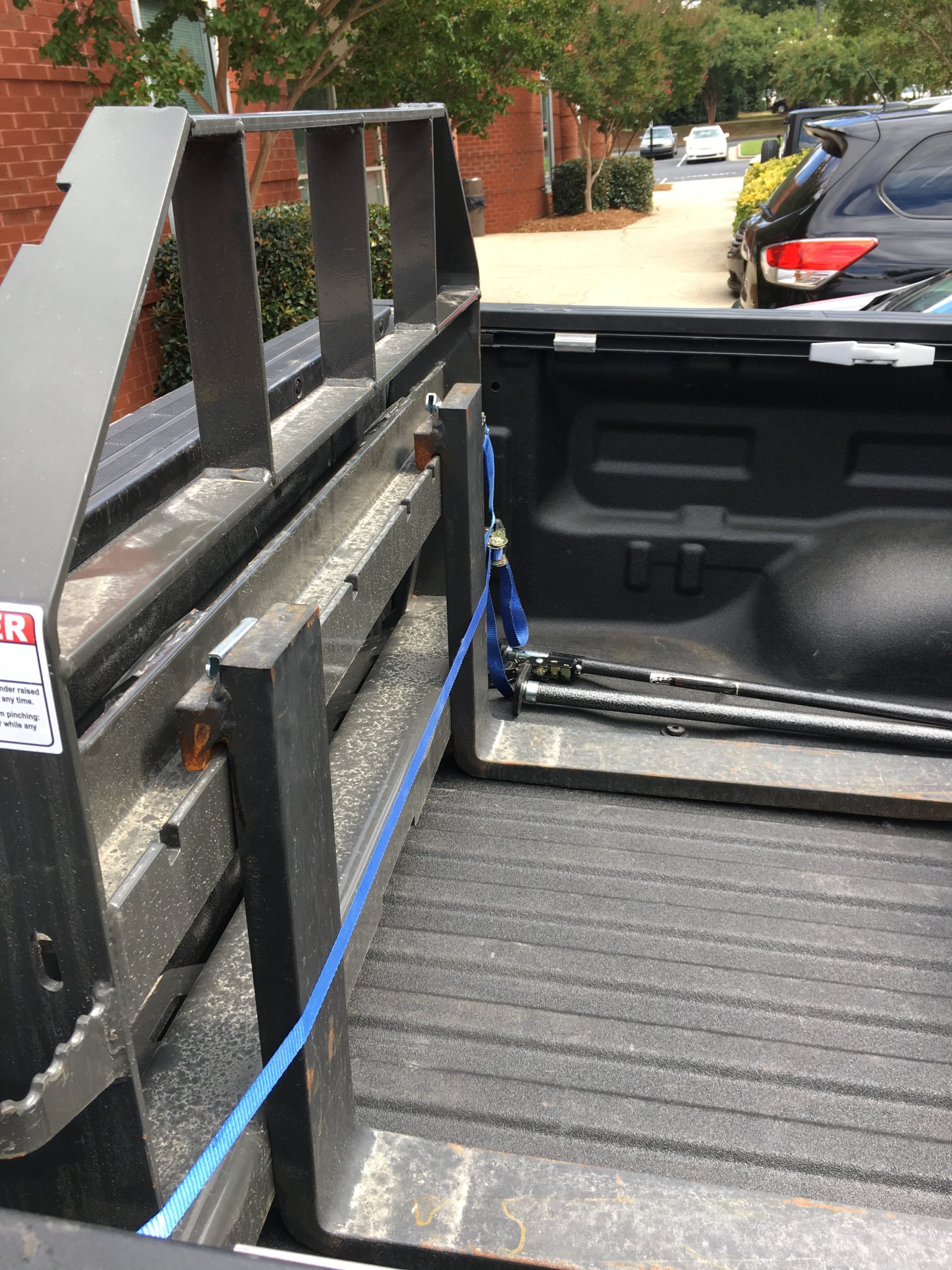

I have these: https://www.rootgrapple.com/product/standard-duty-pallet-forks-with-frame/
They were decently priced, not stupid heavy, local, and in stock so I could stop by on my lunch break to look at them, pay for them, and head back to work with them in my truck. They’re width adjustable (a necessity in my opinion) and slightly over my loader’s capacity but not way over to the point of being useless weight. I don’t know what loader you have so they might or might not be a bit large for your uses. For my use I can’t imagine using bucket clamp forks. I’m sure they work well for some.
At the time I found zero used forks in the size range necessary. Appeared people buy them but don’t resell them.
They were decently priced, not stupid heavy, local, and in stock so I could stop by on my lunch break to look at them, pay for them, and head back to work with them in my truck. They’re width adjustable (a necessity in my opinion) and slightly over my loader’s capacity but not way over to the point of being useless weight. I don’t know what loader you have so they might or might not be a bit large for your uses. For my use I can’t imagine using bucket clamp forks. I’m sure they work well for some. View attachment 73804 View attachment 73805 View attachment 73810
