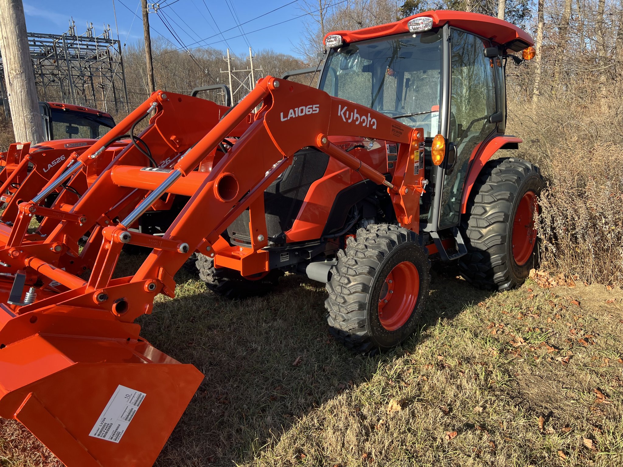

Appreciate all the feedback. While I closed on the property back in July, I’m not officially moving in until May 2025, so I have a little time to do some research on getting a bigger tractor. Just for kicks I drove by my local Kubota dealer. They are a very small dealer and rarely have any new tractors ‘in stock’ but they did have an MX5400 cab tractor in the back. Nice machine. Just a dumb question, if you put a backhoe on that tractor, does the seat just pivot inside the cab? Or can you not get a backhoe with a cab? Sorry if that’s a dumb question.
The only other non-B series tractor they had was an M62. That thing was enormous! It didn’t have a cab but it did have a backhoe. A monster tractor, lol.
I really liked the MX. not sure if it’s too much tractor for me, but it definitely looked like a serious machine

Here is the MX they had
I think a lot depends on the property itself and what you plan to do with the machine and expectations / how quickly you want to do the work vs the amount of acreage.
I am not sure about the cab / BH question, but I can say in a ROPS, the BH92 has its own seat.
Nice shiny MX would look nice with a bow tied on it next to the tree….just sayin’🎄.

The MX is a perfect size for many things, and it’s quite nimble for its size. I doubt that it would be too much tractor for your needs. IDK about the compatibility of the cab model with the 92 backhoe.
