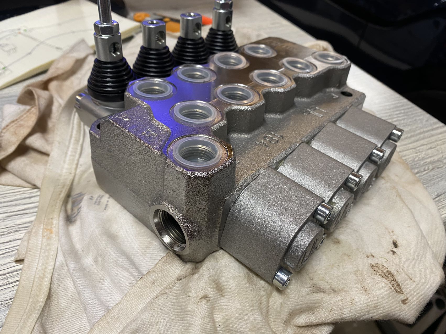

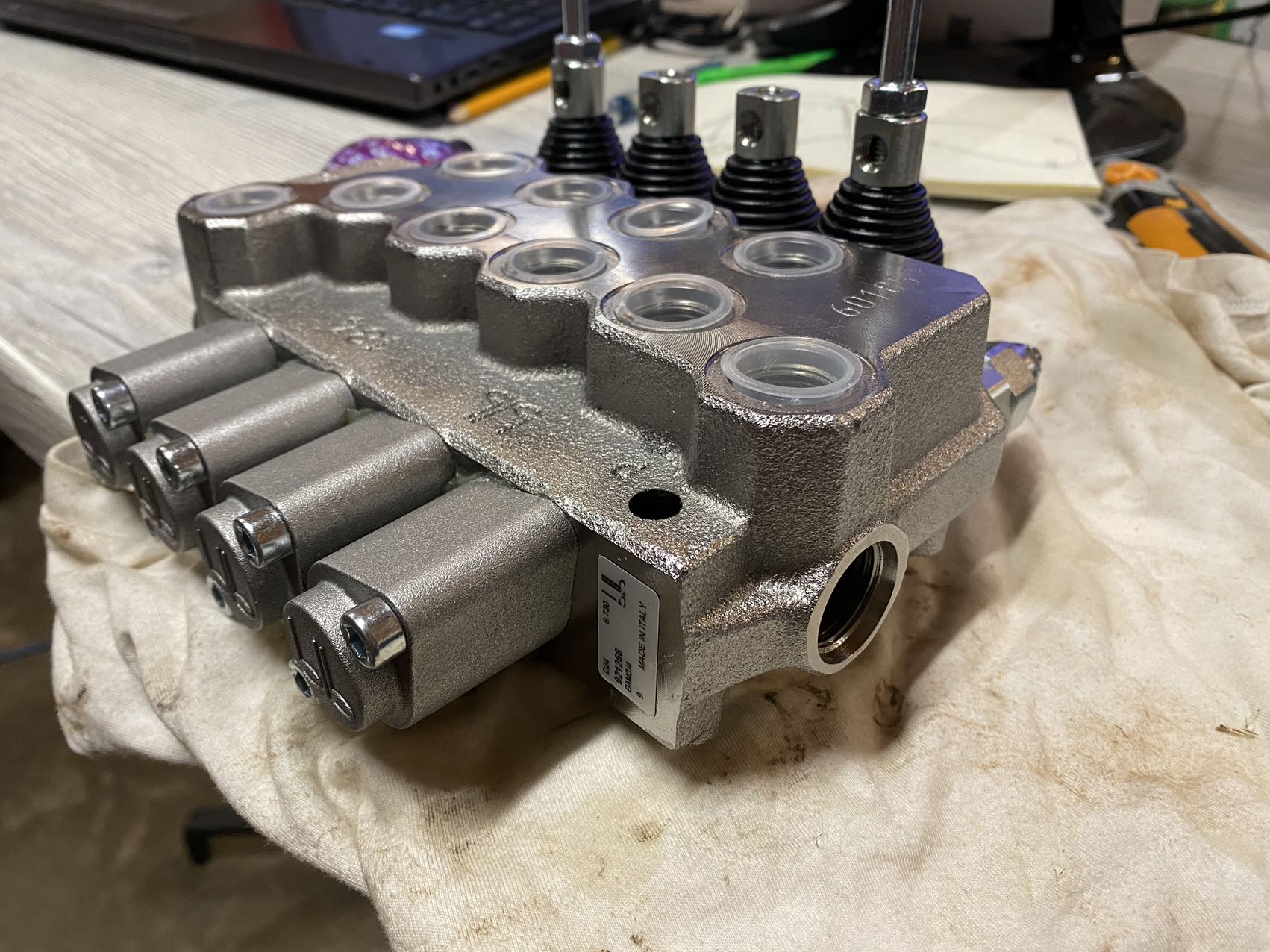

I bought an valve in a local store, it looks good, similar to the Amazon and summit valves,
But when I planned to simulate the installation, I found that most valves on the Internet have P, T, and N, usually T has two identical interfaces,
But my valve has only one P and two Ts, it seems that there is one N missing,
Looking through the instructions, it seems that the function of the T on the side is N,
That is to say, this valve has only one T on the front, and the T and the side suspected to be N are connected internally,
Higher integration? Is it really possible?

I believe you MUST install a power beyond sleeve into one (either one) of the T ports to provide the power beyond to the next valve in the system.
33,391
8,704
If your using it on a Kubota you need power beyond adapter.
It installs in the side port. ;)

The N port on convertible valves is internally connected to both the tank (T) and neutral (N) cores. The conversion sleeve or plug simply isolates the T cores from the N core. Only one of the ports is machined for the plug or sleeve. You do not have a choice.
The number and location of T ports varies with casting design. Summits casting has two, your valve has one.
Follow the instructions for your valve.

Yes, I just carefully observed the inside of the P and T interfaces. The P is simpler, while the inside of the P and suspected N ports is more complicated, with multiple spaces and channels. Your knowledge is so rich.
