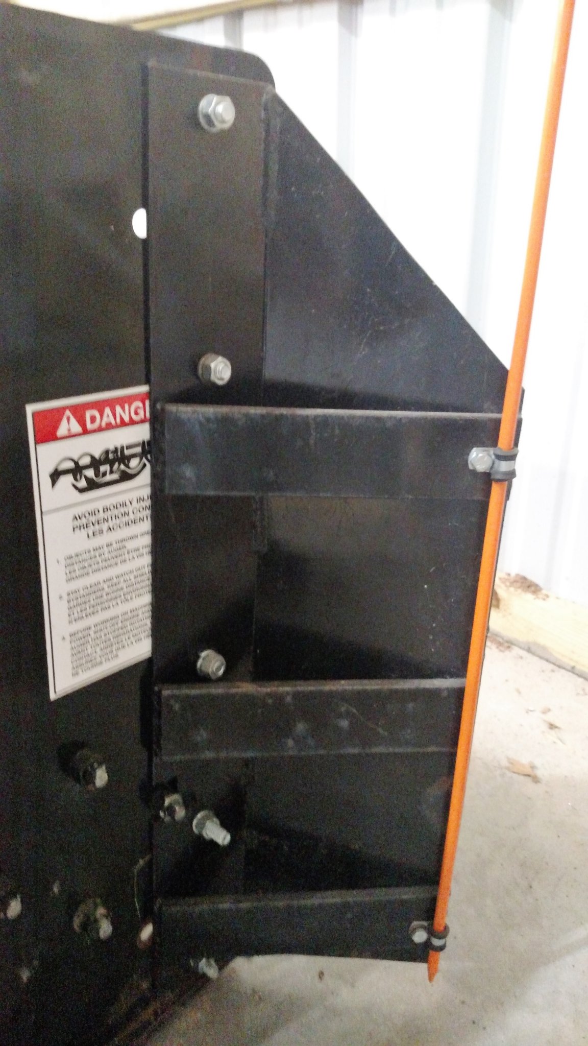

BMBlank, If you would like your blower to be a bit wider, you could fab up some wings. I did that for my push type one and they were rugged and performed well.

I've seriously considered it. Realistically, it does everything I need it to do already. Being able to widen the road a little bit more at a time would just be icing on the cake.
I need to put an electric chute rotation on it before I worry about making it any wider.
