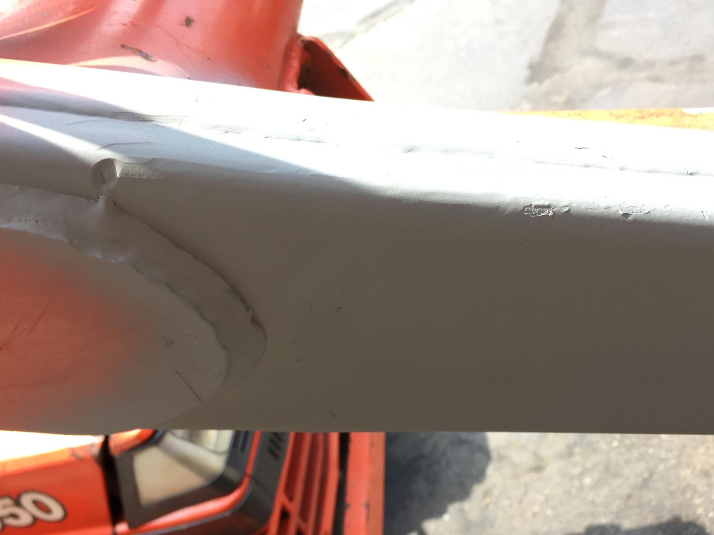

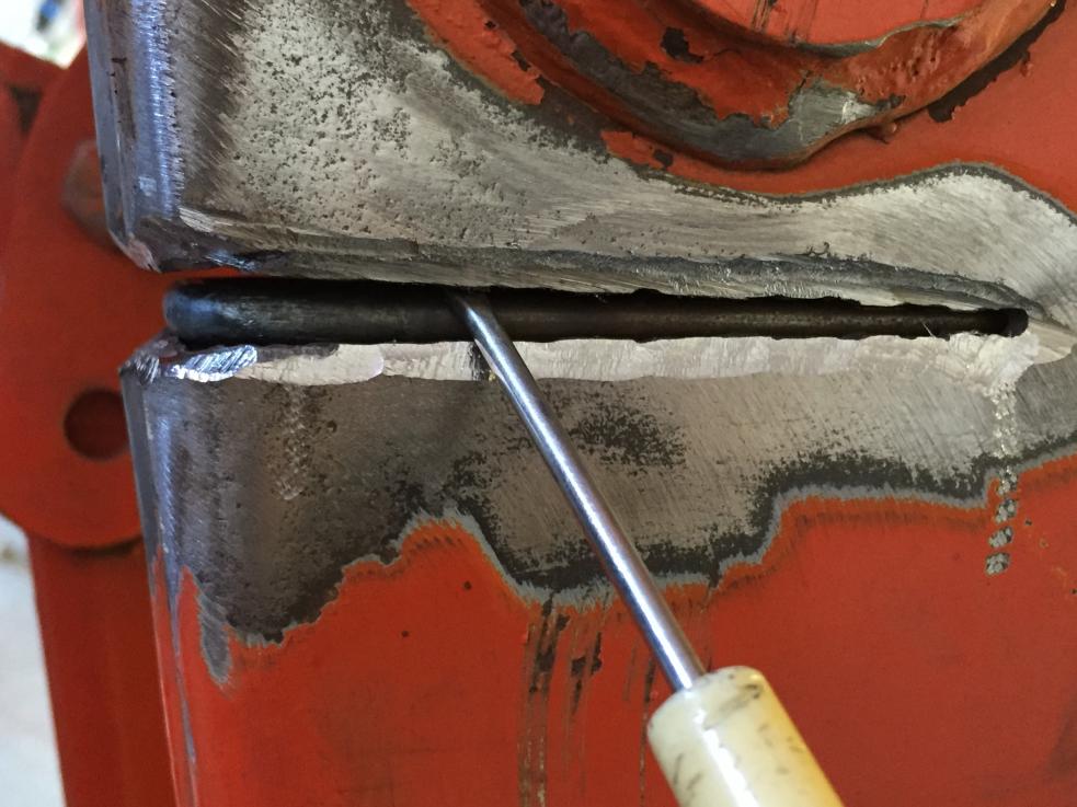

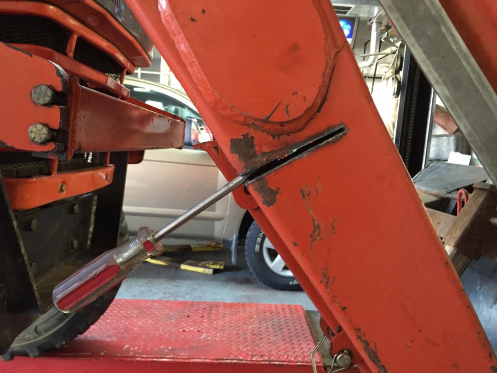

Well, here's how I fixed my 2200hr L3650 w/ a Landpride fel. Last owner must've hit a Stationary object at full throttle in eighth gear. I found the bend in the lift arm using a straight edge. 10 ton Porta-Power wouldn't budge it, and I didn't want to take any further risk of a chain in the face. I may have broken every rule in the book, but mine was so far off I had no choice.
I located exactly where the bend started, you can actually see where the paint flaked off. I cut the lift arm about halfway through with the plasma cutter. I then did my thing with the Porta-Power. I bent a U-shaped 1/4" round stock and put it inside of the lift arm for back up material during welding. Vee'd out the cut and re-welded. I've worked it pretty hard since the repair without issue.
