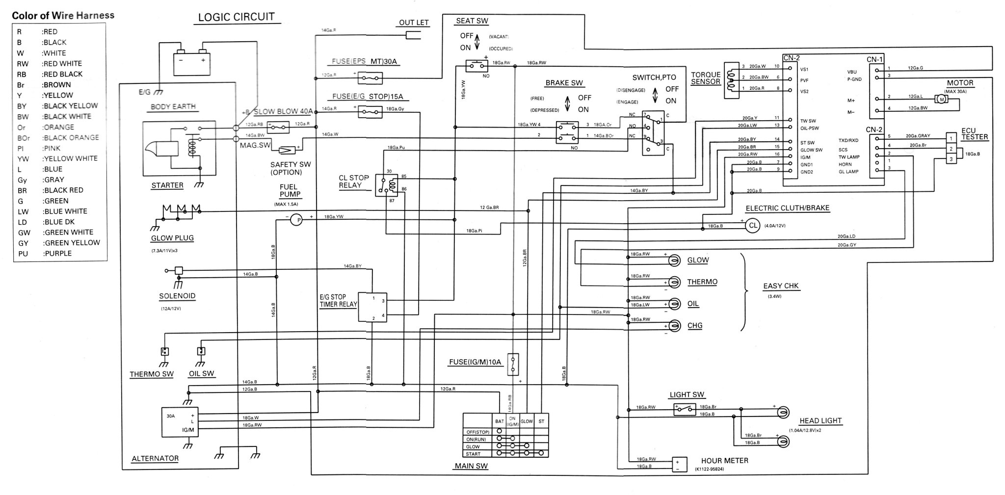

Would anyone know where the Safety Switch (optional) is, that connects the alternator solenoid trigger wire and the brake switch. I cannot find the safety switch or where the white wire goes from the brake switch to the safety switch

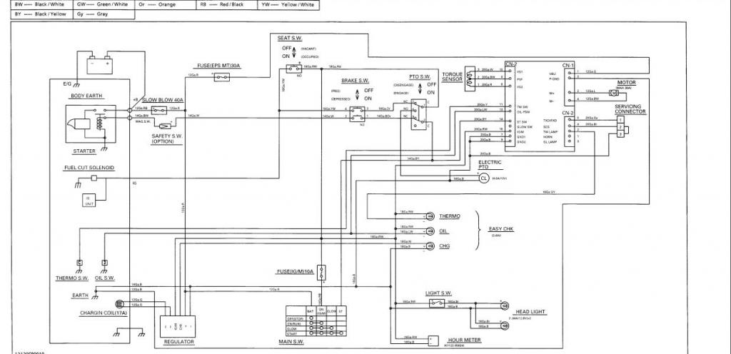

From the wiring diagram, I do not see the optional safety switch tied into the alternator.
Instead, the circuit seems to be from the brake switch to the starter solenoid.
You have undoubtedly spent more time on this matter than I have. Am I missing something?
