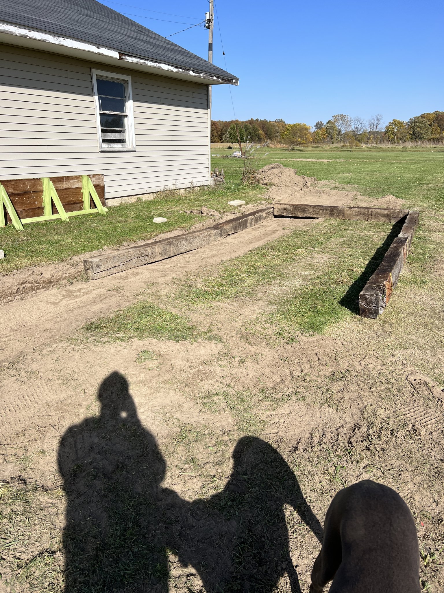

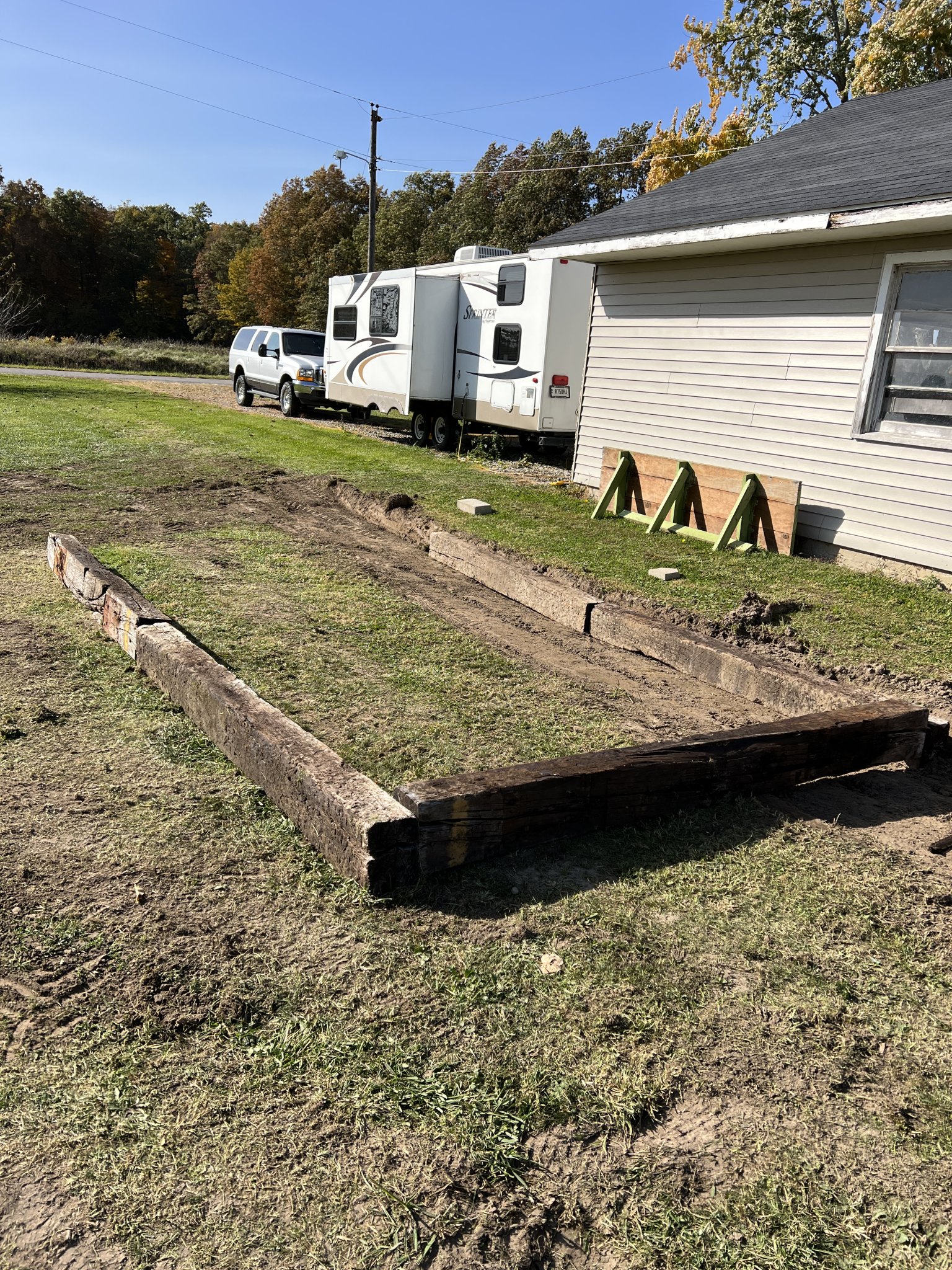

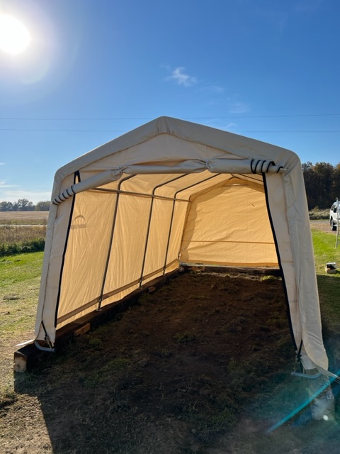

I have been needing some extra storage so I can clear out some garage and workshop space. The end game will be building a pole barn, but that is still 2-3 years off. For the short term I picked up one of these on sale.

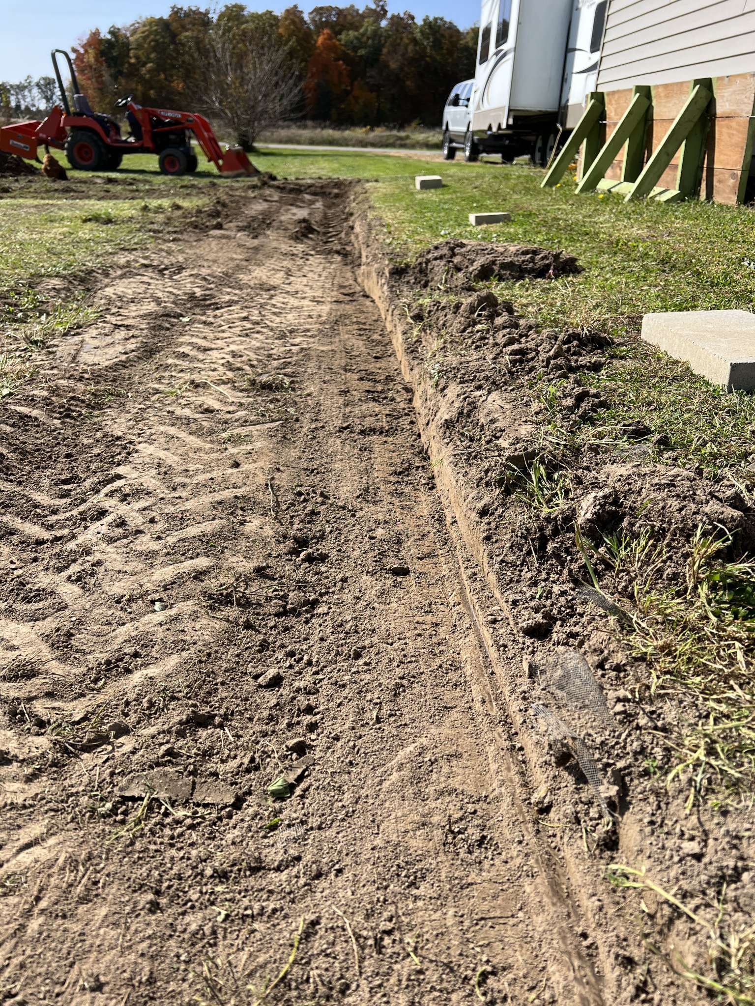

Setting it up next to my detached garage. The ground slopes about 6" where it is going so I had to level it out.
Going to use railroad ties as the edge foundation. Still have to do some shovel and leveling work. I want the ties on the high side a little above ground level so rain doesn't just flood in. The structure will be lagged down to the railroad ties and then I am bringing in a load of gravel for the floor to make it a level surface. Probably bring in about 20 tons since I also want to expand my driveway parking area etc.
Not going to be perfect, but it should serve its purpose until a permanent structure can be built.

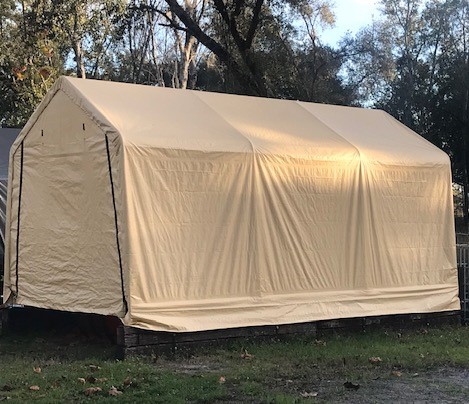

When I put mine up I laid out 4 railroad ties and placed the tent on top of them. This allows the ROPS to pass under the doorway in the upright position.
It has been money very well spent for me.

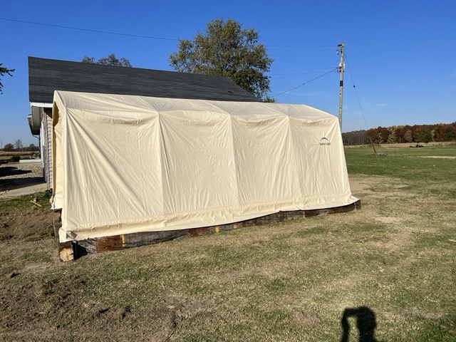

Got this put up yesterday. Not too bad, although the wind made putting the cover over it interesting. I still have to have a load of gravel brought in to fill in the floor.
Hope to get the gravel done this week.
