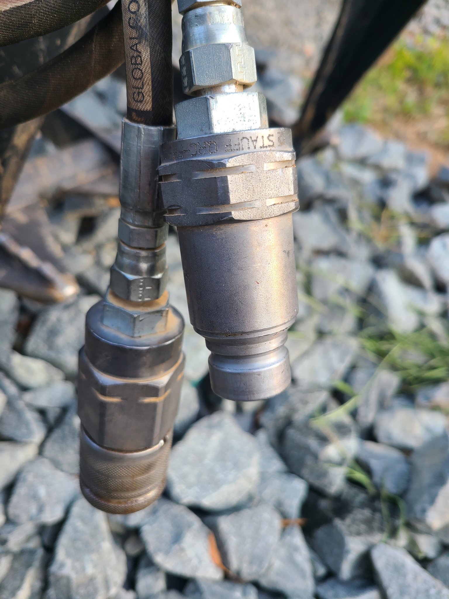

You have Stauff QRC couplers - the size is stamped on the coupler body. Probably -08 which is 1/2".

I think it says -12 but hard to read in the dark with a flashlight.
Looking at their website (don't know why it didn't come up in a search yesterday) it seems that in addition to the FF fittings, I would also likely need bulkhead connectors also. Ugh. Can't be simple. Or inexpensive. But the two never seem to go together. Lol.
Now I'm thinking it would be easier to buy Pioneer fittings for the grapple. Or adapter fittings. Although I don't much like the idea of another connection point.

If -12 they are 3/4 inch body size which would be appropriate for a high flow skidsteer but massive overkill on a 6 GPM tractor. Switching your tractor to 3/4" FF is simple but expensive both now and down the road. ISO 5675 couplers are much less expensive and work just fine.
The hoses look like they have JIC swivel ends. If you really want FF couplers on your tractor buy two sets of 3/8" (-06) couplers from Summit.
Install one set on your loader and use the other set to swap the -12 couplers on the grapple out. When done put the -12 couplers back on the borrowed grapple and keep the -06 set for use on your grapple

I couldn't find them on Summit but I found these which I think I could swap onto the grapple. Then I wouldn't have to change anything on the tractor and would just drop his FF back on later. According to Stauff (second link down) they are the same 3/4- 16 thread although they say UNF thread. The ones in the link are called out as ORB, but if I vaguely remember that's the same‐ no taper o ring sealed. I'm going to call them to confirm.
Stauff part

ALL 1/2" (-08) SAE oring boss (ORB) fittings have 3/4-16 UNF threads.
Here is a link to Summits 3/8 flat face couplers with 1/2" ORB ports. Their description is a bit confusing but the part drawing is not.
Here are their 1/2" ISO 7241-A couplers with the same ports. The half inch body size ISO 7241-A and ISO 5675 couplers will interchange. Other body sizes do not. Just FYI all of the 3/8" Kubota (actually Faster) couplers on your loader are ISO 7241-B and will not interchange with anything else.

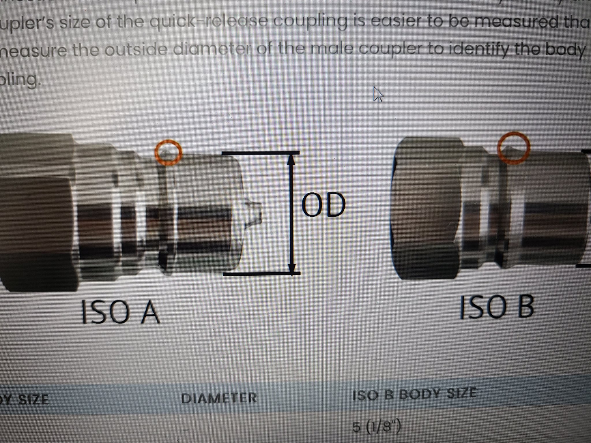

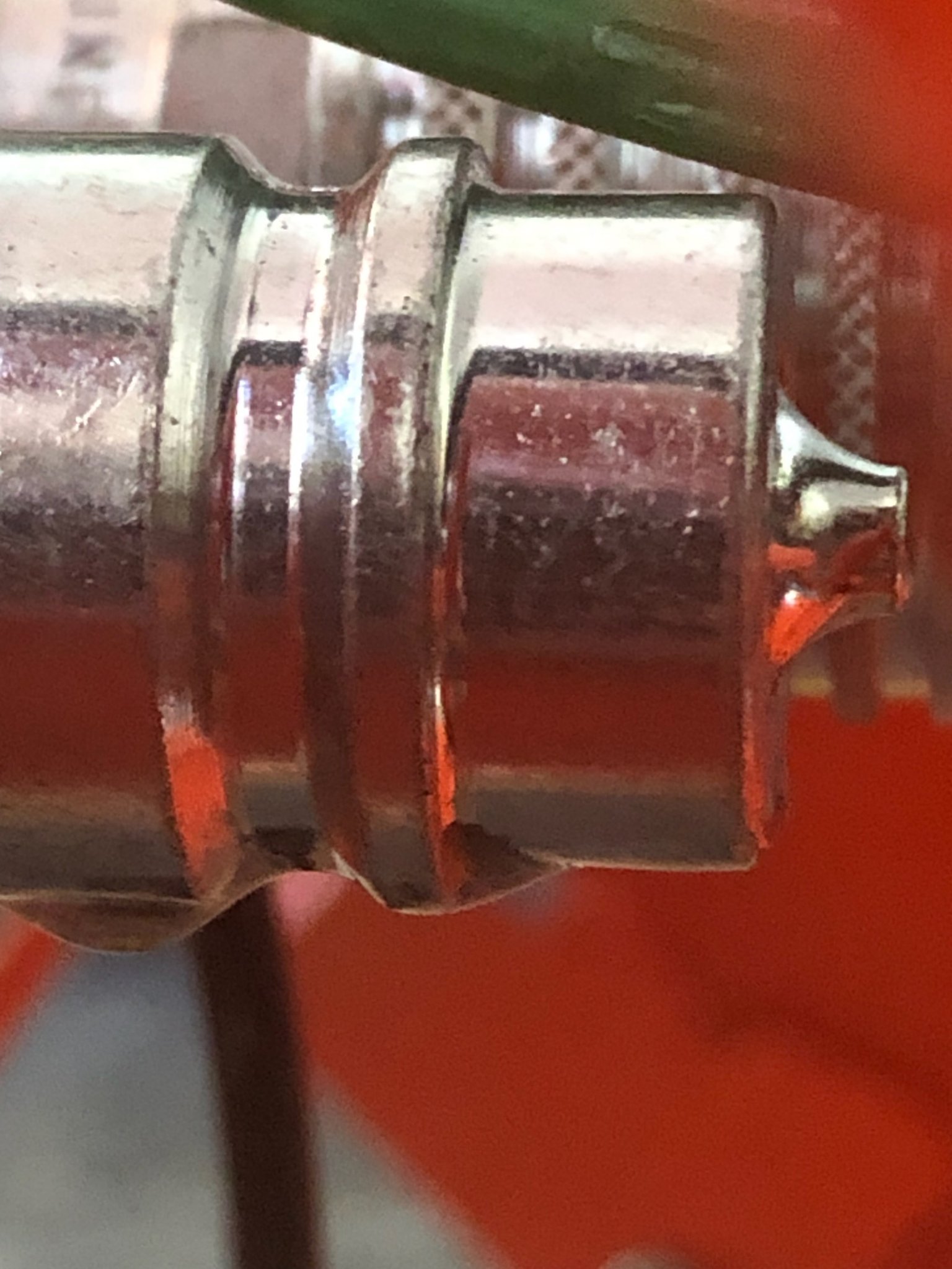

So, they are-B? They sure do look like -A on mine. Definitely not a angled collar.

So, they are-B? They sure do look like -A on mine. Definitely not a angled collar. View attachment 87482 View attachment 87483

All I can tell you is the Kubota couplers on my LA525 (which I assume is what you have) are Faster HNV's which are definitly ISO 7241-B. Quite common on mobil equipment. Third party couplers like Land Pride are often ISO 5675.
Regardless of that ISO A couplers (7241-A) will only interchange with ISO 5675 (what you want to call Pioneer) in the 1/2" body size. If they are in fact ISO A they will onliy interchange with another ISO A coupler. They will not interchange with a 3/8" ISO 5675 coupler.
If you want to avoid problems look up the OEM part number stamped on the coupler to get a positive ID.
