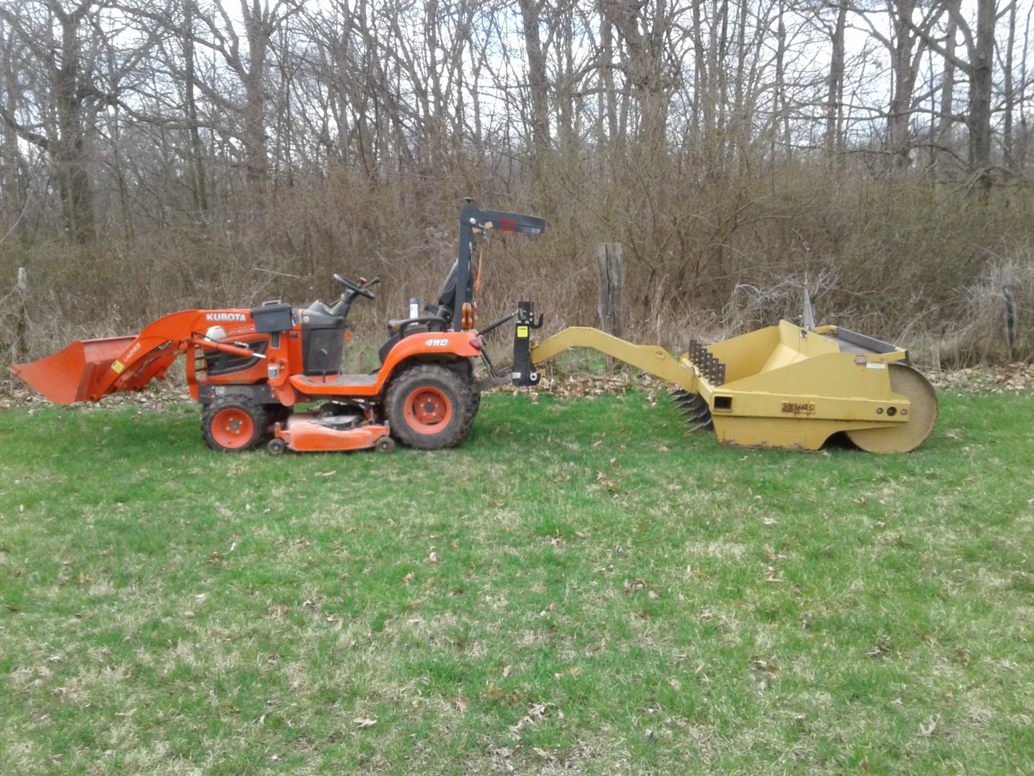

Mowing with the BX2370: When mowing thru standing water, I shift into/out of 4wd on the fly. However, I can use this roller a few days later if needed.
Yeah sort of a redneck
Wow, that is a really cool device. Combo box blade and roller?
I can not imagine your being able to use it with a BX for much more than a roller though...not enough weight/traction to accomplish real work. With my BX pulling my 5x8 dump trailer with ton or more of dirt in it, I soon lose traction if going up a bit of a slope...
Does a number on mole hills & runs. Have 40gal of hydro oil in drum as a rust retardant. 2 larger tractors to "work it" weighs around 1 ton. Small roller about same weight.
