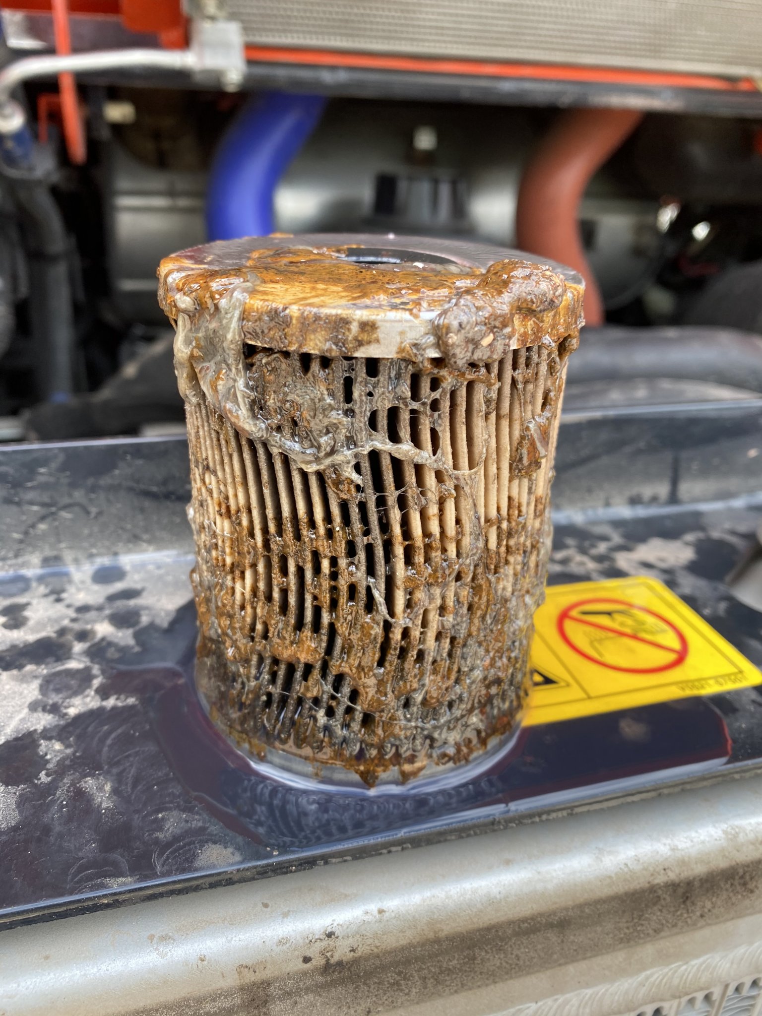

I have searched and searched before posting this and can’t find anything that discusses this exact issue. I recently purchased 200 gallons of off-road diesel from a friend of mine. I find out later that have been sitting around for about six months. Started having problems with the machine and got codes 9309 and 9310. Started reading around and found out it was exhaust gas temperature not specified and starter deactivation. Started looking at the fuel system and the fuel separator was completely gummed up so I changed the filters. 9309 and 9310 went away but the 9302 code started coming up. So I figured I had something stuck in the fuel system took apart and cleaned everything including the fuel pump all lines filter housings. But the code keeps coming back up. Any help would be greatly appreciated

Have you cleaned out the fuel tank? The filter looks horrid.
Typically, the E:9302 error code is from low fuel pressure caused by a restriction before the common rail fuel pump.
Remove the LH rear cleanout plate below the fuel separator. There will be 2 hoses there, one has a plastic plug at the end of it. That is to drain off the bottom of your fuel tank sump. Remove the plug and drain off some fuel into a clean catch can and see what you have got.
You can also take the supply hose from the inlet to the separator off of the 90 deg elbow and pass it through the clean-out opening and let fuel-free flow from the tank. It should have a full, solid stream.
You also will need to check your new separator filter to see that it is not plugged again.
The spin-on filter on these machines is 5 microns, it does not take much contamination to plug them.
