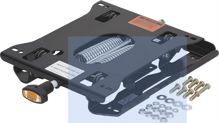

I installed a Trac seat suspension on my zero turn, it helped a fair amount. Certainly not an air suspension but the price isn't crazy.

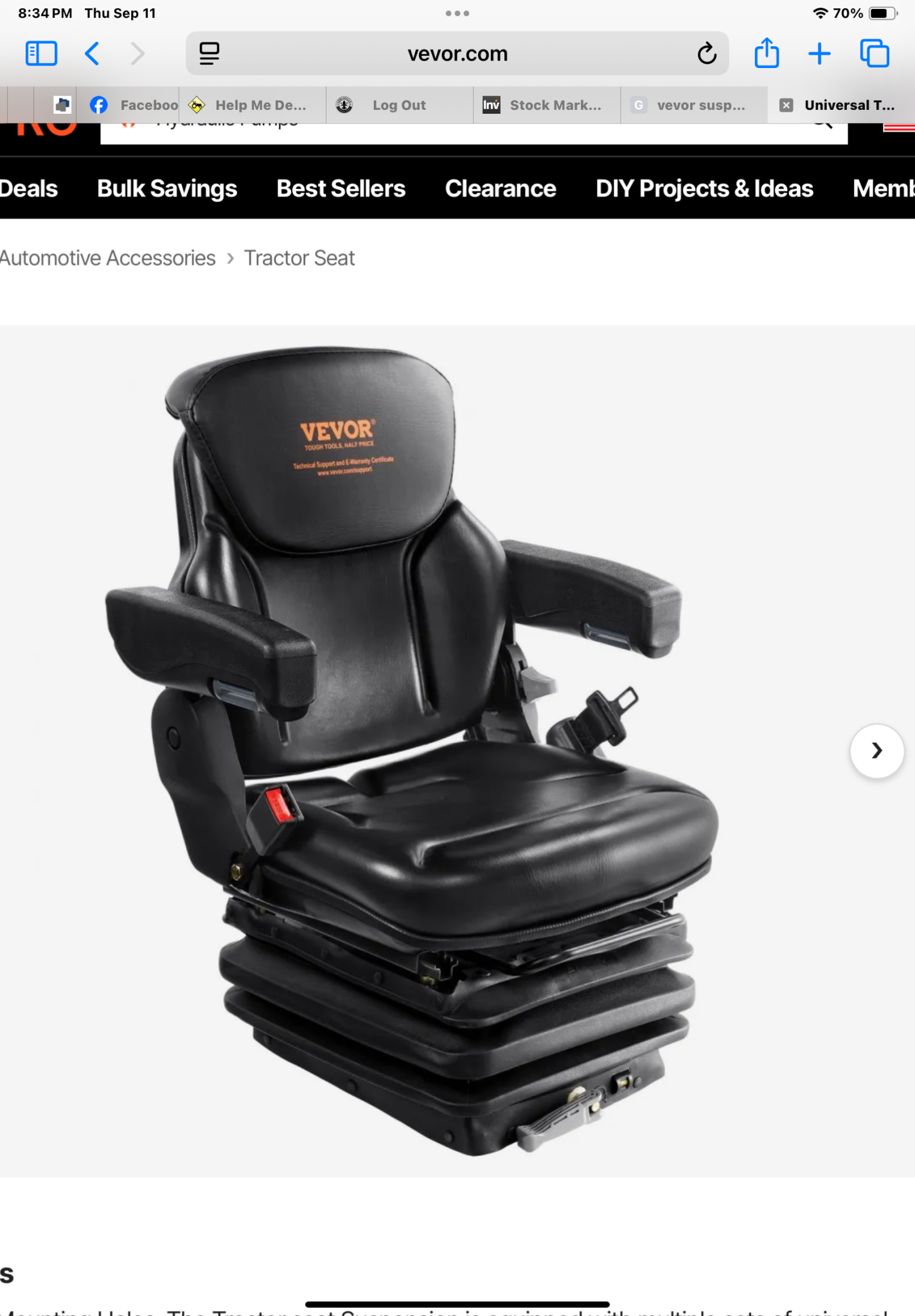

I recently put this one on my ancient Great Dane zero turn. It helps a lot, but it sits quite high, I set it to the lowest position and added 1-1/2” (wood) to the foot rest deck. I’m not tall, 5’8” on a good day. I couldn’t hardly stand mowing anymore due to a bulging disc, and I cut a lot of grass. Other than the higher seating position, I’m pretty happy With it. It was about $250, Vevor.
34,369
9,597
I just did mine, a real kidney saver!
I picked this one over the one @lynnmor posted just because it clears the safety switch in the seat.
I installed one of these on my Ariens IKON XL60 shortly after purchasing it. If there was any improvement in the ride it was very little. I have watched videos on comparisons between non-suspension zero-turns and suspension type like the Ferris and even they were not much better. Have come to the conclusion that I am better off trying to remove the bumps on the lawn rather than trying to improve the ride of a zero-turn.
Did you adjust it for your weight? It needs to be adjusted to a point where it won't bottom or top out, then it will improve things over having a seat mounted solid.
I sure did! Tried it at various points as well.
