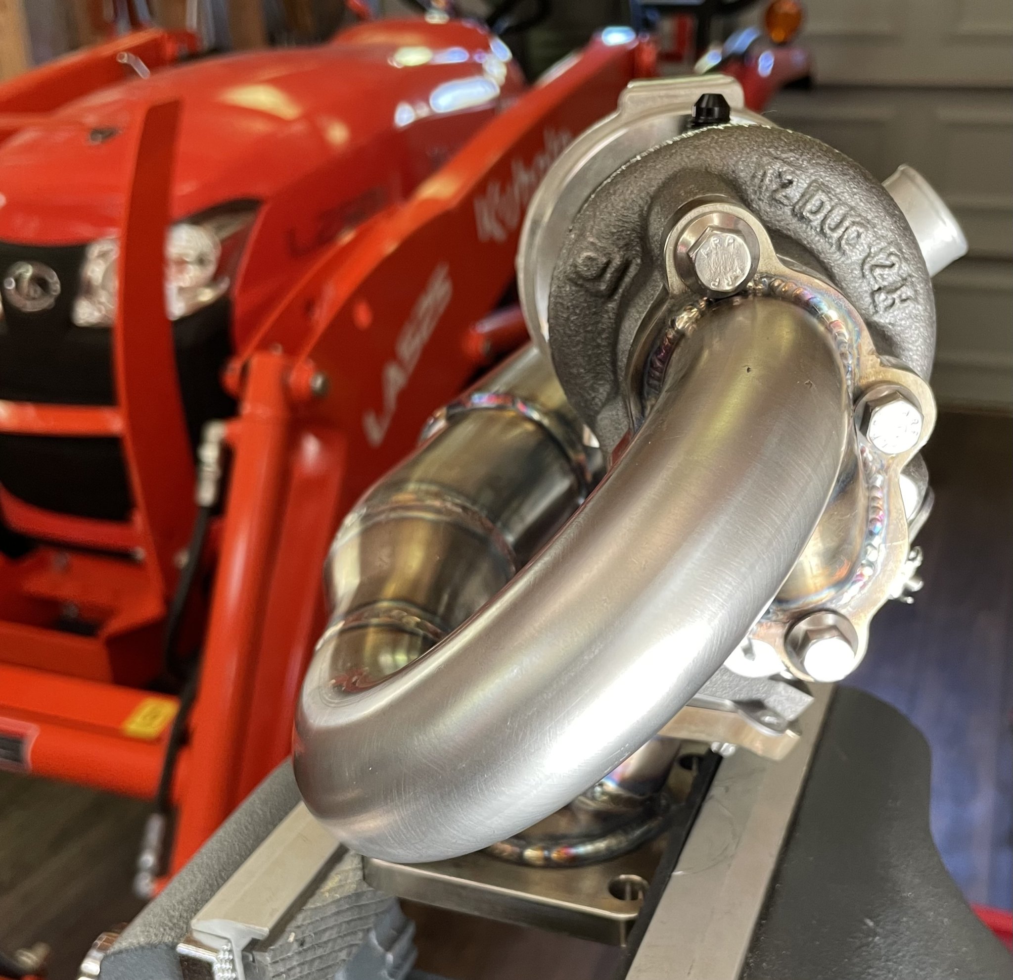

That’s fantastic! My Turbocharged L2501 has been super reliable and running like a beast!
Likewise, I turned up the fuel a bit and this 25HP tractor is now producing a dyno proven 44.1 HP and 35 PTO HP. Couldn’t ask for anything more!

Wow Mike, that’s a good looking kit sir!! Piping looks incredible, nice job. What turbo are you running if you don’t mind sharing. I tried 3 different ones in total, using cheap chineasium things untill I found what I wanted. Ended up with a
MHI TD025, the Chinese one made it about 100 hours, so far so good on the real one! Thanks in advance.
Thank you!
After just a couple minor changes….it’s looking even better now!
We’re using a brand new Kubota MHI TD025 Turbocharger. There are less expensive options but, reliability and longevity is our goal.
