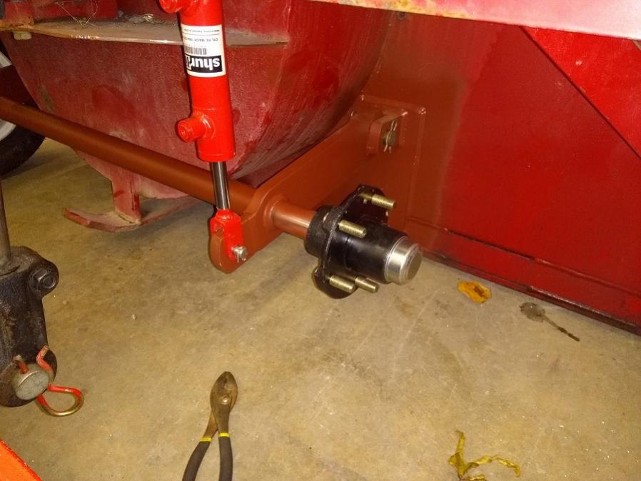

My blower is an inverted type but my wheel fix would be appropriate for any style. I blow on a lot of gravel and ground.
I use a selector valve to provide a hydraulic circuit to adjust the wheel height but it could be done manually.

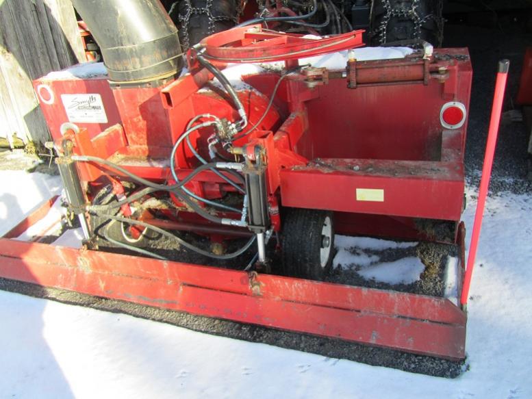

With almost 500ft of gravel driveway, I modified my front BX2750D blower with wheels at the back side, to allow elevating the cutting edge. The main benefit is that the wheels "roll", whereas skids dig into the gravel (until frozen).
With the wheels, less stones, less shear pins blown. Once you have a compacted base, I raise the wheels so the blower edge is flat on the ground.
One problem with wheels at the back of the blower is that eventually it creates "waves" on the ground due to the fact the wheels and the front edge are at different distances, causing this effect. Not too noticeable until near the end of the season... Nothing a back blade can't fix....
Similar issue would exist for rear blowers. Skids just dig into the gravel, thus lowering the cutting edge into the stones. It gets worse because the skids actually dig up the gravel, which gets sucked into the blower.
