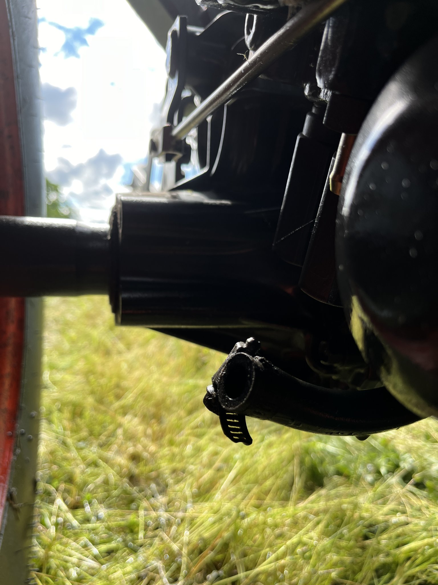

I have a B2620 and was mowing some taller grass with a belly mower, elevated up high to keep it from stalling out. All of a sudden it stopped moving and I also lost hydraulic for the bucket, power steering too. "Suddenly" was before I noticed a wet trail behind the tractor so I am guessing some plug came off without me noticing (I am hoping it is just that and not a crack anywhere). Still has oil. I found what the manual says is the transmission fluid level stick (0184) but I could not pull it out and did not want to risk breaking it. More than happy to use more force to see if that is showing empty.
The top of the belly mower and the pto shaft to the mower are wet and the 3 plugs from the manual look in place. It does seem to be more on the right side, looking at the slick tracks in the grass. Any thought on where to check first/if there are more plugs to check?
I was also wondering if it was ok to tow the tractor using a chain in neutral. My only tractor so I was thinking of dragging it forward slowly using a chain wrapped on a ball hitch while it was in neutral to get it out of the tall grass but is that advisable when it is in neutral (going about 400 feet)? It has one of those 'drive over' belly mowers so may need to back it up the same to take off the belly mower to get clearance to look under the tractor.

What is this?

That yellow plug looks a lot like something on my B2910 tractor. It is in my case the filler for the hydraulic fluid. Again in my case, it’s hard to get that out because it has a O ring around it and when you put it down into the hole, it fits pretty tight. I’m not able to pull that by hand, but I am able to pull it out if I, put something under the Ridge on the top end, and lever it up while pulling with my fingers.
If you lost hydraulics and have a pretty good stream of oil leakage behind you, chances are pretty good that you lost something in the hydraulic fluid path.
I would guess, but I don’t know so wait for somebody that knows to answer, but my guess would be that if you put the gear selector into neutral, you very likely would be able to tow the tractor back to wherever you wanted to without risking damage. Again, let somebody really knows give you some advice on that.

curious !! I NEED to know what the rubber hosed and gear clamp are for (didn't see in online parts..... )
12,714
5,521
THAT does seems to be the problem !!!
Gear clamp doesn't look 'factory'.
If possible, cut hose a bit shorter and use new SS clamp. 2 if possible(a left and a right).
Then check oil level, add as required.

pretty sure hose is #200, clamp is #210
when reinstalling be sure clamp is ABOVE the 'barb' when you tighten it down.
looks like a simple fix.....fingers crossed !!

I wonder if it is a return line, with just hose clamps

my guess is it's the return line from the loader ?
heck 'rubber' hose wouldn't have PRESSURE in it...maybe little 'p' pressure ?
