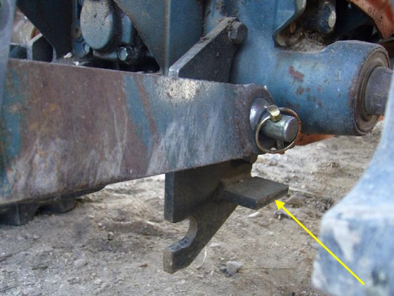

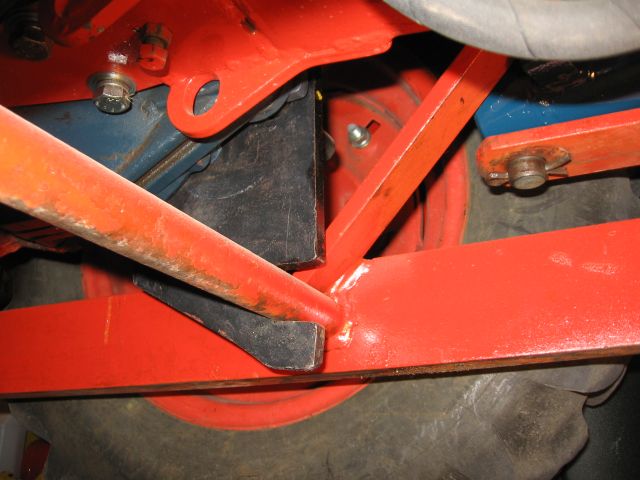

No dimensions, (tractor is 150mi from here) but here are pics of the B219 FEL subframe for a B7100.

Few pics of the subframe on a L series with the BH77

good pics, thx. What gauge is the sub frame? 3/8"? 1/2? Any chance you'd do some measuring? (distance between brackets, distance between pin rest and pin hole, height from ground, how far the top hole is offset from the lower pin rest, width of top hole sleeve) - it would be greatly appreciated.

Yes, but it will probably be tomorrow. Have to go to work today, but off the rest of the week.

This is width of subframe from outer boss on both top pin holes about 21 7/8.
Top pin boss about 1 5/8
These are the back itself
From center of bottom pin to center of top pin hole about 12 1/2
1 1/4 pins
Trying to eyeball the offset from top pin hole to bottom pin is about 3 1/2
Subframe is 1/2 inch

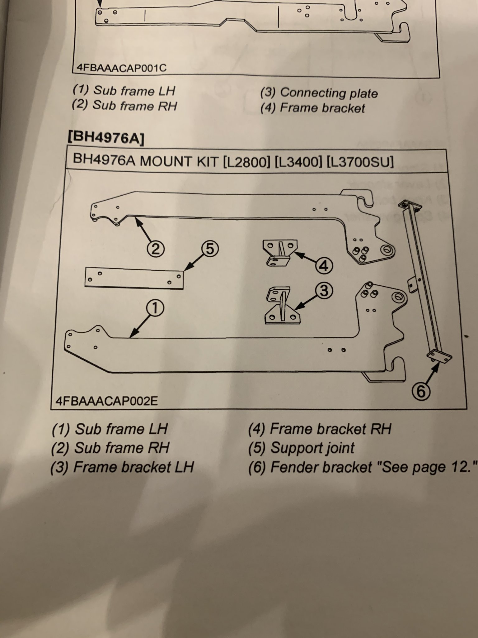

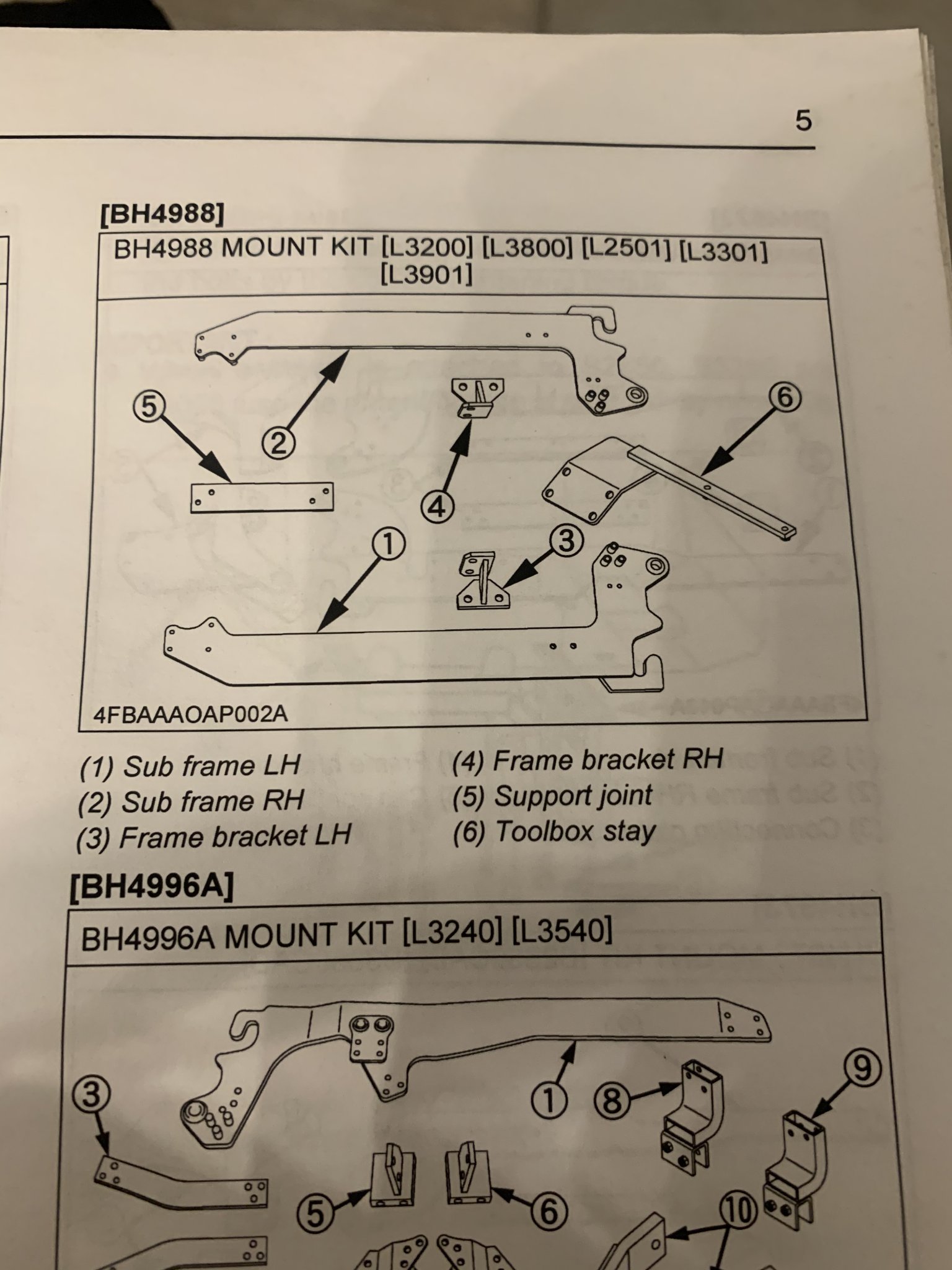

I have a 2002 L3000 Dt, I appreciate your post, recently bought a BH75 and need to make the subframe. I don’t know how to get around the axle yet?, does it only attach plate to plate with the angled portion of the ROPs
It attaches to the ROPs at the rear, has a little bracket that attaches to the axle housing, then attaches to the loader mounts at the front.
Not sure if these will help any, this is for a BH77 and the later L series then yours.
Im not sure of the differences between the BH75 and the 77. I recall another thread about this, not sure if it was a BH75 or 76 tho. I will try to find it and post back.
