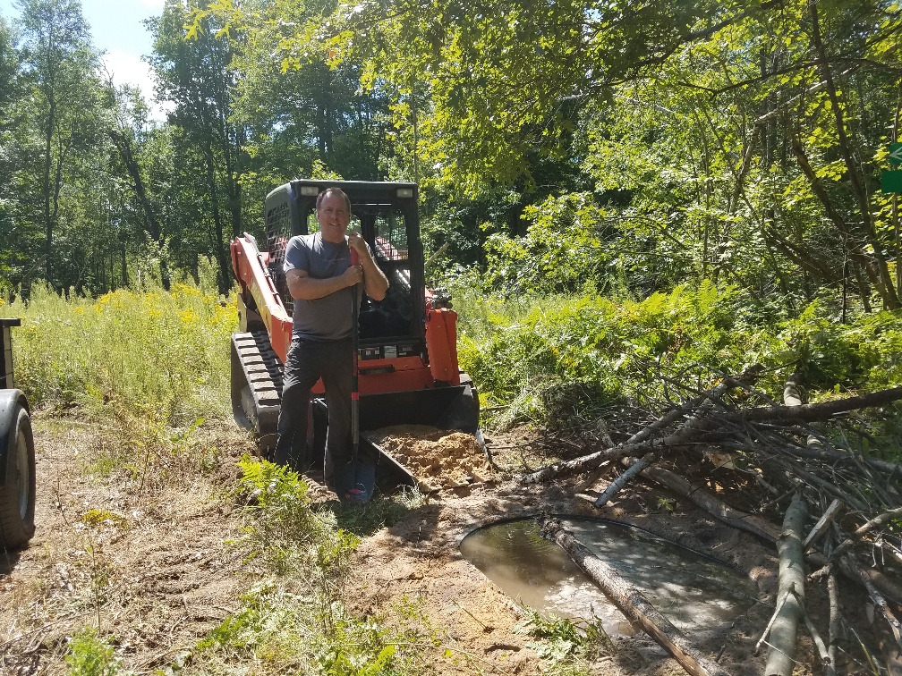

I have a Titan Extreme HD Stump Bucket, I occasionally used it on my MX5800 up until I purchased a Kubota track loader SVL75. At about 500lbs this unit is meant for large tractors or skid steers / track loaders. It will do serious work on a track loader. I would not dream of putting this on my L series tractor.
I don't own the lighter weight version stump bucket (150 lbs) but have to believe that this would be a great addition for your L2501 if you plan to use it occasionally for stump removal or light trenching as you describe. Trench digging is not as neat with the angled bucket on a FEL.
The other option is to rent a mini excavator for a weekend, you will get your work done much quicker and cleaner in terms of making a nice trench. I have to admit I typically like to own these attachments as I use them over and over again. The tractor is just the beginning and eventually every tractor owner gets attachment fever ...lol.
I recently dug a couple of water trough holes with my heavy duty version titan stump bucket, it took about 30 seconds a hole!

I View attachment 64423
Appreciate the review! I have thought about renting the mini ex but it would cost 80% of what a stump bucket would cost and you have nothing when you are done except the work it did. Oh yeah, definitely have the implement fever. My wife has told me to slow down. Lol. Looks like I may have to put off the bucket for a bit. Just got the fertilizer spreader this week. Only had the tractor less than two months. Just see all the things I can do on our place now and you get the bug for sure. I think the Titan standard will be the way to go.
