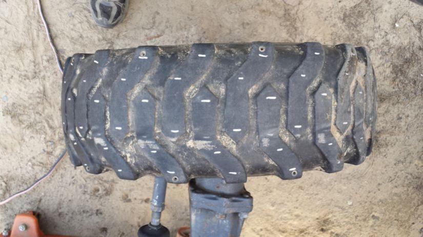

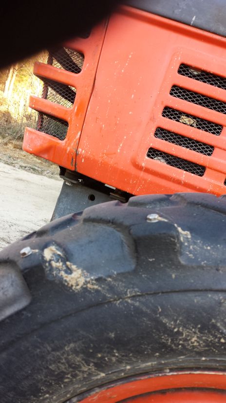

I looked at a lot of different options for studding tires and came up with a simple solution! They sell studs for off road racing that are just hardened screws and they work really well, but they are really pricey. So I came up with a cheaper alterative, 3/8" x 1 1/2" Tapcon concrete screws, they bite really well into the rubber and they are hardened and have tall heads on them.
Oh and you can only do this if your front tires are foam filled!;)
When I got the tractor it had a few screws in it for traction but I wanted a better setup!
Old wimpy setup!
Not much bite here.
Being a perfectionist I had to lay them all out, couldn't just start zipping screws in all willy nilly!
Nice semi random setup.
These should bite really well!
