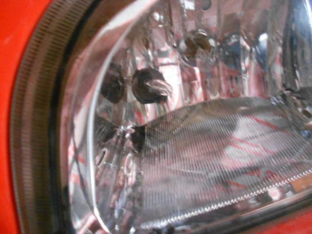

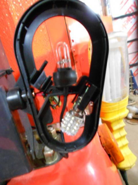

Drilled 1" holes in the headlight lenses inserted strobes, removed one of the two bulbs in each rear flashers. Iam able to use one or both rear lights. Controller came with the 4 light kit, cost was $30.00 give or take a few bucks. Install would take few hours but had to wait for JB weld harden.

do the regular headlights still work without the strobes being turned on?
