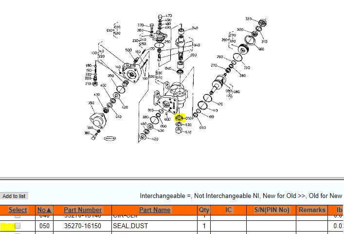

I have a L2250DT and oil is leaking out of the steering box. It appears that all I need to do is replace the dust seal (Kubota: SEAL, DUST, Part # 35270-16150), This looks like a fairly straight forward thing to do.
Have I assessed this correctly?

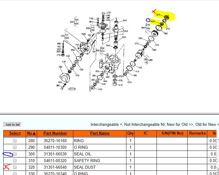

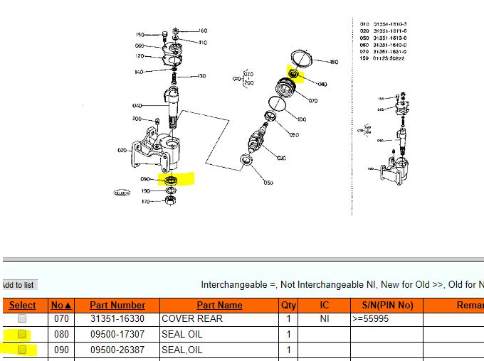

I'll just post the picture since you and your dealer don't believe me.
Go back and tell your dealer to drop the microfiche and get a computer! :rolleyes:
Dust seals do not seal in oil, they are to keep dust out, that seal is not designed to keep oil in, if it was, Kubota would have called it an oil seal.
I'll repeat what I wrote earlier, replacing just the dust seal is most likely not going to fix it, pressure and leakage on the inside O-ring's are the cause of the oil leak before the seal, so a complete rebuild is usually required.
