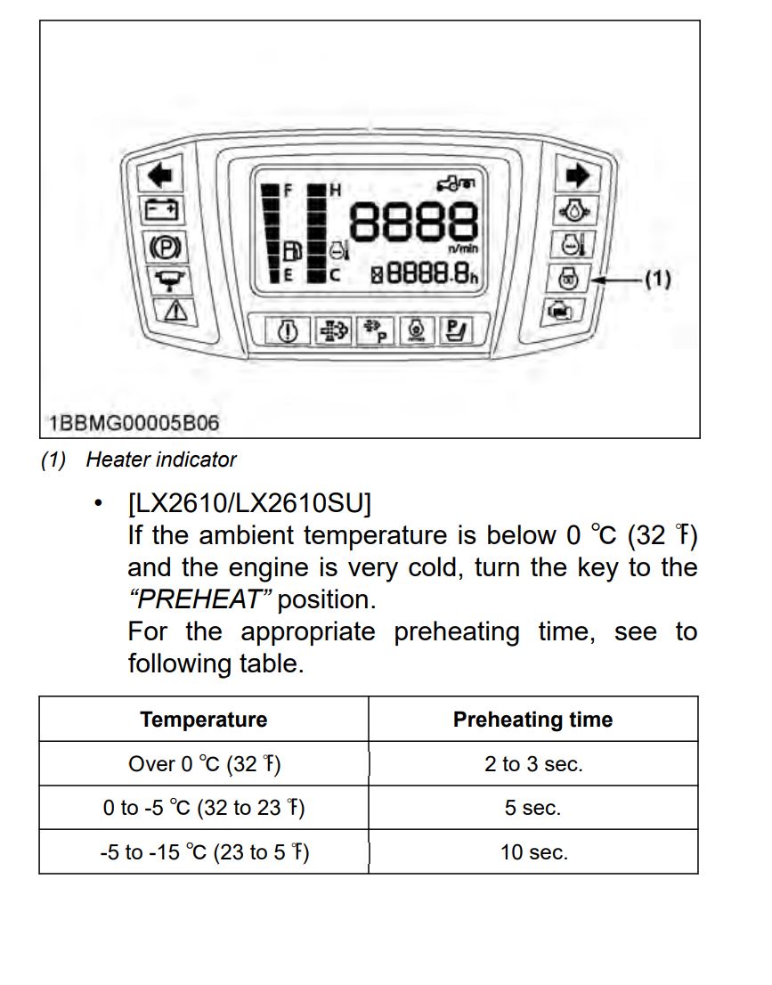

You could have burned out the glow plugs. I believe even the manual says to heat them for 3 seconds if the temp is above freezing, and 5 seconds if it’s below freezing

You shouldn't need the glow plugs for more than 2-3 seconds at those temps. I would call the dealer and notify them of the situation. How long are you cranking it for, what are your night time lows and are you using an anti-gel in your fuel?

And 5 seconds is glow is plenty in above freezing temps.
