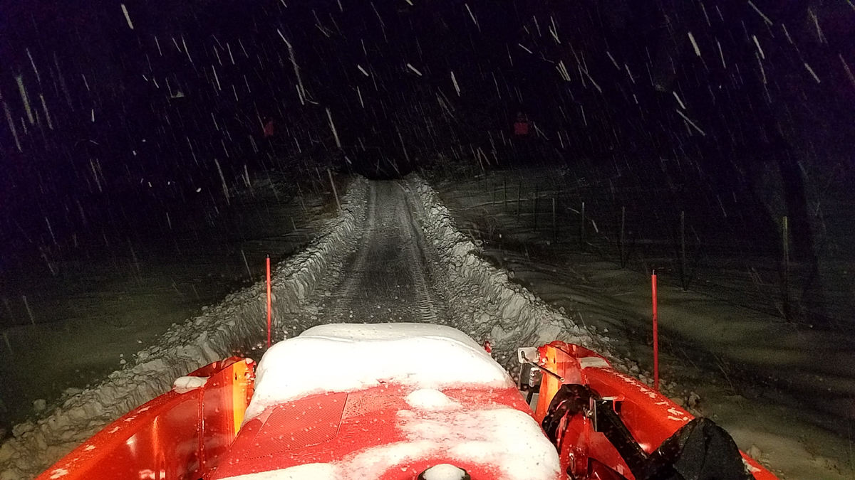

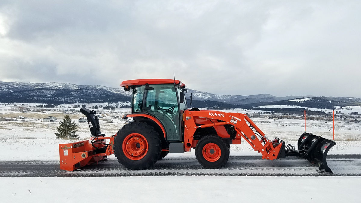

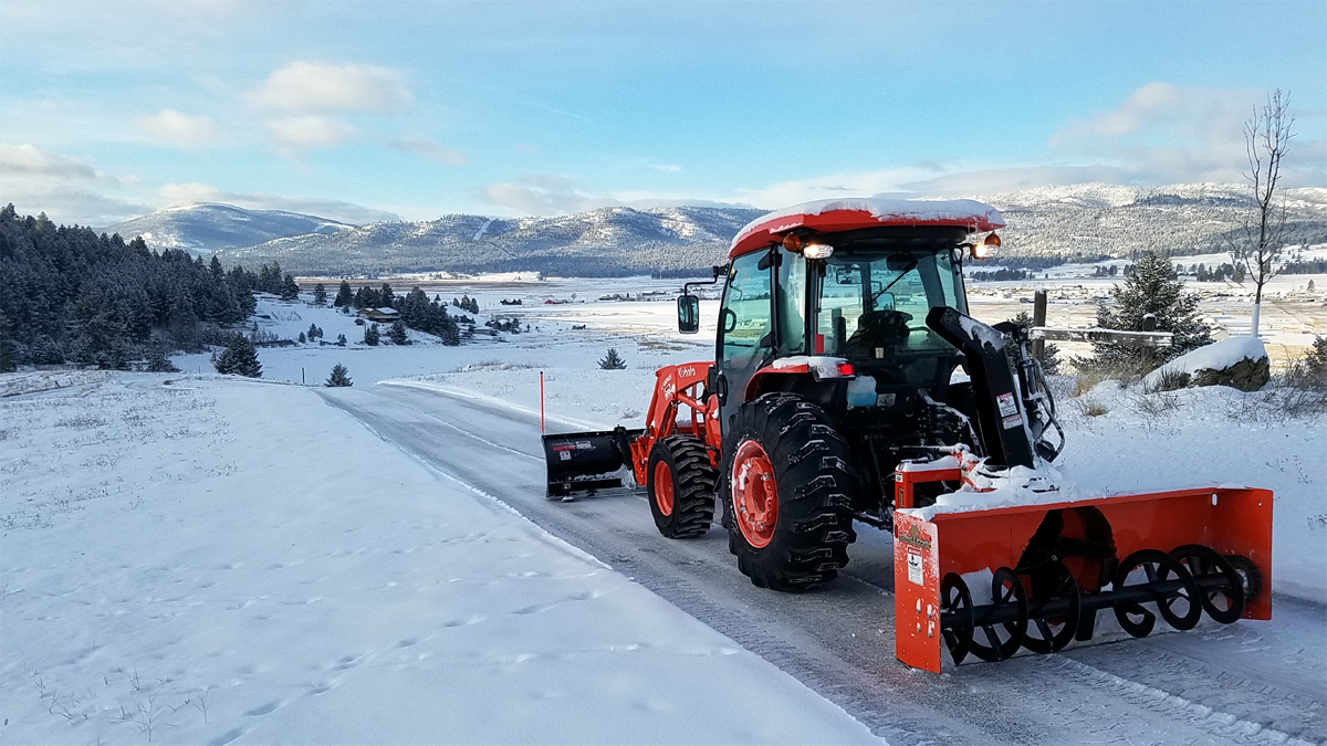

The one I use on my MX works great for what I do. It's an STB1596 and I float the blade and it works well for me. If I try to be too aggressive with the blade and push too much snow, or push snow against something that provides too much resistance then "equal and opposite" and all that. Overall I'm very pleased with my winter set up of a front blade and rear blower.
This is my neighbors driveway a couple of weeks ago. It was all done with the blade, about 300 yards or so.

"Gimme' 40 acres and I'll turn this rig around" Perfect straight line plowing set up.

I have +/- 5 degrees of rotation of the STB1596 blade relative to the SSQA mount to account for small camber changes, and a lot of adjustment by rolling the blade like a bucket.
I have no problem turning around. I raise the loader up to get it over a fence or similar if needed.

Right… good point. Hadn’t considered that curling would effectively adjust for camber when angled. Thanks.

With the plow blade that far out in front of the loader arms what happens to the loader arms if you hit something solid, especially if you hit while the blade is angled. I could see bent loader arms could happen.
