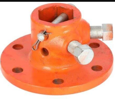

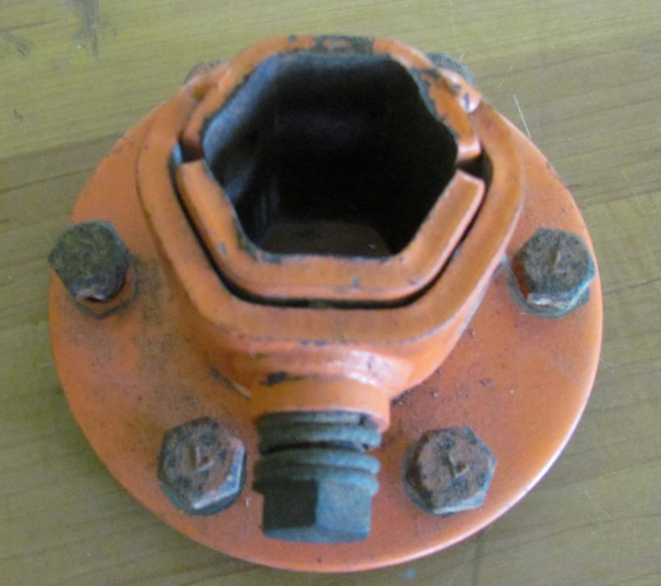

One thing I failed to mention ..... those rear hubs! Jack that machine up and pull top v bottom on the a rear .... loose? Probably ...... MAKE SURE there is a long pin in the hole ..... those hubs will wobble and drive you crazy. There are better hubs.... but they are a little pricey.
Due diligence will help those hubs - and tighting the spring loaded bolt will help too.

I never checked those. I will check them when I pick it up and keep an eye on them. I just priced out the new ones at around $130 per side so if I have to replace them it's not that bad. Thanks I wouldn't even known to check or keep an eye on them.

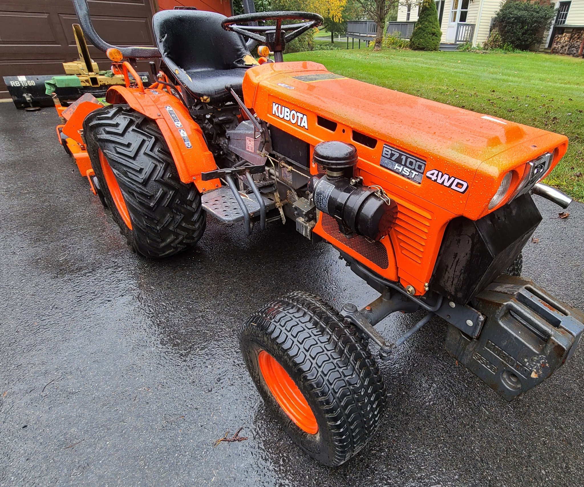

looking at those pictures......... you stole that tractor at the price you paid! That B7100 is really nice :)

Yes, you must keep the rear axle hubs TIGHT.

Nice tractor! It looks like its in excellent shape. I use mine alot, have 2100 hours on it and its never let me down.
