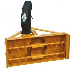

Happy new years folks . I have a 3301HST with a Lorenz double augar blower on the back . A lot of times it seems that its pushing the snow instead of blowing . PTO speed is fine & driving speed is slow . I just was watching my wife using it & if she backs up theres a big pile on one sid with augar marks in it . All the shear bolts are fine . I know we have the blower set a bit high , we have @ mile of gravel road with a hill portion at @ 16 % . Any ideas ? I did some searching cause I knew this had had to have come up before butI got nothing , I probably didn't use the right wording in my search . When it does blow it works great .

I checked the shear bolts when we shut it down last time , will check again tomorrow . We got a bunch of that special Sierra Cement most of the day . I'll wait till it crystalizes over night & then hit it . These blowers have a upper & lower horizontal impeller which pushes the snow into the big fan impeller on the second stage .

I have a lorenze double auger style blower like yours. Real wet snow tends to push and build up behind the blower as mentioned.
If it's due to shear bolts broken....on mine.....it's always the two 1/4" grade 2 bolts that bolt the lower auger to the chain driven sprocket. Inspect them carefully......the sheared bolts can still be in the parts....making it look like they are still good....but need to be removed and replaced.

animals45 View attachment 93253
When the blower is pushing more than it is blowing it is telling you to slow down.
Is this a picture of YOUR blower or just a web picture.
McKee and others from the 1960's made a lot of double auger blowers for John Deere and Kubota as well a selling them under their own name as Snowlander 720.
The second auger did nothing for the performance. It actually made things worse. Feeding the fan faster than the fan could get rid of the snow. Those blowers came with a 3 blade fan which was another weakness.

That is my blower . I'll check the clock on the 2 augars . That makes sense that they should be offset .
