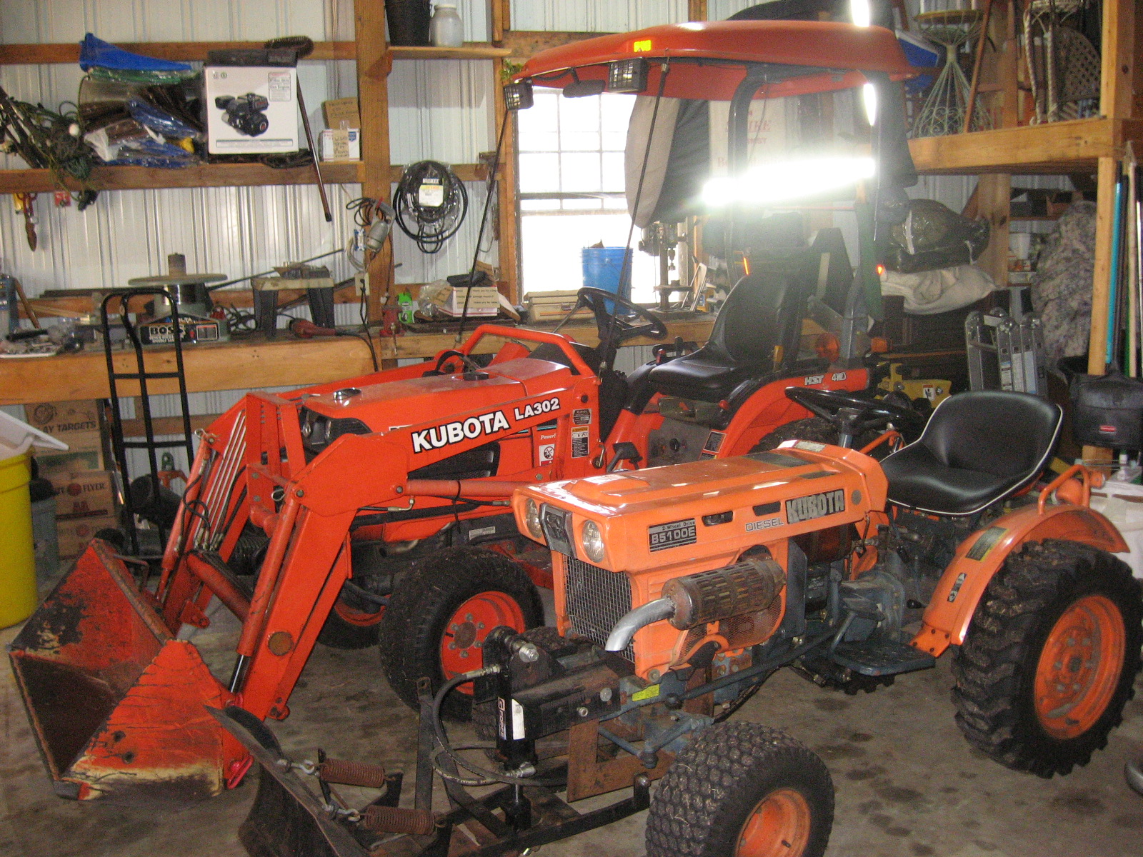

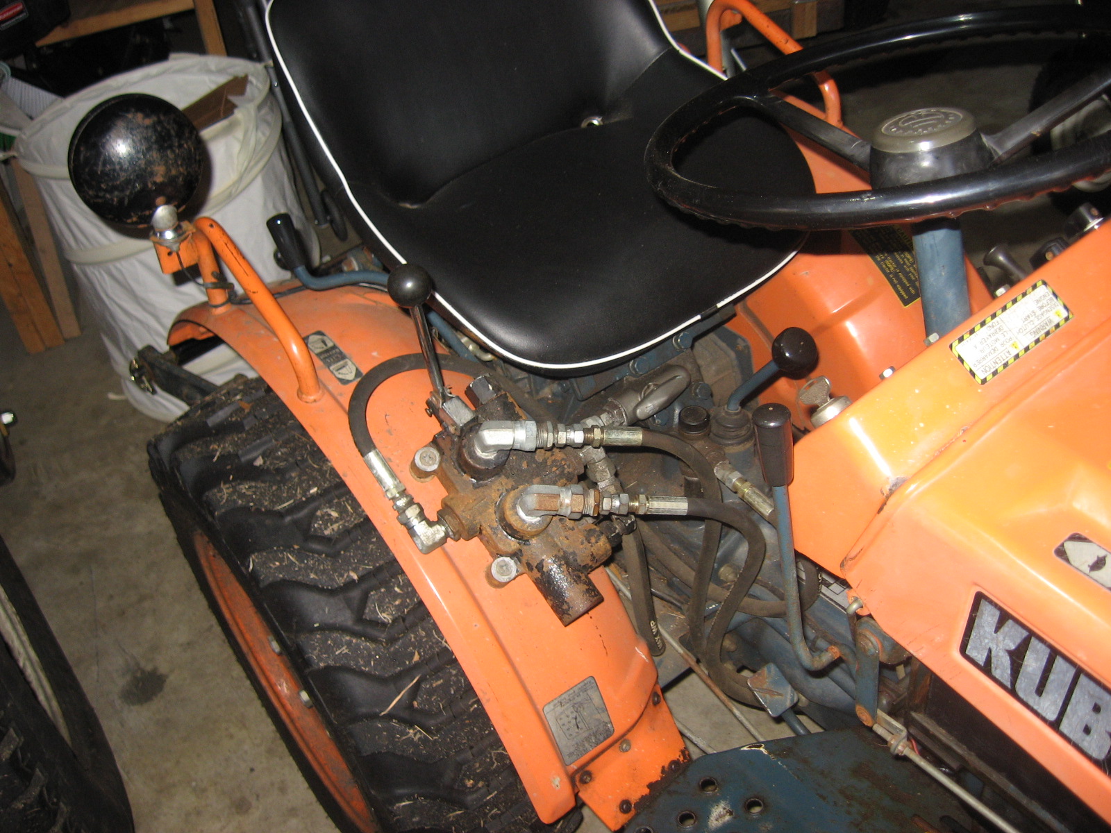

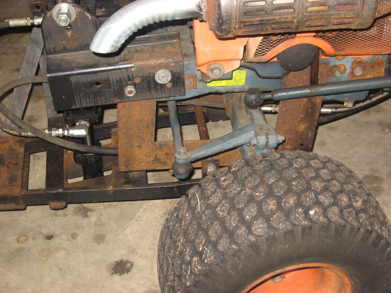

I did this fabrication a few years ago, 7=8 maybe, anyway I had picked up a garden tractor snow plow setup from a yard sale and decided to mount it to my B5100E, I cut two side frames from 3/16 steel and used them as the mounting points on the tractor frame rails, I purchased a log splitter controller valve, a hydraulic cylinder and used what other pieces of steel I had laying around the barn to finish the rest of the mounting point, I went to my local TSC and purchased the hydraulic lines I needed and made sure I put 2 quick connect couplings in the lines so I could drop the plow in the spring and use the tractor for other purposes, The controller allows the plow to be raised or lowered , Angle is done manually as it is not that difficult to get on and off the tractor to set the angle.
