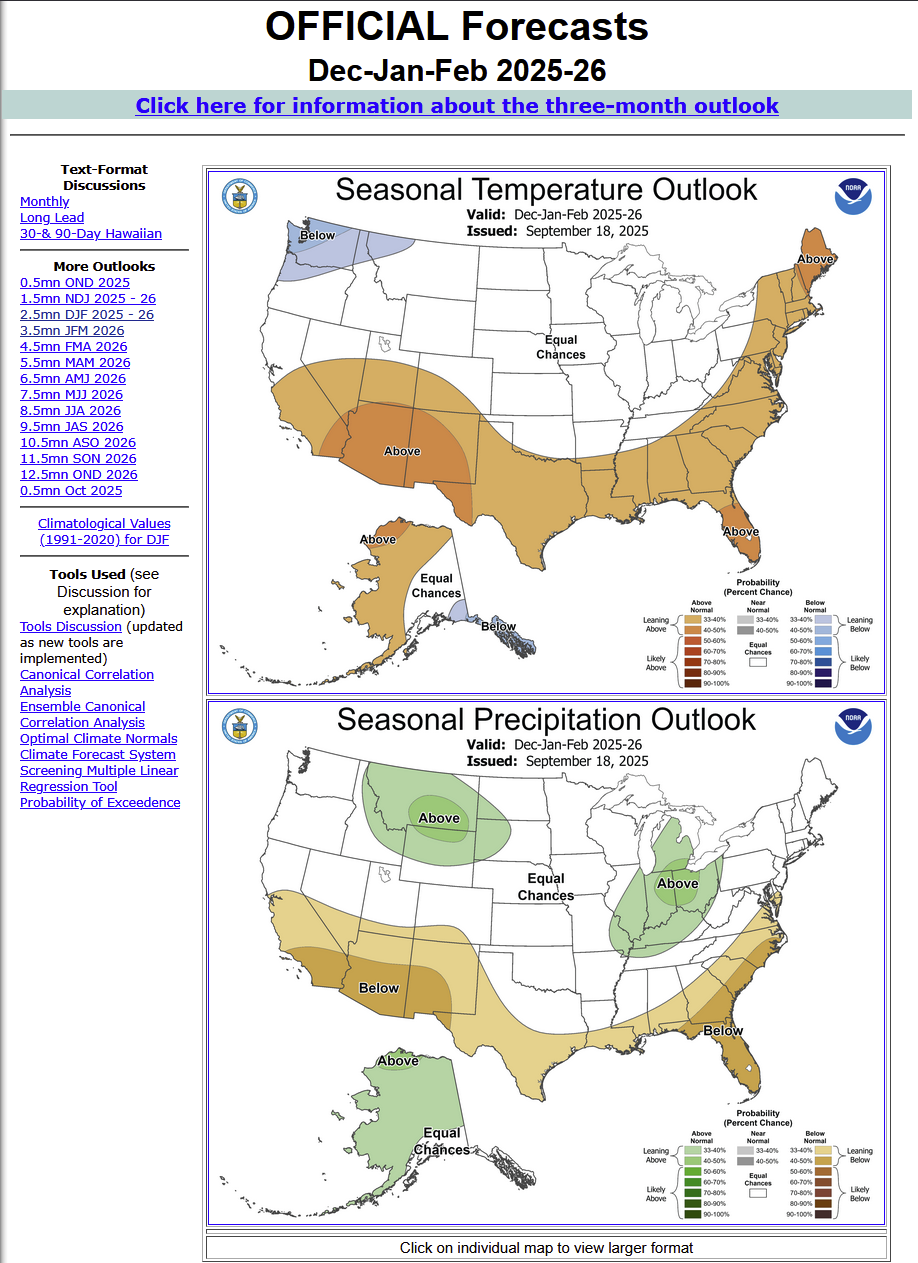

I hope you're not relying on the (Old)Farmer's Almanac?
This is from the NWS-
