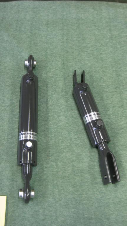

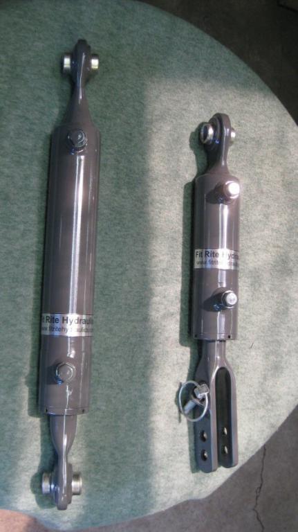

As mentioned, completely different.
1st pic is for a B series.
2nd pic is for std size L series such as the L2501 that was mentioned, up to an L3901.
Different top link strokes, different ends on both the top & side links.
