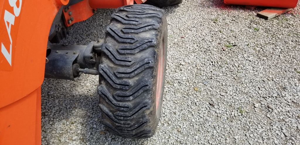

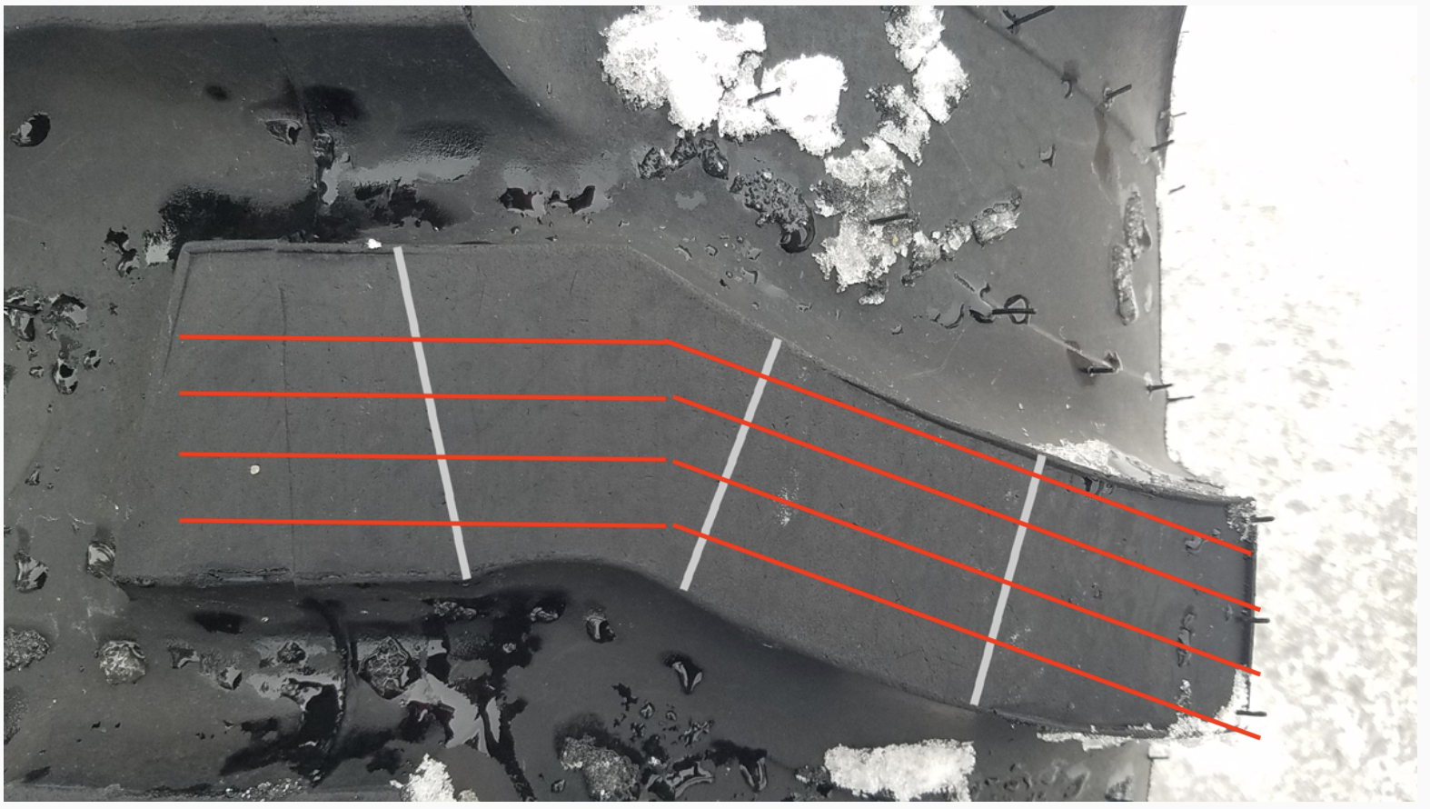

Anyway, I was thinking about how I'd add siping to each lug and ultimately what I was trying to achieve. It makes sense to me that the more blocks on the lug the better the traction since each block is able to move independently and conform to whatever is below it. The deeper the cut the more each block can move and deform. Of course, the more blocks and the deeper the sipe the greater the chance of ripping a block off or doing some sort of damage to the tire. So to that end, there's a compromise between traction and durability.

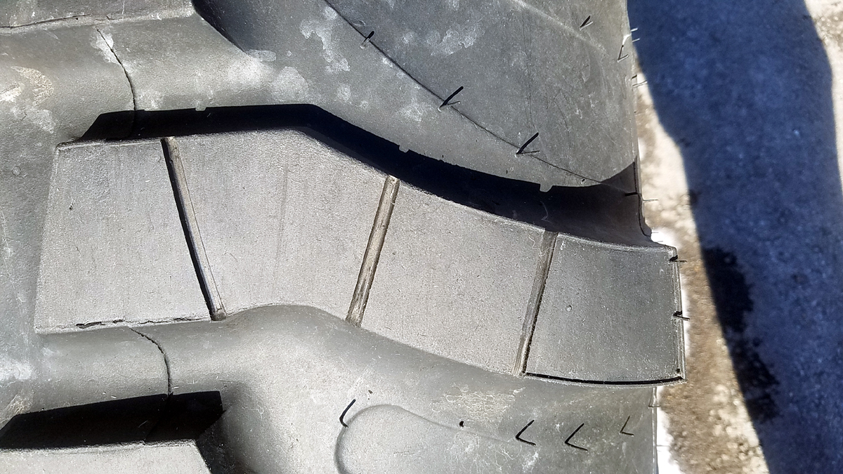

I decided to make three cuts on a lug to make four blocks. It's been very cold here, but with the tire in the sun it was nice and warm. Cutting is incredibly easy and my first attempt leaves me thinking that I want to cut a little deeper, but overall I think this will help with traction. I'm not having any significant issues with traction, but this could help.

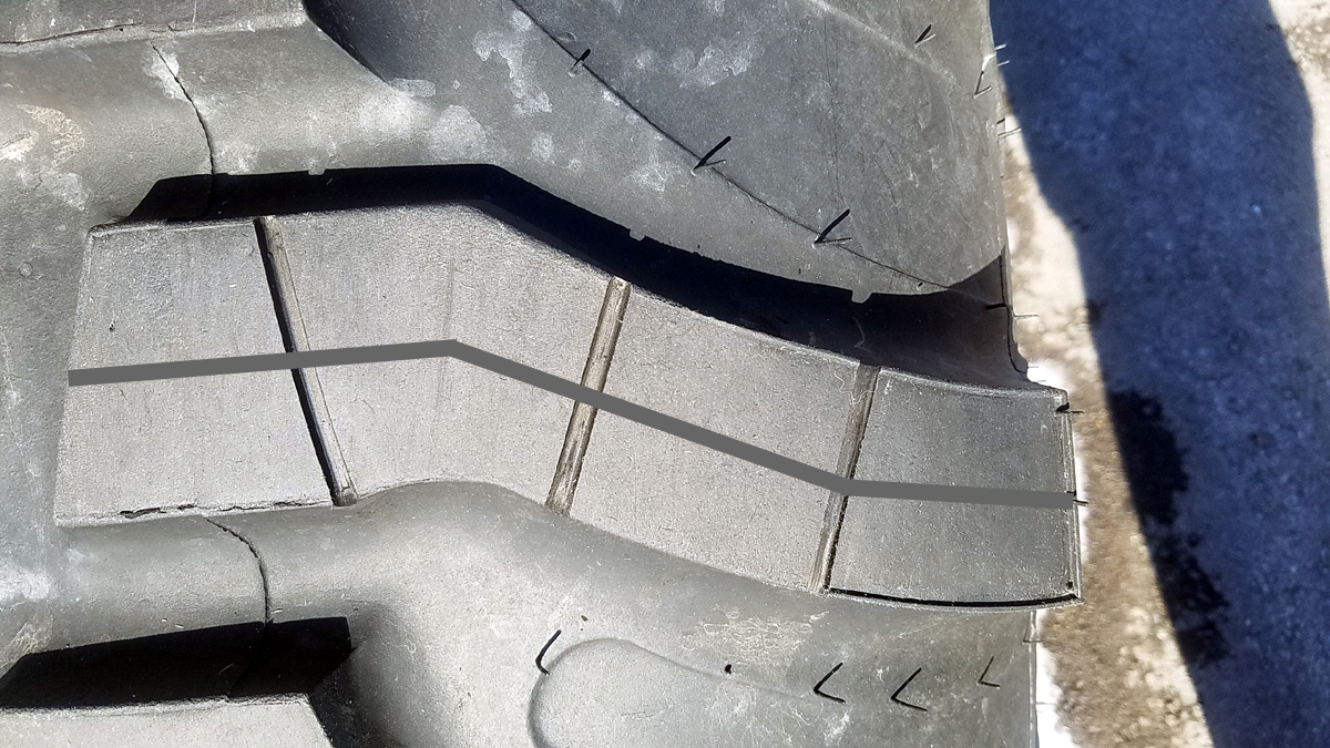

Here's the idea.

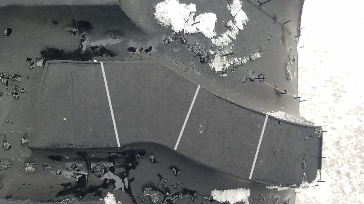

Here's the first attempt.

Curious why you cut in the direction that you did? I've only ever seen siping done in the same direction as the factory treads? Are tractors different in this area? Not challenging you, simply curious.

Those are some clean / straight lines…freehand or some sort of fence?
In automotive applications sipes generally go across the tread…it creates more grip edges / friction that way.
Nice job on the image that you posted. I think that siping on car or truck tires is different to what I'm trying to do. I'm simply trying to create blocks to allow more independent movement of the lug.
Just freehand and it's very easy to do. The rubber compound in our tractor tires isn't the same as car or truck tires. If I could take durometer readings I would, but intuitively I don't expect the rubber on our tractor tires to react the same way as the rubber in car or truck tires. Based on the four sets of tires I have for the Jeep and Ford, and the tires on the MX and M, the tractor rubber feels a lot harder.

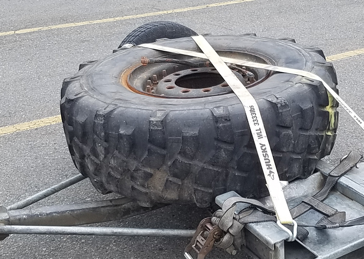

I might be completely wrong about this, but I don't see horizontal siping as being particularly effective for what I need. Ultimately it's all seat of the pants stuff since I doubt anyone has done any serious before and after testing. As I mentioned, I'm not having any real traction issues, but sometimes I get the wheels spinning on the steepest part of the asphalt when it's slick. I'm sort of copying the tread pattern on the LMTV tires to be honest.

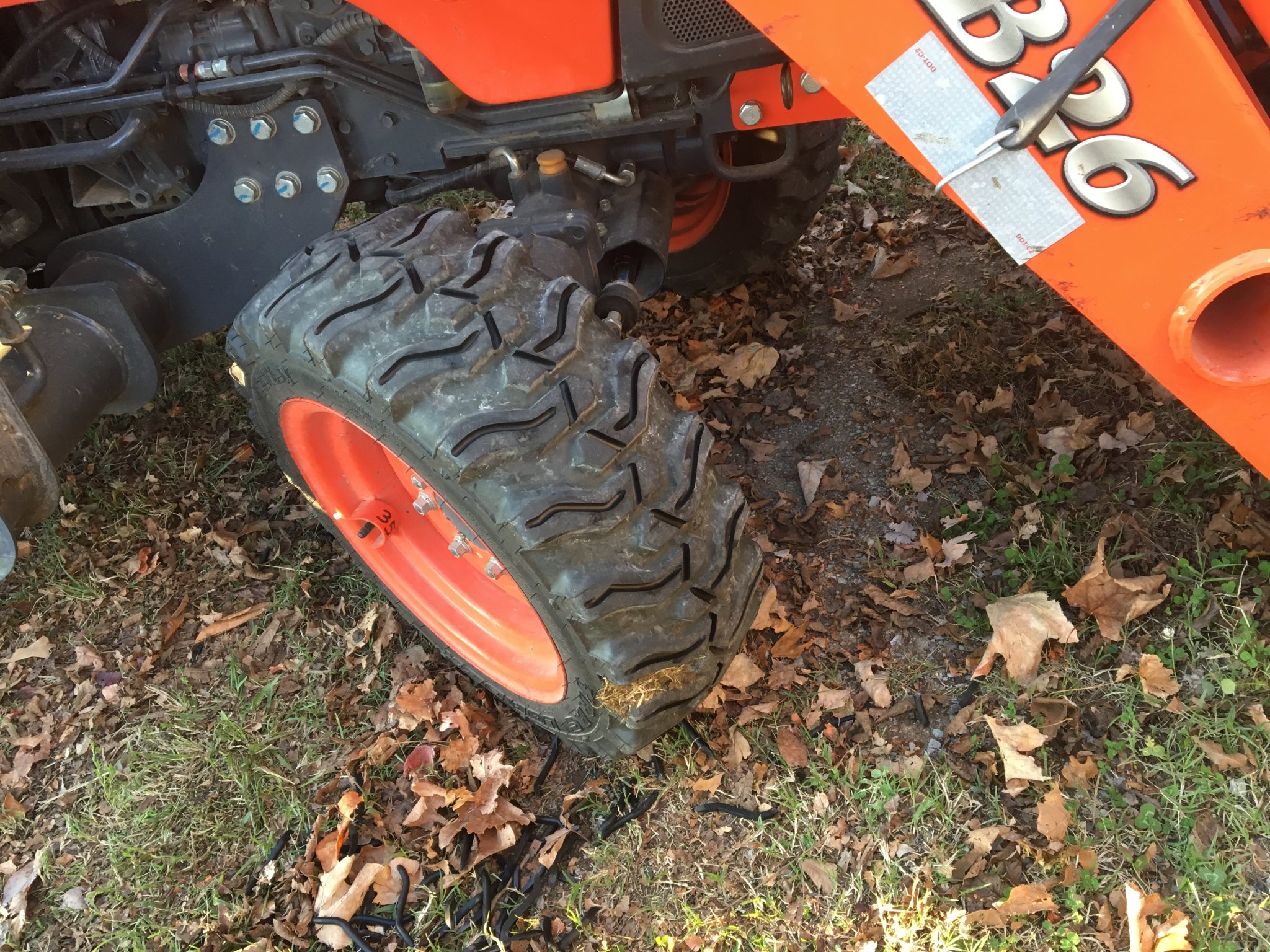

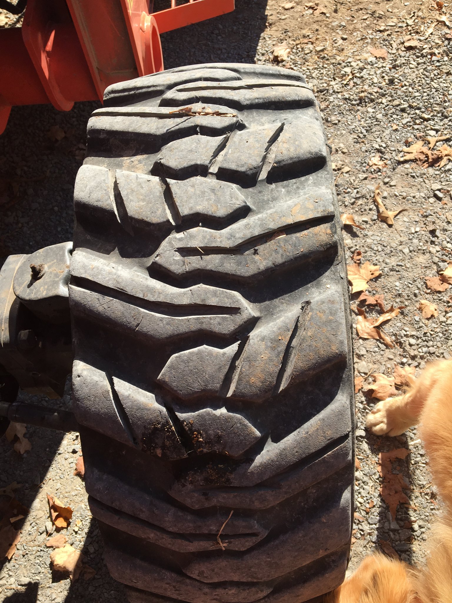

Looks like grooves instead of sipes?
B26 front for mowing. My lawn is so rough in some spots 4x4 with diff lock
M59 worn R4. Improved traction in mud and pasture side slip.
DIY heavy duty R14.
DIY heavy duty R14.
I'm not sure what the technical definition of a sipe is but I'm going for the LMTV block finish! :LOL: This is the tire used by the US military in all sorts of conditions.

I'll give this some thought. I'll finish blocking the lugs the way I show above and then possibly make a cross cut as you suggest. Something like this perhaps.
