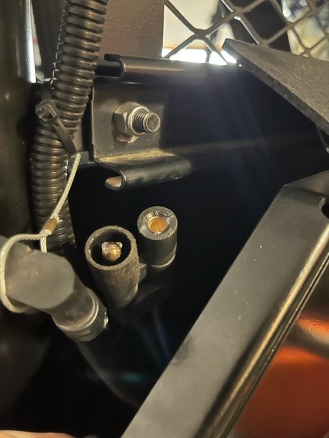

A few years back I purchased my Sidekick I asked the dealer to hardwire a plug from the battery to the bed so I could plug in things like sprayers and fertilizer spreaders. Well they hardwired a connection from a Boss snowplow and said to get an adapter to scale it down from what it is to what you need. Now I can’t find an adapter and neither can the dealership. Anyone have an idea what I can use ?

I'd suggest replacing that with a standard SAE quick connector. A good example is the battery connector you get for a Battery Tender charger. Amazon has a zillion SAE quick connector options. Plus you can use it to keep your battery charged.

Small sprayers and fertilizer spreaders don’t pull much power. They could easily work off the SAE connectors (battery tender connection). It would be easy to put a switch in line and run it to the cab through the back window
