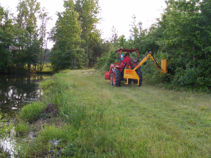

Here is my Ford 515 behind my B7100. It works well for road sides, especially embankments, or trimming along water. A boom type flail mower would be better, but who can afford that. I caught this mower at a farm auction for $90. But like others have said, usually they run $300 to $600. It only has a 6 ft bar vs 7 or 9, but I only wanted a short bar. A longer bar would try to pull the front of a light tractor like the B7100 around.
