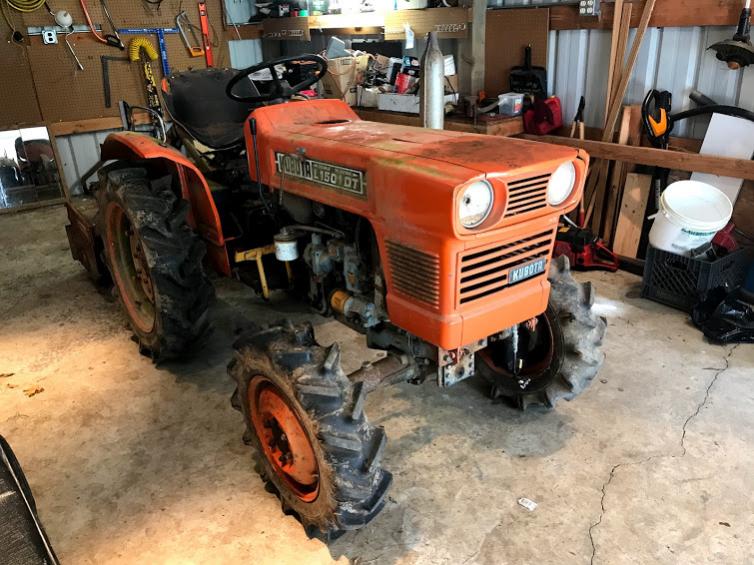

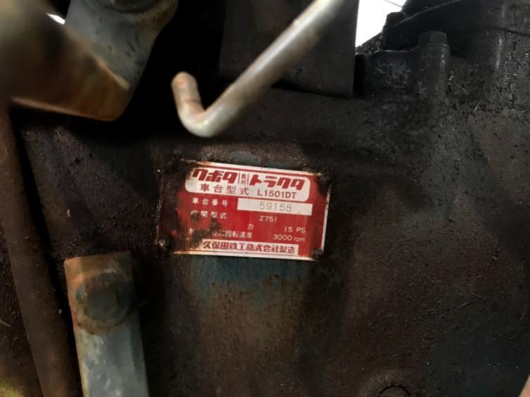

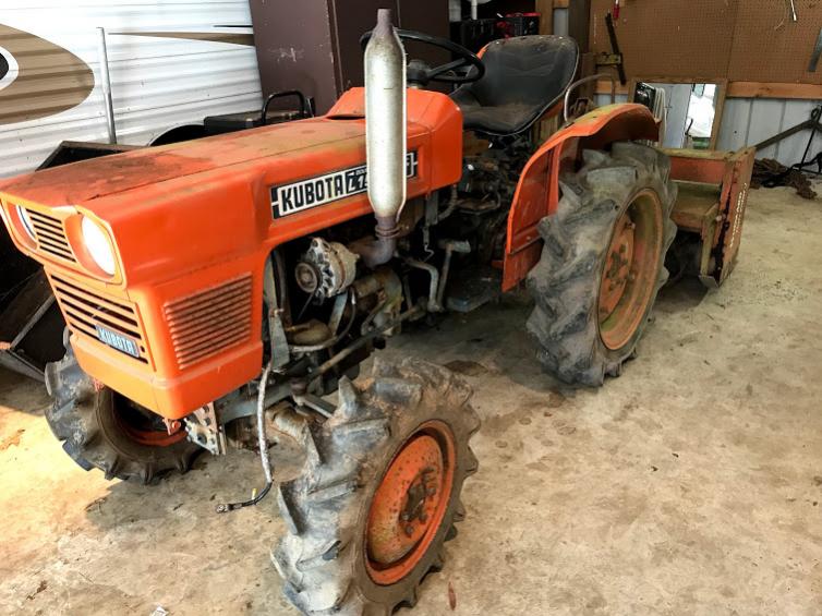

I have some pictures I’d like to post as well but don’t think I have permission as this is my first post, also I don’t know if I can post them directly or need to use Dropbox or something.
Welcome to OTT :)
I sent you a PM with a link to the Shop Manual, Operators Manual, Parts Manual and Periodic Maintenance Chart.
You can (after 5 posts I think) post pics directly here and it is advised,
sometimes photo sharing site links go dead.
Here are the pics you could not post..... :D

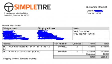

I went with these from simpletire.com while albeit they are rice paddy tires, they are a match set to the originals and since I restored my tractor I decided to go this route.
The Originals were so hard, I have not had a chance to put these on yet they are mounted on the wheels, but with the softer rubber I'm sure the ride will be better than with the old rock hard ones.

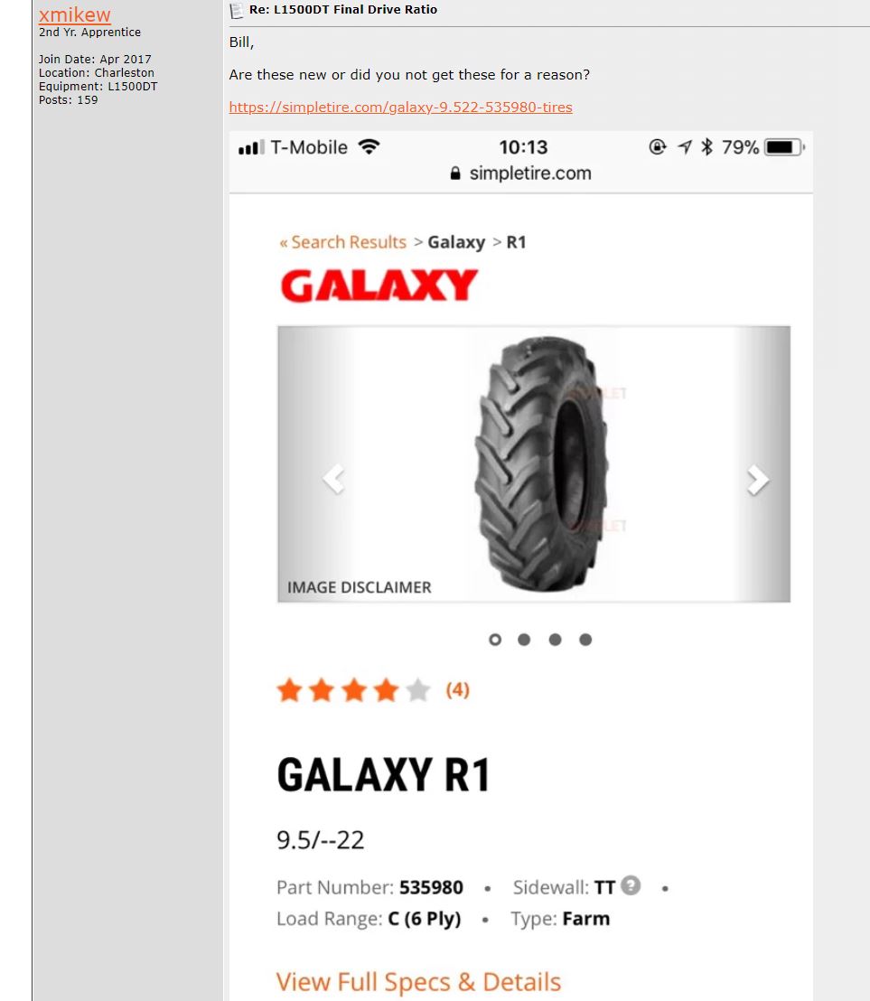

I was asked why I did not get these;
My reason was having to find a matching front due to the 4WD,
and I wanted to stay true to original.
But R1s are out there for the 22" rims, not sure about AGs
