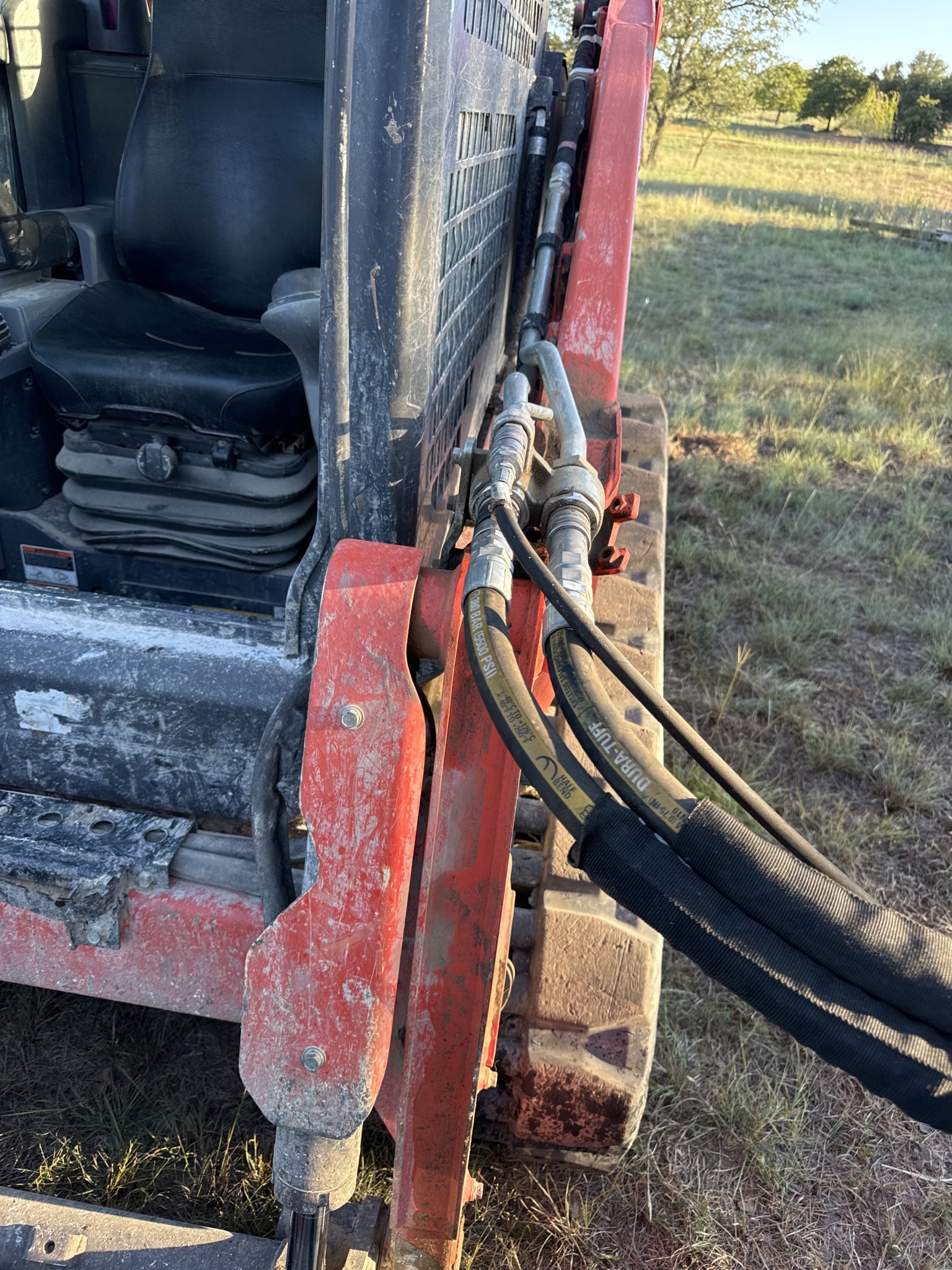

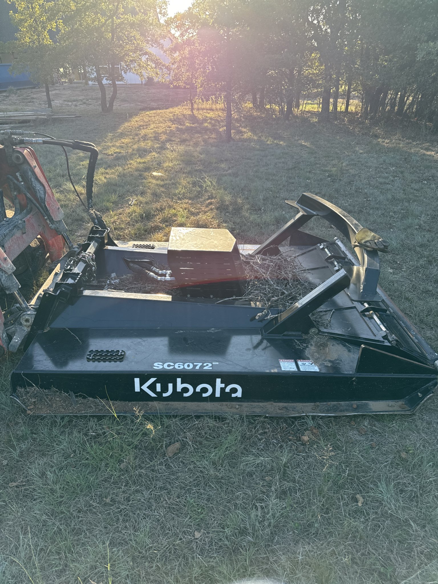

The blades are spinning counter clockwise and the manual says they are only to spin one direction, clockwise. Any suggestions on how to fix this? I’m running it on my svl75-3 standard flow skid steer. I already swapped hydraulic hoses around and no luck.

looks like an EATON 2000 series motor, so can go CW or CCW.
If so... when Port B is pressurized, it goes CCW.
perhaps remove the safety covers and see HOW it's plumbed
if you do, please post a picture cause gee, swapping hoses SHOULD have changed direction....
