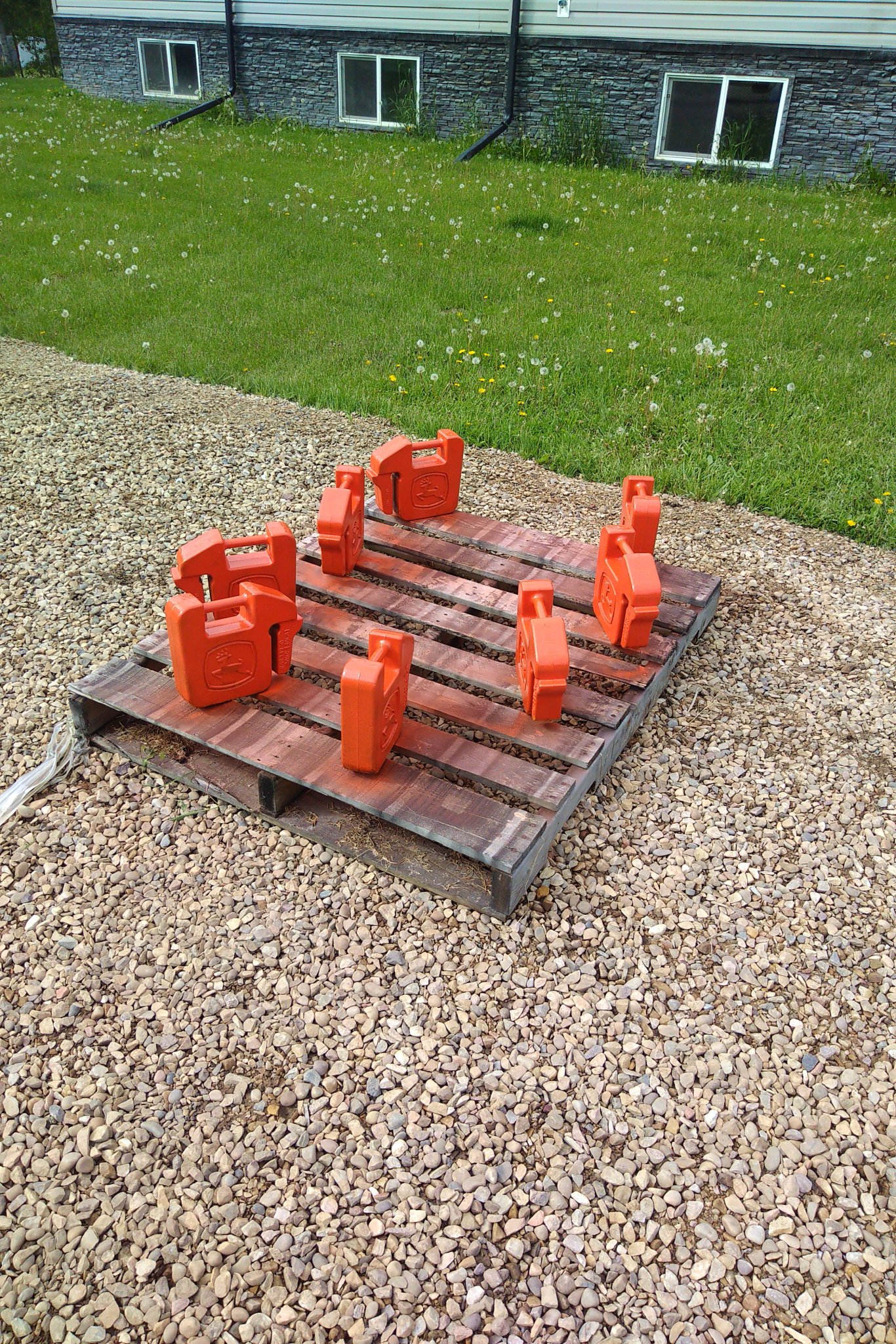

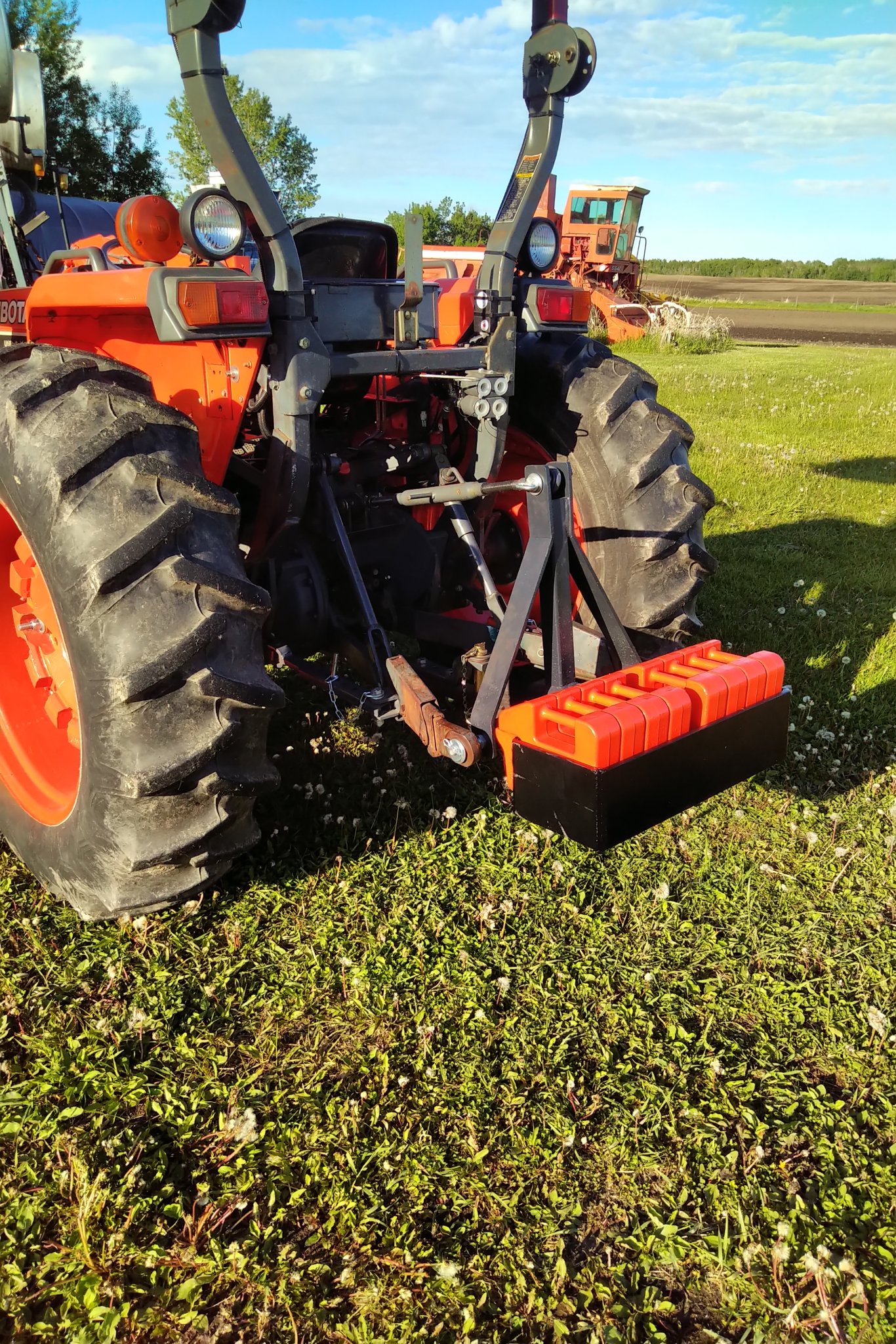

I use one of these, they used to be around $100, I think. I put 8x 40 pound suitcase weights on it, so 320 pounds, plus the ballasted tires (60 pounds?). The weights aren't cheap but they are useul. When not in use on the back, I hang them on the front of the frame when I take the loader off to brush hog or use the leaf blower, you can fit 5 on the front.
if you dont paint them Kubota Gray they dont work as good.
Or orange. That 320# plus another 80#s between the weight box and the 3pt adapter makes a big difference in stability when doing loader work. I like how it is a compact weight down low, in the center of the tractor as opposed to a blade, box or mower hanging back there.
