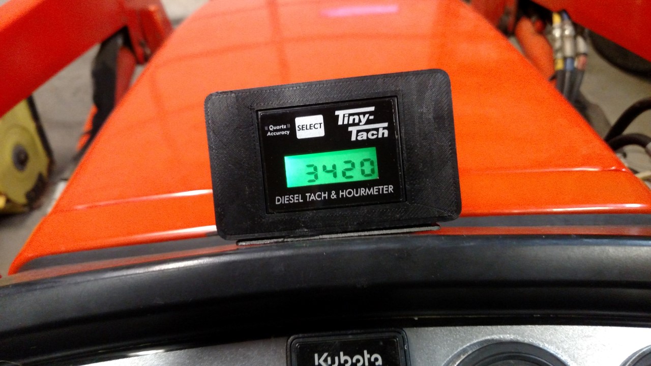

I have a Tiny Tach installed on my BX and another on my Yanmar genset, and no it doesn't have an internal battery, it runs off 12 volts. The unit has three wires, 12V power, negative or ground and a lead that goes to the pickup that clamps on the injector line which also has a ground lug.
I 3D printed and enclosure for the one on my BX and attached it to the top of the dash.
While they aren't cheap at about $100, they work very well.
