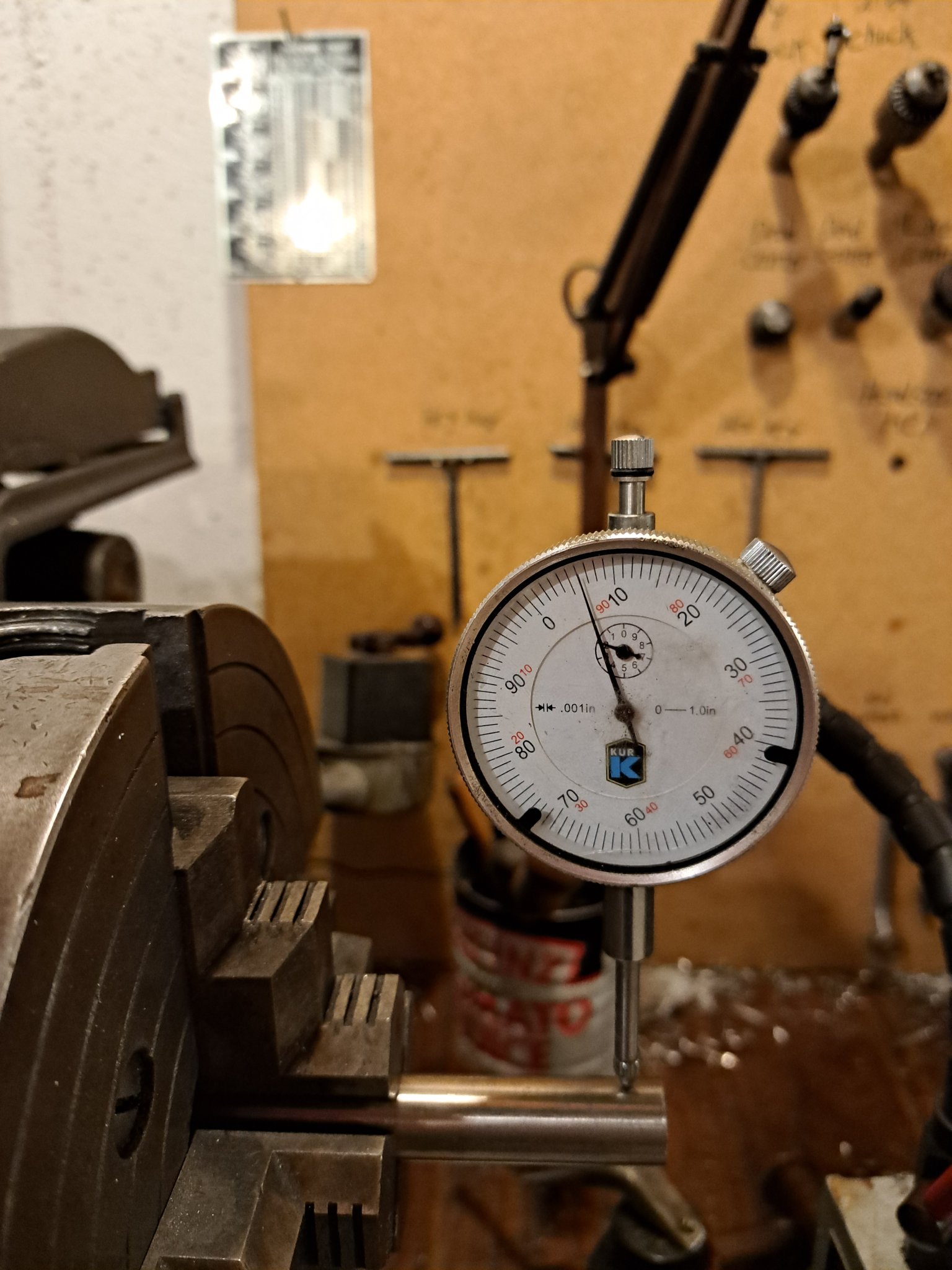

I eventually indexed it to within .003 but forgot to take a pic. I think that's good enough.

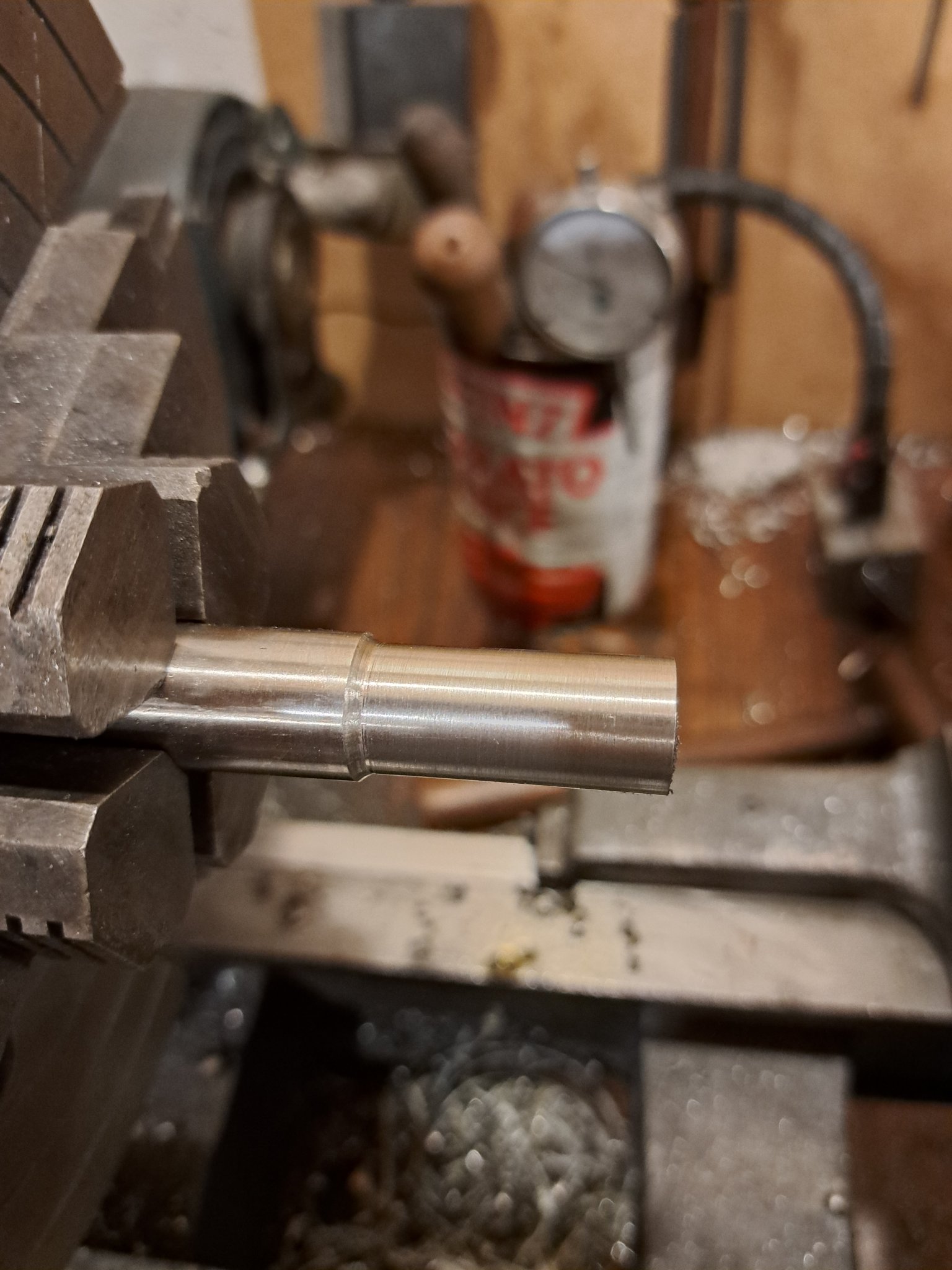

Then the WTF moment hit me.....I bought 5/8 round stock, so I only needed to take off about .025"
AHHHHHH....... Son of a B!tch!!!!!
Well now I've really stepped in it.
I only had enough stock for 2 pieces, assuming no mistakes.
Well now I suppose it's time to make some Lemon aide with these Lemons.
I decide to now "practice a bit" and see what settings work the best.
The first pic looks like Hammered Dog Sh!T, so a few more test passes gets me into the ball park.
1,807
1,904
The finish still looks like crap, but it's the best I can do with my limited skillset and knowledge.
At least I picked up a few ideas on how to make it appear that I know what I am doing. Hahahaha
Break out the emery cloth, and the 5th grade math skills.
Lets see if I remember how to do division "old school"
Back to the lathe dumbass.
And now use the machine like you should.
I decide to go for it in one pass, so I set it up, and get the Mystery Oil out.
I also added a "Scosh" to allow for tool flexing.

Almost perfect!!!!!! (OK not perfect, but not too bad, gotta take another small pass)
Now to make myself look good, some emery cloth and some OSHA approved lathe work with the file.
Then rinse and repeat, and I have a somewhat shorter version of my original idea.

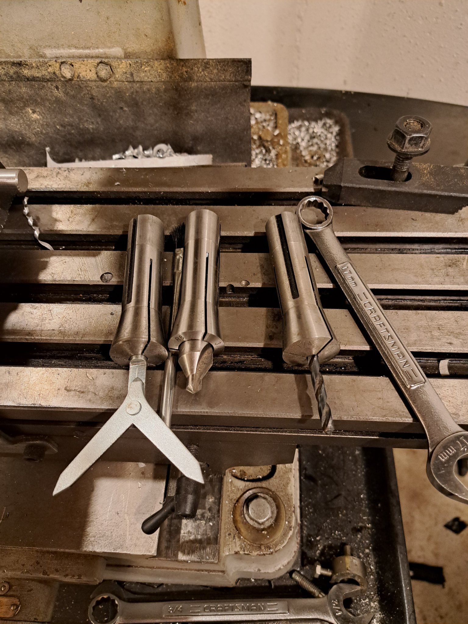

Now I gotta drill a hole for the handle to go through.
Off to the mill.
After about 30 minutes of searching I finally find my "round stock centering tool" (I have no idea what it's actually called.)
Then I set up the collets to try and drill a straight hole through round stock.
I originally was going to grind a flat spot to get the drill started, but where's the fun in that.

3 problems I see.
1. Try a tool bit with a 0.030" radius on the tip. Your ⅛" radius bit thins the chip and helps create chatter.
2. Use a 3 jaw chuck.
3. Place a cloth across the bedways when using aluminum oxide cloth for polishing.
304 is fine for general purpose use. 316 is preferred for product contact use as long as you passivate it.
Your centering device is called a fishtail. I prefer to use an edge finder.

Thanks for the tips.
Why a 3 jaw? I thought that a 4 jaw was the preferred chuck to use?
Paul
mcfarmall
Kubota M5660SUHD, Farmall C
Sep 11, 2013
1,382
1,649
Kalamazoo, MI
Paul
4 jaw is typically used for irregular workpieces like square stock or something you intentionally want offset such as a cam. I have a 3 jaw that is adjustable. Basically a 3 jaw chuck on an adjustable backing plate.
1,807
1,904
Gotcha...I always thought it was for "more accurate" work.

If your 3 jaw has too much runout, then the 4 jaw is fine. As you found out, adjusting a 4 jaw takes some patience.
The adjustable 3 jaws are nice. I got mine down to less than 0.0005" T.I.R. using a dowel pin to touch off.
