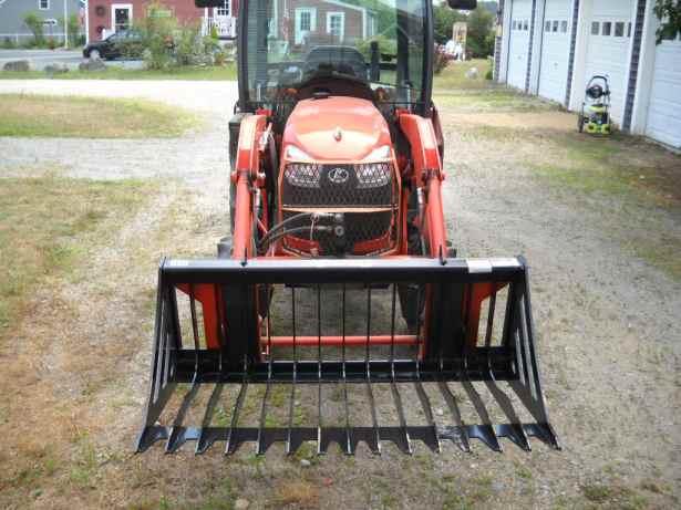

Rock bucket arrived at the FedEx terminal yesterday, I went and picked it up this morning. Dang fast shipping, it only went out Monday from Pennsylvania!
Quality and construction look good. Everything is square, all the welds are solid, joints are tight. Powder coat is pretty crude, but I don't expect it to last under it's intended use anyway.

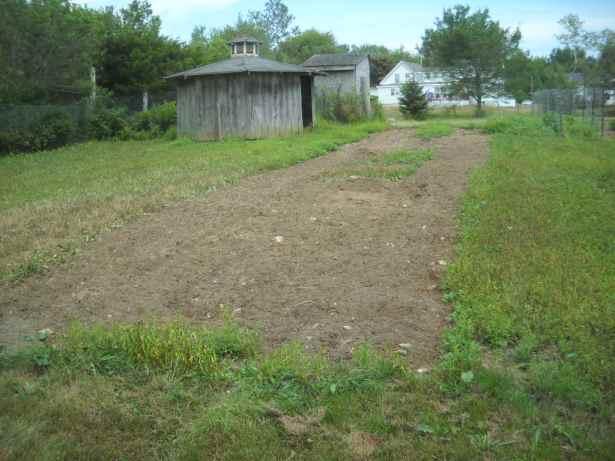

This was my first test area. It was a chicken yard up until this year. It was full of potholes from chickens digging their dust baths and when I tilled it up to level it (and work in the chicken poo) I turned up a crapload of rocks.

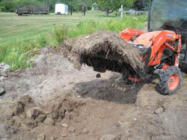

In addition to rocks, it will also pick up root masses which is okay. It does a good job of filtering out the dirt, especially as dry as it's been lately. If the soil was wet, I could see where there might be issues. Verdict: It's not the "magic bullet" I was hoping for, but it surely beats picking them by hand.

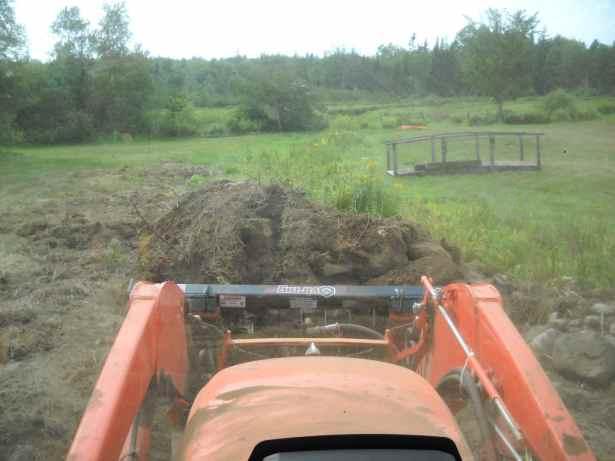

I actually bought it for cleaning up an area next to a drainage ditch so I can mow it. I knocked the top off it with the dozer blade on a borrowed excavator and, once again, turned up a treasure trove of rocks. Also a lot of woody root masses from what we call "hardtack brush". Again, it did a pretty good job of sifting out the dirt.
I'm pleased with how much it will pick up. Never had any indication that the hydraulics were straining.

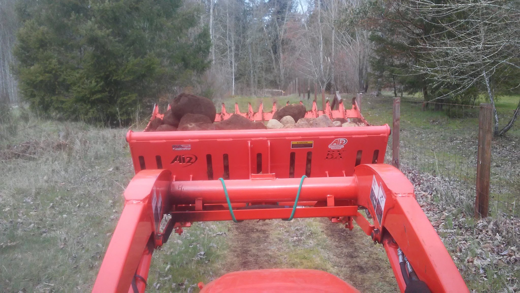

I have a rock bucket similar to yours. I bought mine a few years ago from here. https://bxattachments.com/product/rock-bucket/
It took me awhile to learn how to use it properly. There is a certain technique to digging rocks out of the ground and shaking the dirt off so you are only hauling away the rocks and not the soil. Once I learned the technique that worked for me I was able to haul full loads without any trouble. Here is a picture of one of the loads I dug up recently when I was expanding my wife's garden.

She sure does grow some nice rocks!

What I do is tilt the bucket to about a 60 - 75 degree angle and lower the bucket until the front tires are off the ground. Then I tilt the bucket back and forth to get the bucket teeth digging into the ground. After I get the bucket dug in a few inches I tilt the bucket to pry the rocks out of the ground. I do this until I have pried enough rocks out of the ground to make more than a full bucket load of rocks. Then I back drag the rocks into a pile that I can get the bucket under. I approach the pile with the tractor in low range with the engine at about 2000 RPM. I make sure that the bucket is at about a 15 degree angle and scoop the rocks into the bucket as I am driving slowly into the pile. This has worked well for me as long as the rocks are the size that you can see in the picture I attached previously. If I am working with much larger rocks I use the regular bucket with the piranha bar to dig and pry them out, and then switch to the rock bucket to scoop them up and transport. What method do you use?
