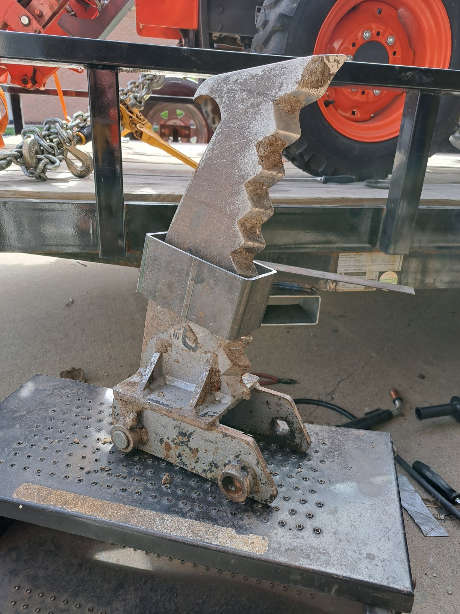

As I was admiring my fork storage install, it hits me....Hey dummy, Why don't you make a cool ripper tooth pocket for the trailer????
To the plasma cutter Batman!!!!!

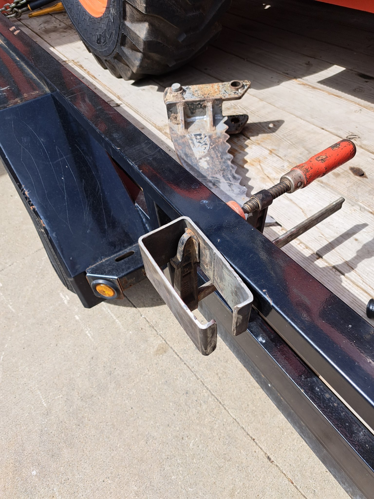

The first pic is the original idea. (upside down). you can see that it sits a little proud of the top, and although I'm reasonable confident that it would not bounce out, it looked bad.
Then I get the idea to make a "relief" cut with the plasma cutter so it sits deeper.
(BTW freehanding with a plasma cutter in shorts and tennis shoes is NOT OSHA approved and a little painful..:unsure:)
second pic shows proof of concept...back to the plasma cutter to open her up all the way.
I also decide to use the starboard side of the trailer in order to "balance out" the trailer set up.

Not pictured, but using the plasma cutter heated the part up and when I finished the cut, the heat differential immediately made the part close up like a clam.
So a little persuasion with the BFH, and she opened back up nicely.
Then a little grinding to smooth it out.
Second pic is the test fit.

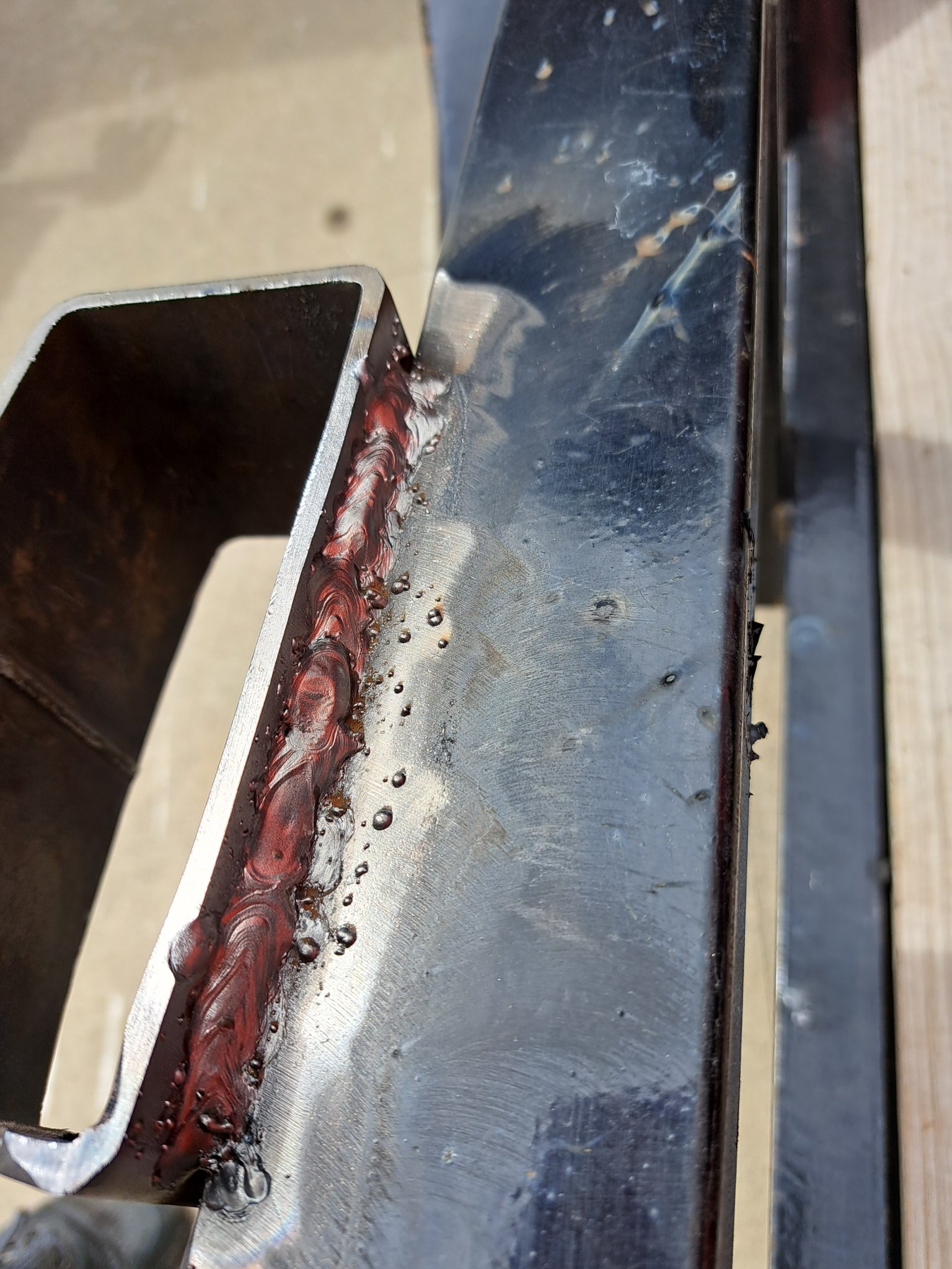

The welding was a bit problematic. I totally forgot to check the thickness of the rail tube.
Turns out that that tube was considerably thinner than the frame C-channel.
So as I was running the bead, something seemed off....I just couldn't put my finger on it.....Hmmm?????
Ahhh yes dumbass....its the holes you are blowing in the fu^^ing tube!!!!
I was able to go back and "spot weld" those areas, but it made the weld look like crap.
Oh well, a little paint should cover it up.

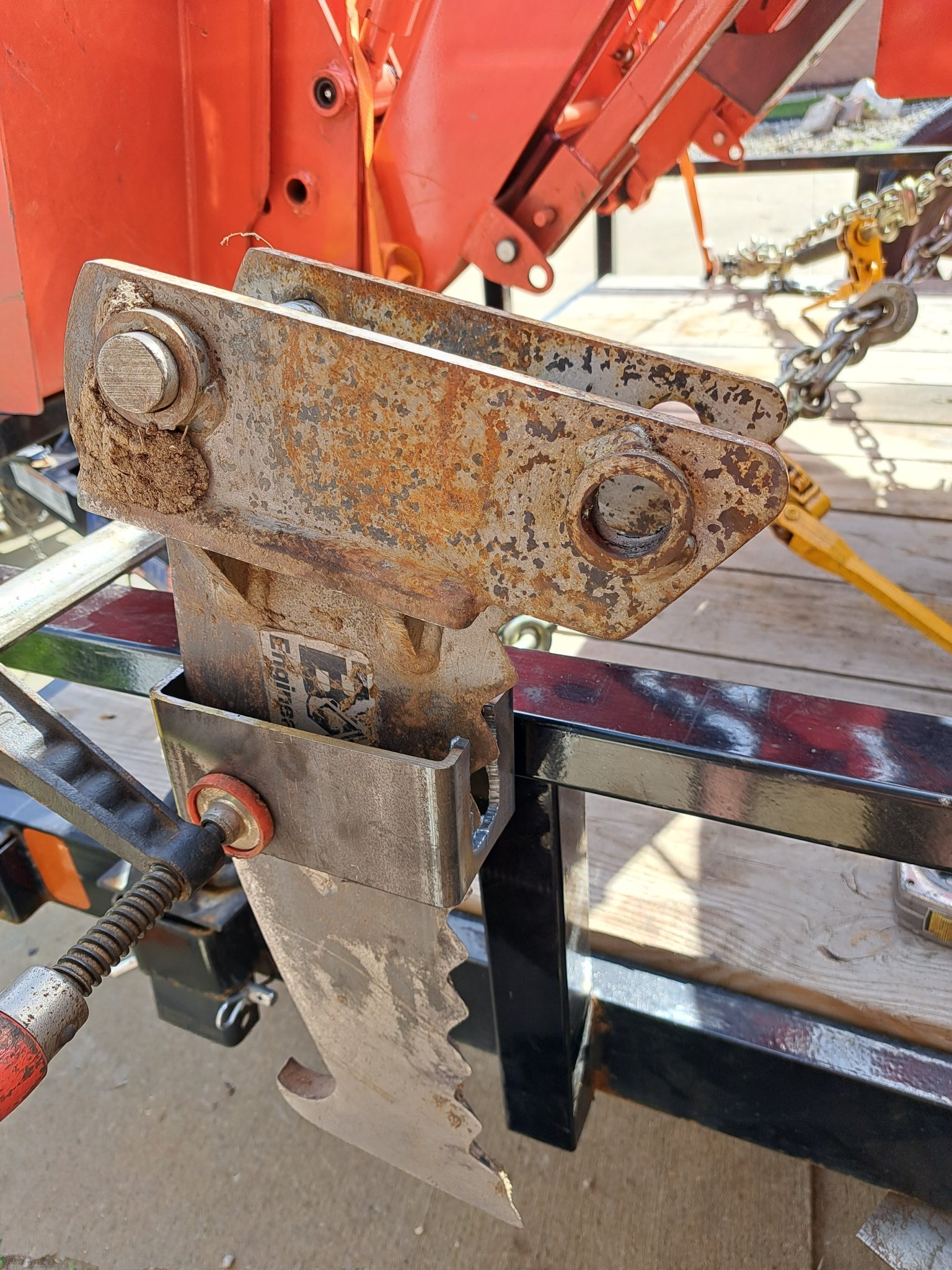

Now she sits nice and flush, and as a luck would have it, the little nubs act as arms to block it from moving too far forward when braking.
3,281
4,135
Here she is in all her glory, all painted up and ready to go.

Those gussets are going to spread the open end of the tube apart when going down a rough road. Possibly causing the tooth to wedge itself in. Need a ‘U’ shaped strap on the open end to keep that from happening.
Looking at the spatter from your welds the voltage is set too high. Turn it down until it sounds like bacon frying and then use a weaving pattern for your fillet. You obviously have the eyes to be a very good welder! I could have you squared away in an hour with a lesson. If only we were closer.
Thanks for the compliment.
I had not thought of the spreading problem. I will monitor it.
I sure wish I had taken a close up picture of the angled welds.....You would have been proud..LOL
Could the wind have been a factor causing the spatter? I ask this because I don't remember changing the settings for the machine, but they turned out great. Very little spatter and very even spacing. It almost looked like a machine did it.
I usually try to use a 'cursive e' pattern in most situations except when doing a cover pass, then I try to weave it, like you say.
