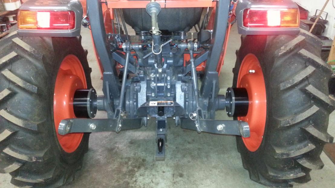

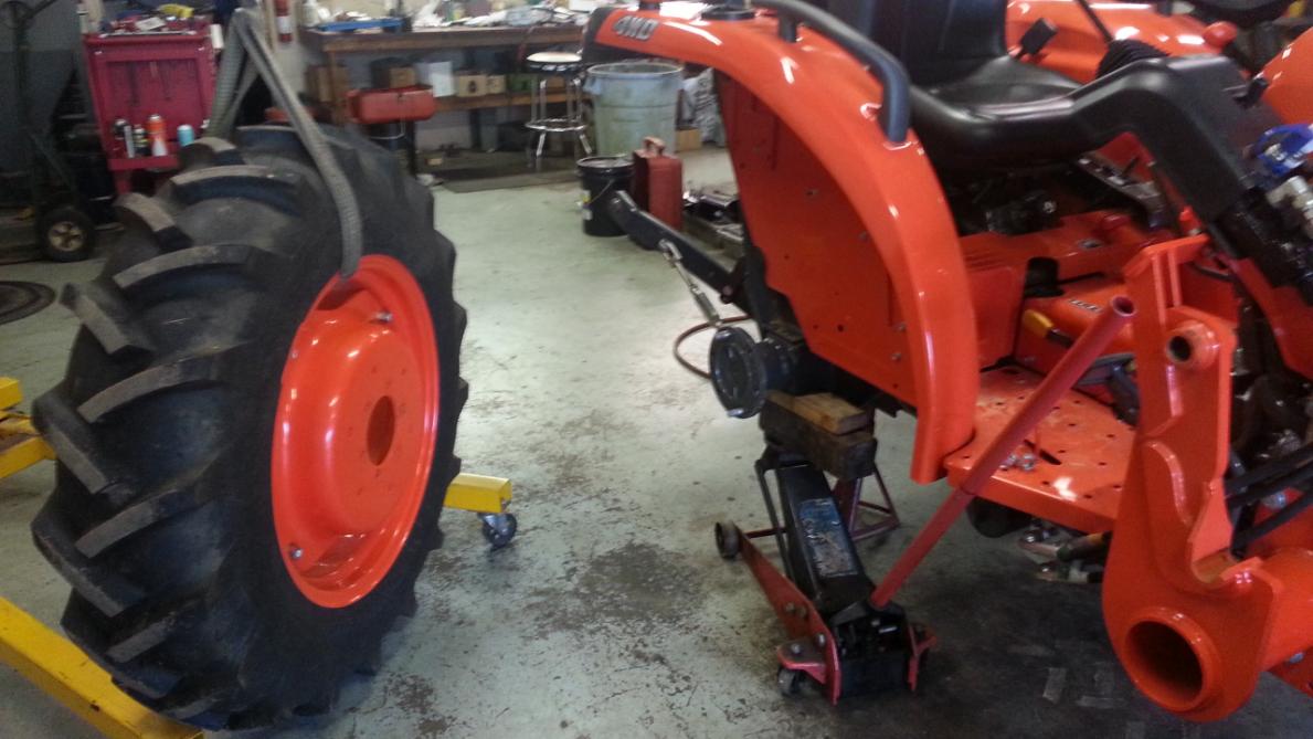

Installed 3 1/2" BORA spacers on my L3901 tonight. Not to bad a job just took a little time but worth it. Should help raise my pucker factor mowing on these hills. Widened it to 70" outside rears. Feels much better now.I don't understand why Kubota doesn't make them where they could be set this wide considering how much more stable they are. I've got two Mitsubishi's and both of them will go that wide without spacers.

I agree - the pucker factor is not a good feeling when loads get high!
That was the first thing I did on my BX, and it made a huge difference. I would think that Kubota would offer that in some sort of package deal, like a simple add on when buying a new tractor. Shoot, just from sanity alone, worth their weight in gold!:eek::)
Nice job on the spacers:)

Mike, surely you meant to LOWER your pucker factor!
On the flat lands of Eastern Kansas wheel width isn't much of a factor. I have to adjust the wheels of my Case IN to match the disc mower setup!!

To clarify I meant to raise how far I can go before the pucker factor kicks in so you're right I worded it wrong.
