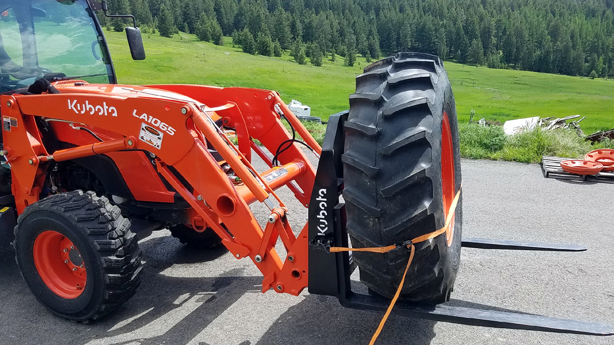

7,497
10,393
Reversing tires will get you one result, 🤔 , Laughed at! :ROFLMAO:
I inadvertently did that a couple of years ago on the M6060 when I changed the rear wheel spacing and added another set of wheel weights. I removed the first wheel, moved the center to the second widest setting, reinstalled the wheel, added three wheel weights and then realized that I'd forgotten to install the wheel on the other side of the tractor. I was happy with the end results, but even with the MX acting as a tire jack it wasn't a fun day, and my screw up didn't help things.
